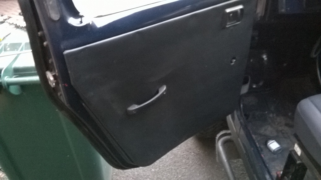

Did some stuff to P5 today, door cards on, rocker box off (will paint it blue..note another loose screw!) CB aerial is now on, a few more bits to do yet. Oh and the zombie light switch... :lol:

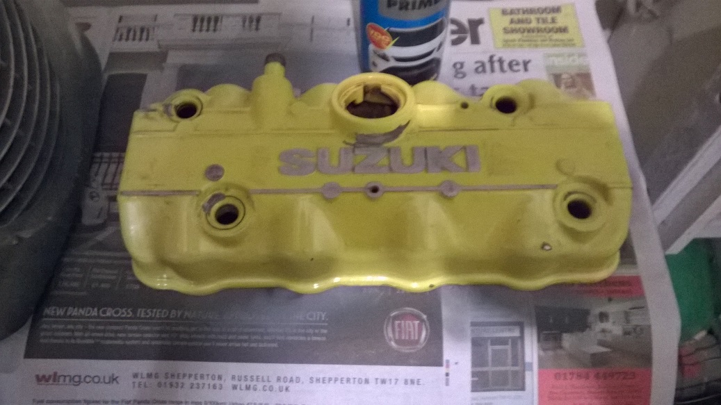

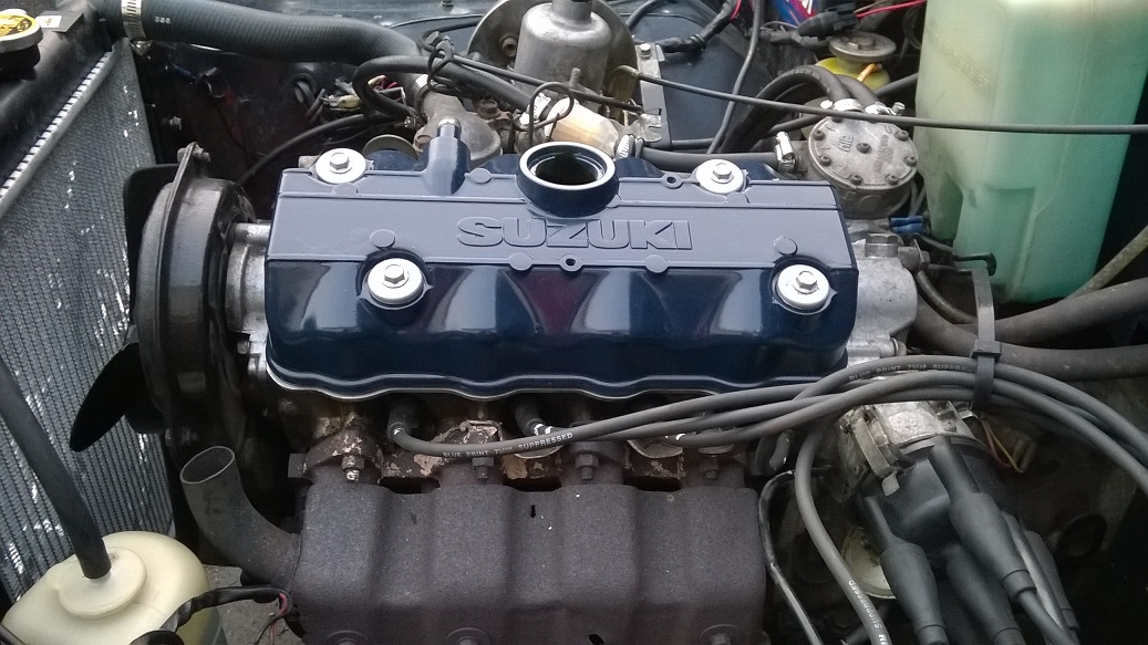

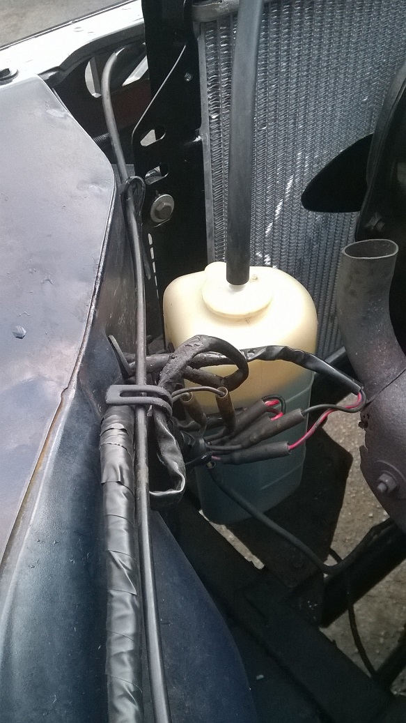

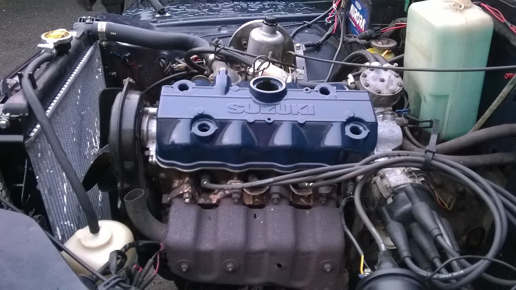

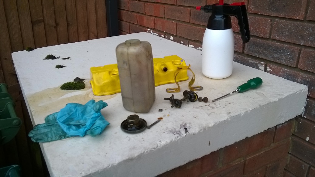

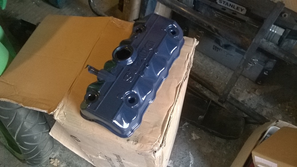

P5 bits getting done, I found a blue that almost matches the body and painted the rocker box, and a few other bits too. Useful tip for cleaning out washer bottles and the like...a couple of denture cleaning tablets and boiling water...shifts nearly all the dirt out lol. I also covered the manky blue stuff with insulation tape, matches everything else now.

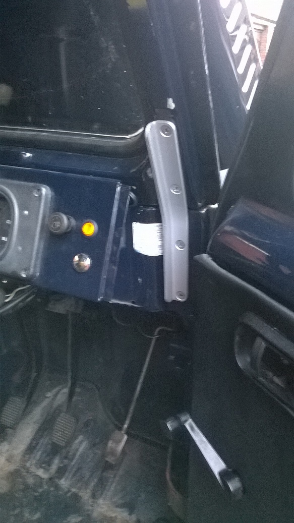

Tried moving the latches on P6 and the doors close a bit better...still not spot on as yet.

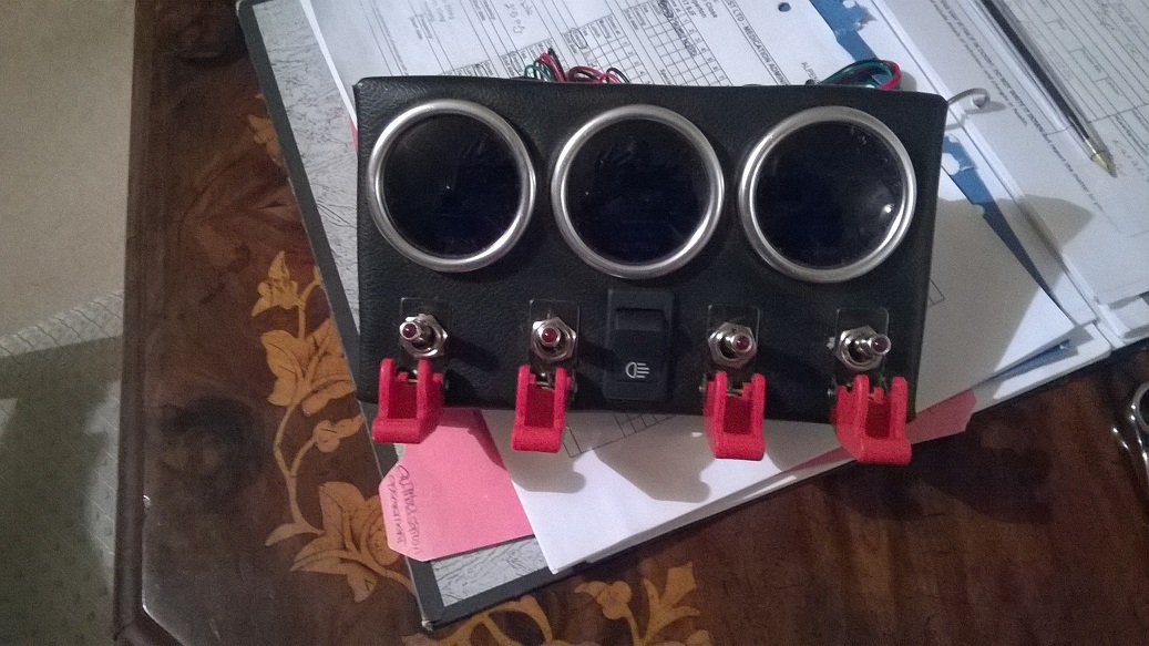

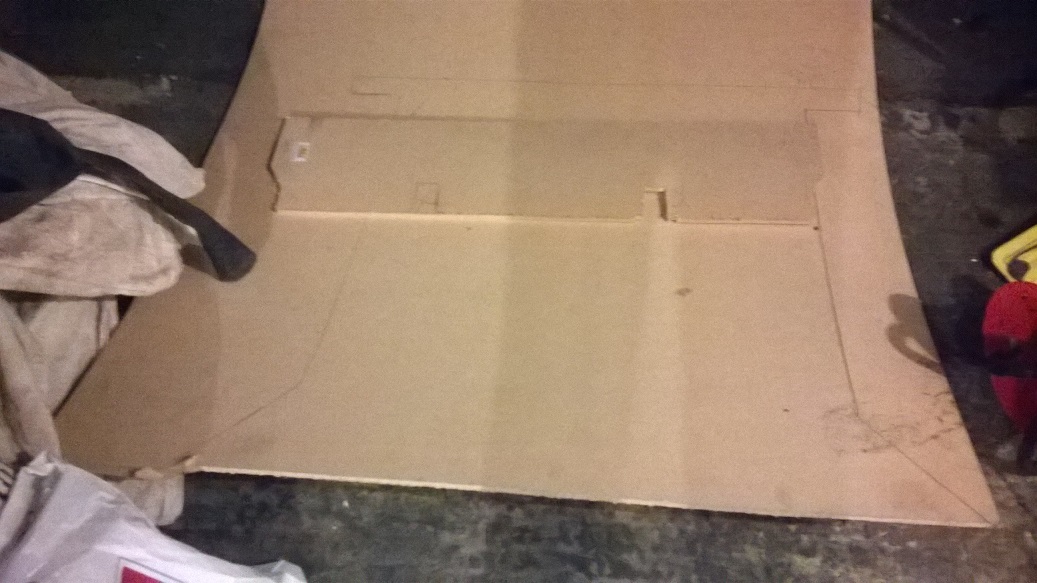

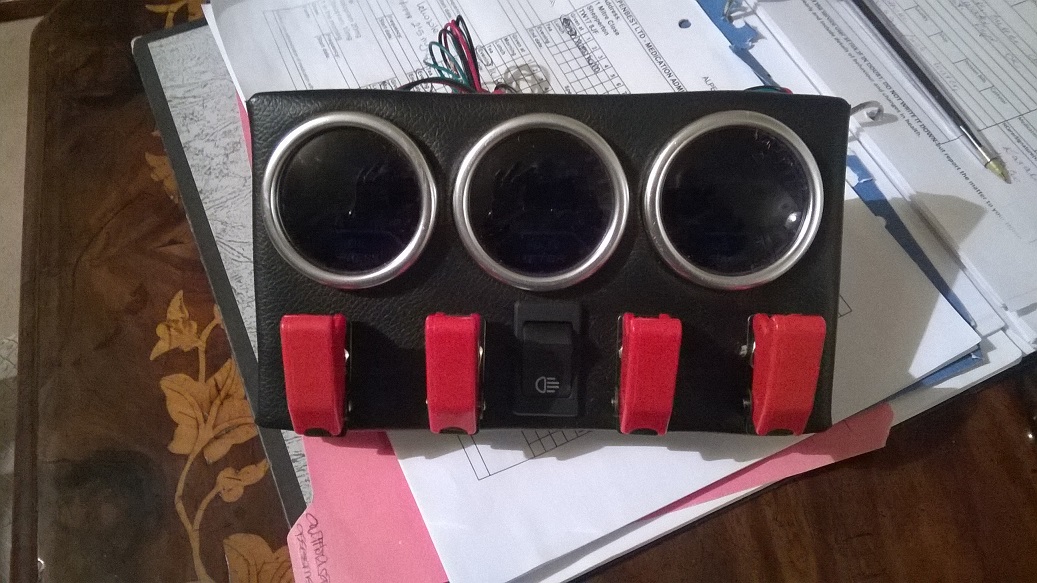

There's a custom made floor panel in the rear of P5 so I took it out and made a template so I can make another, and I finished my little binnacle with the dials in it!

Post by Martin86 » Sun Dec 14, 2014 8:54 pm
Excellent Work, Rocker Cover looks the nuts!

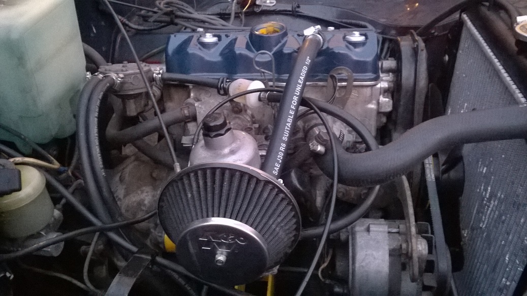

Re: the no dosh LJ revamp

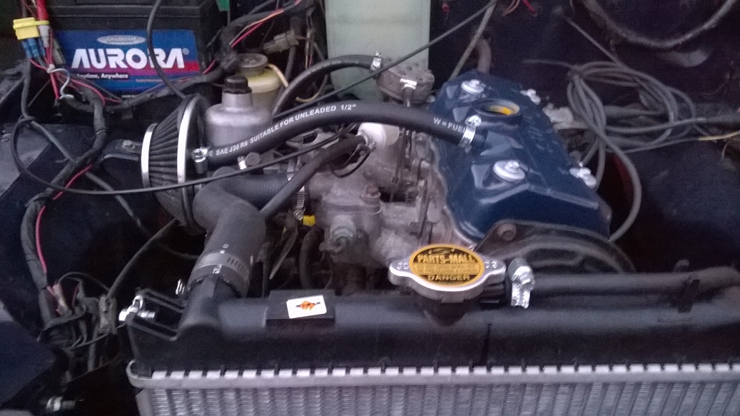

Post by donkeychomp » Mon Dec 15, 2014 8:56 pm
It's on. Had to take the air filter off to fit the hose and jubilee clip, bit of a faff but looks so much nicer now.
courior
Posts: 357
Location: Malta
Post by courior » Mon Dec 15, 2014 10:18 pm
Im about to change all my valve seals... Might paint mine up as well... that looks AWESOME!
Post by donkeychomp » Mon Dec 15, 2014 10:26 pm
Cheers Aaron!
Done many many rocker box covers over the years and it may sound odd but plain old car spray paint works just fine, with primer first, no need to use high heat stuff. Only thing is do not use any lacquer, this will peel right off! Oh and make sure the box is spotlessly clean, natch :brows:
Post by courior » Tue Dec 16, 2014 2:13 am
Oh great!! i got some primer and normal car paint... im gonna give it a bash! :D
