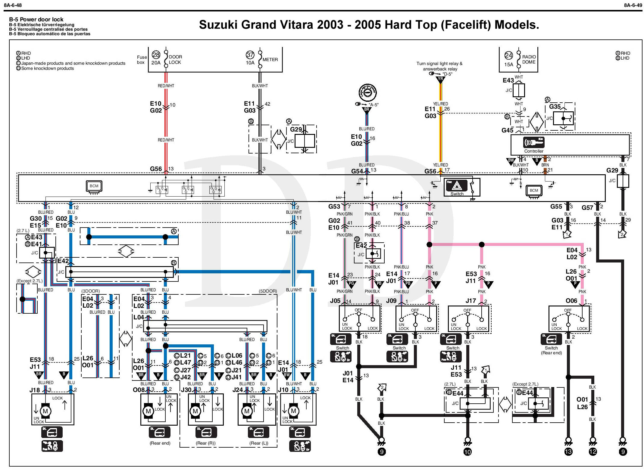

I have got myself a Hawk kit, has anyone got a photograph of which plug the wire is in?

Just follow the 2 wires from the locking switch on the door down to the right hand side of the pedals.
If i remember it was a tight spot for the plug so attached to the wires some inches before it.
Use a multimeter on the door switch or follow wiring colourts shown above.

ipbr21054 wrote:Just follow the 2 wires from the locking switch on the door down to the right hand side of the pedals.
Seems the wiring diagram I have is way off, the one I have has pink & pink / green, turns out those are pink / black & pink /green.
Interesting thing is though, if I get the multimeter on those wires to a live it just completes the circuit and no difference is made with the switch.

Re: Grand vitara central locking advice.
Post by Darrell » Tue Dec 23, 2014 7:14 pm
The kit needs to earth either of those wires.
Yours being a 54 plate may have this wiring..
This is only applicable to the hardtop version with the updated dashboard 2003-2005
Grand vitara central locking 2003-2005.jpg (453.2 KiB) Viewed 10134 times

Darrell wrote:
Thanks, you literally solved all my problems :D .
I will give this another crack tomorrow, am I right in guessing that the Blue / Red from the ignition is a permanent live feed, and the Yellow / Red will give me the hazards?

Post by souleh » Wed Dec 24, 2014 2:27 pm
Right, the central locking is spot on and working now. Just cant find the wires for the indicators, would you have the wiring diagram for those?
