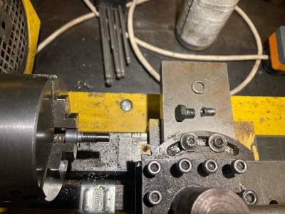

I've been messing around trying to relocate all my tools and workbench home from work, to the considerable distress of the missus. However, I did manage to pull the gearstick tower and fish out the broken end of the bolt that keeps the gearstick from rotating, which I understand is a common thing on these.
I can just about get to my little lathe so I machined down a stainless M8 bolt to suit the groove in the gearstick, the result being that it doesn't weeble-wobble or fall down any more.

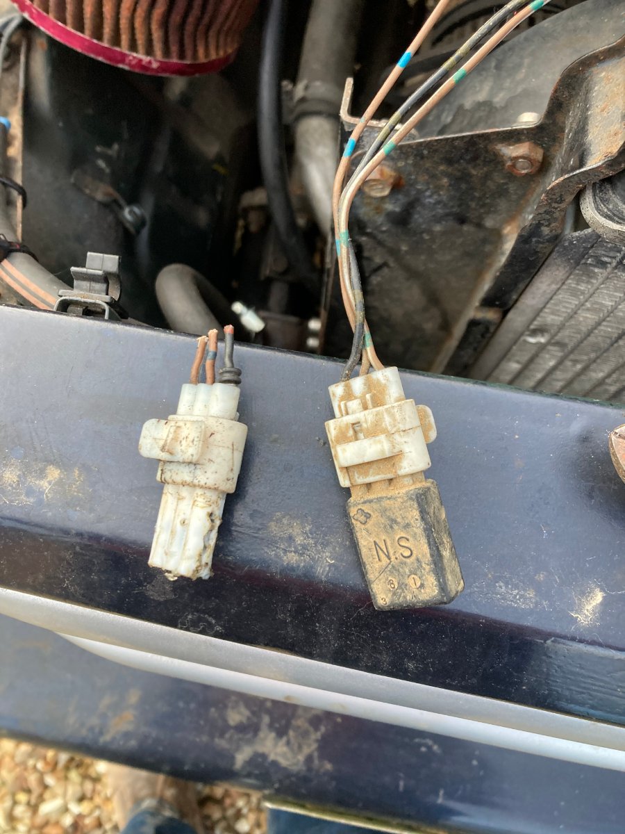

I finally got a tachometer noise filter delivered from a 'breaking' listing on ebay, I've been chasing it for weeks.
old vs new. Ol' mate Dave had added a scotchlock into one of the wires so I just cut and joined all 3 with decent crimp connectors.
Result
Not bad for £10 and a lot of patience.

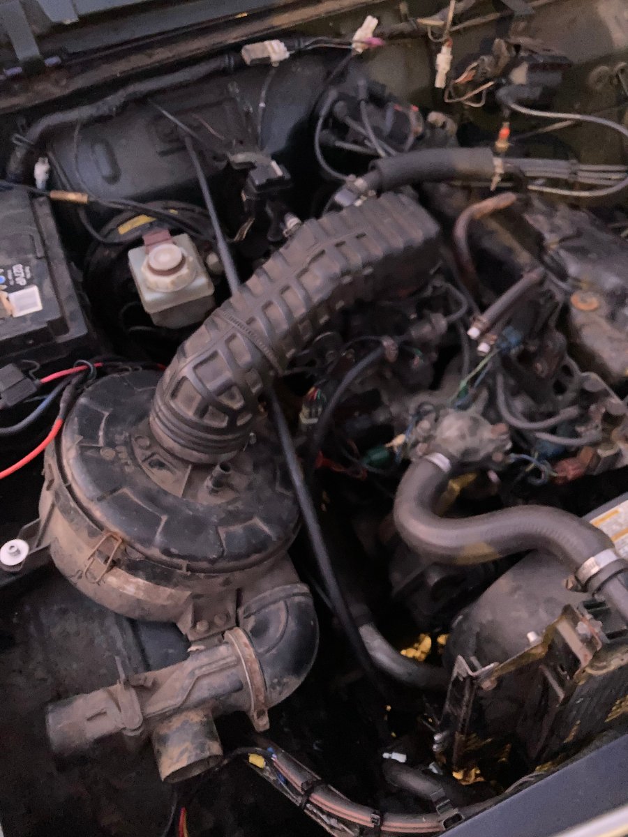

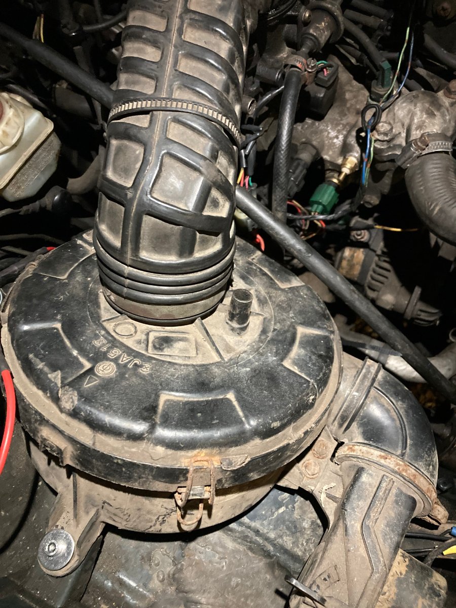

I just about had time before it got dark to fit the proper airbox Scott sold me, a bit tidier than the bistly cone filter thing.
If anyone knows what connects to the nipple on top then let me know please, else I'll blank it off.

That nipple from the airbox there’s a pipe that runs into a T piece to the PCV valve and across to the rocker cover.
I should have one if you need it. If you end up back at the pressure regulator I think I have another I could send you another to test 😅
