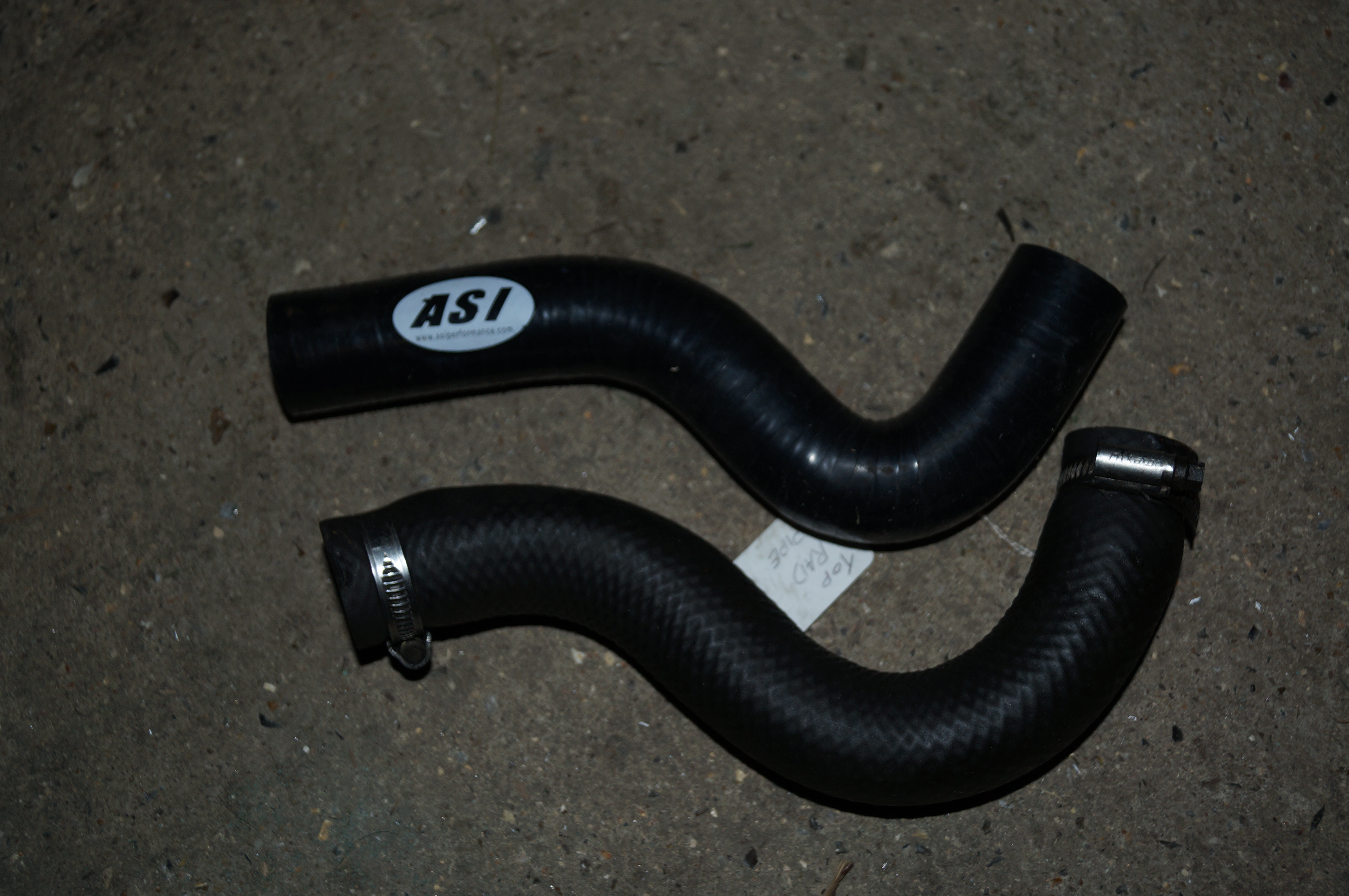

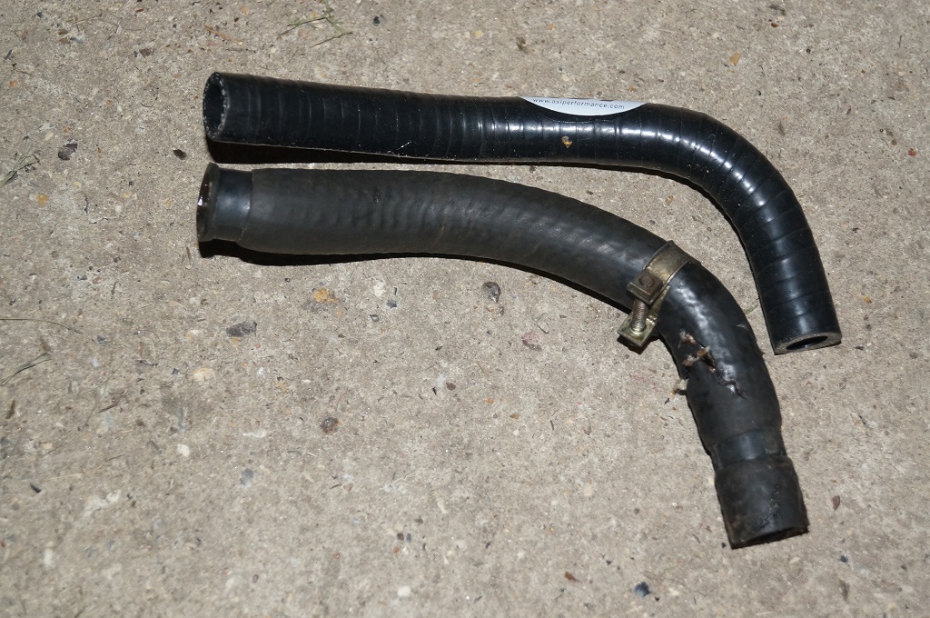

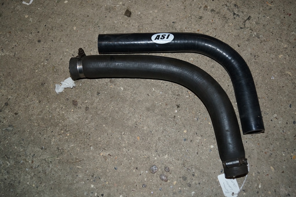

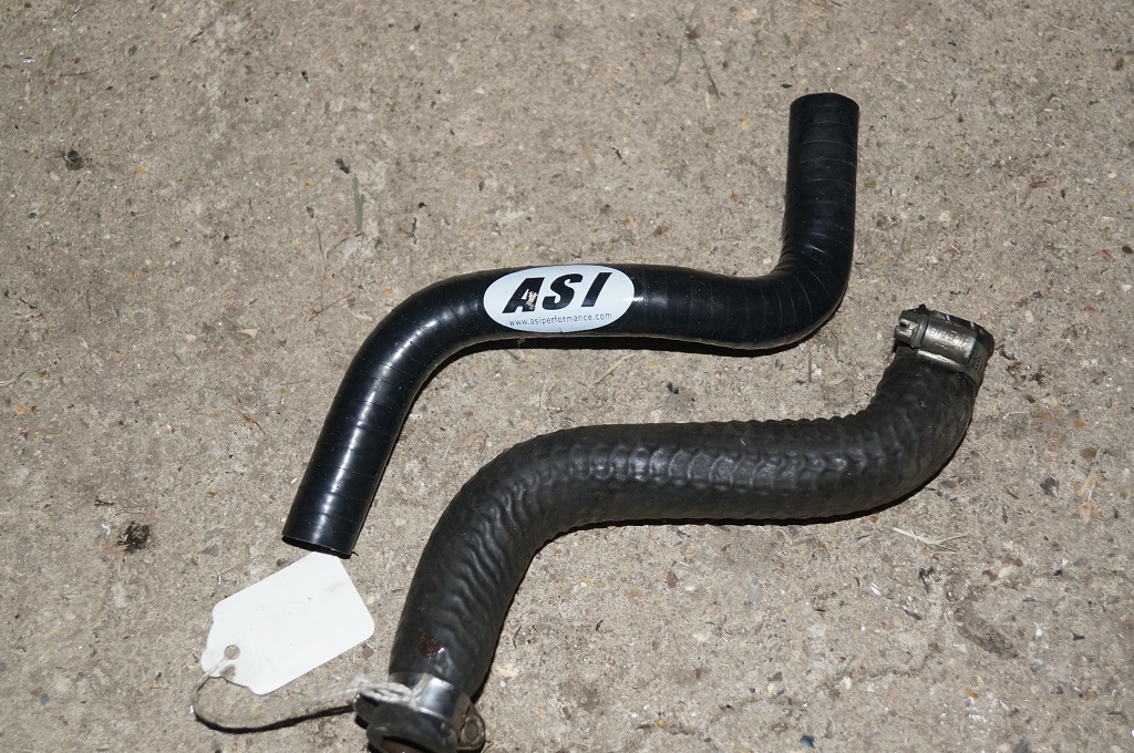

Post by lazy rambler » Wed Sep 19, 2012 10:06 pm

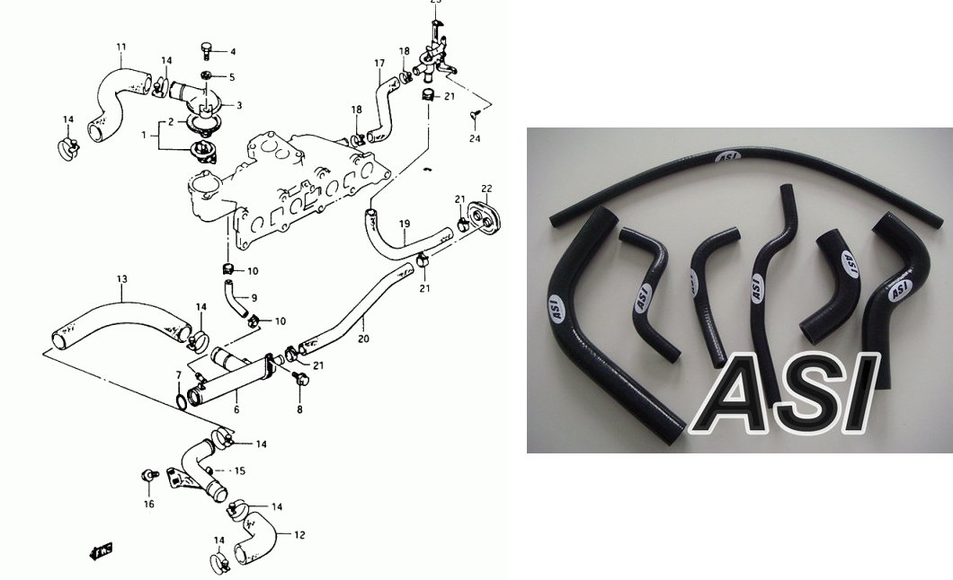

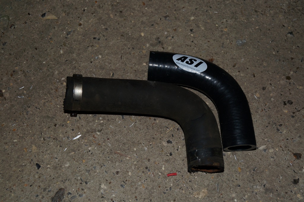

Just compared them to the standard ones that I'm replacing. The bore size is spot on, maybe a little tight, but some of the pipe may be a bugger to fit as the shape isn't quite right, some worse than others.

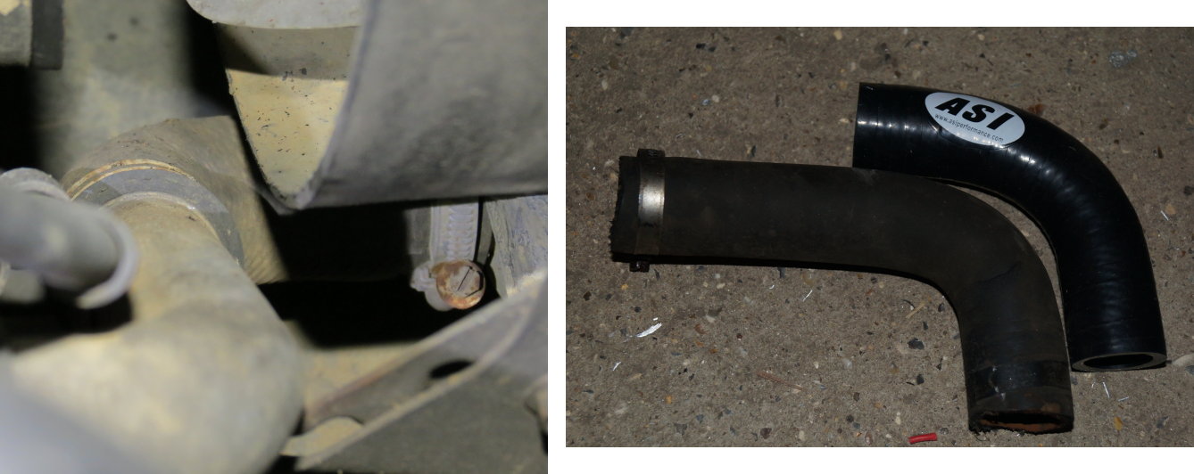

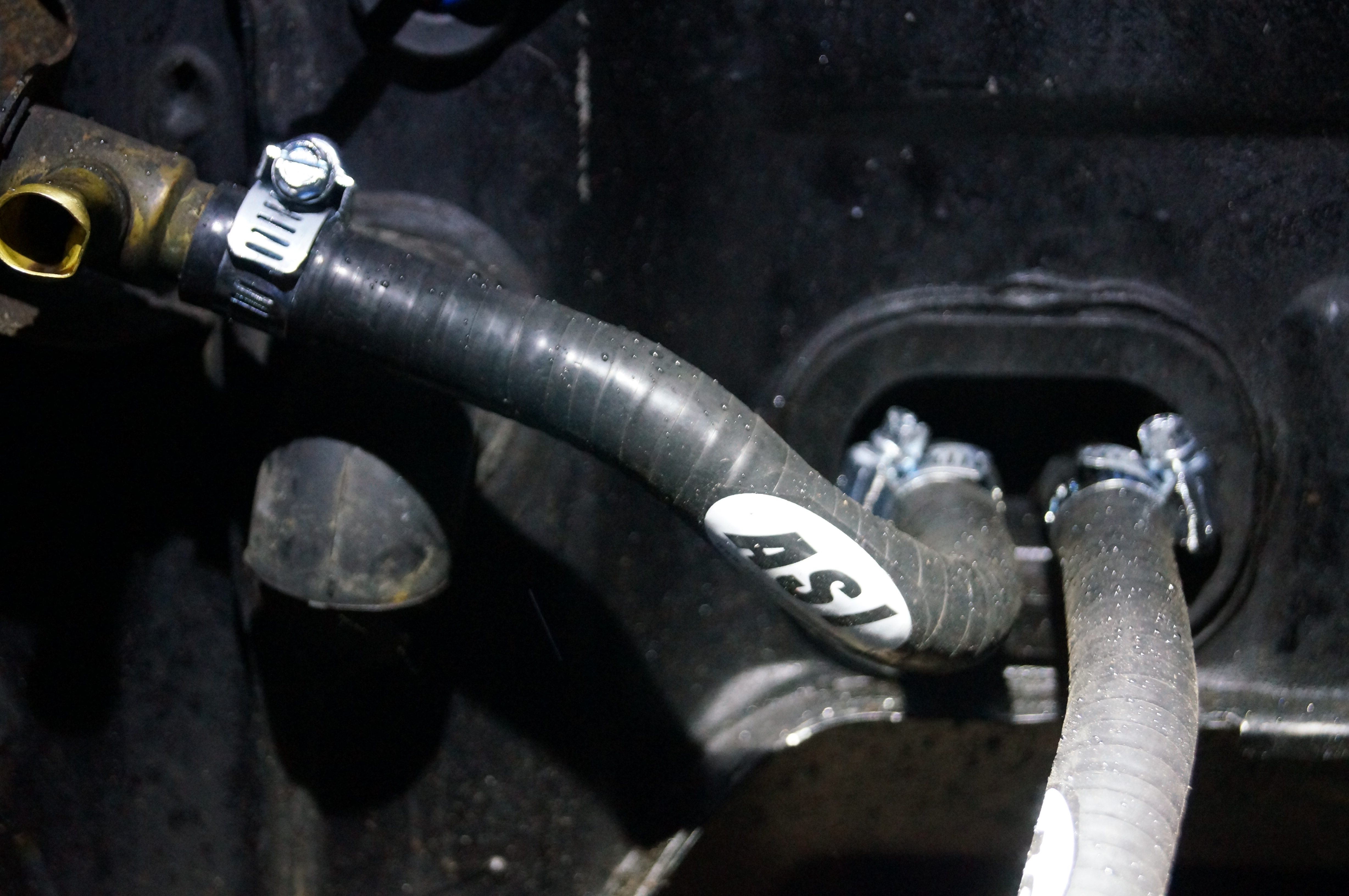

Post by Darrell » Wed Sep 19, 2012 11:07 pm
Looks promising :thumbup:
My lower hose is equal unlike the one that was fitted to yours. IE: like the one supplied.
My heater out hose is like the one supplied. Yours looks like a piece of universal hose.
The others hoses match :thumbup:

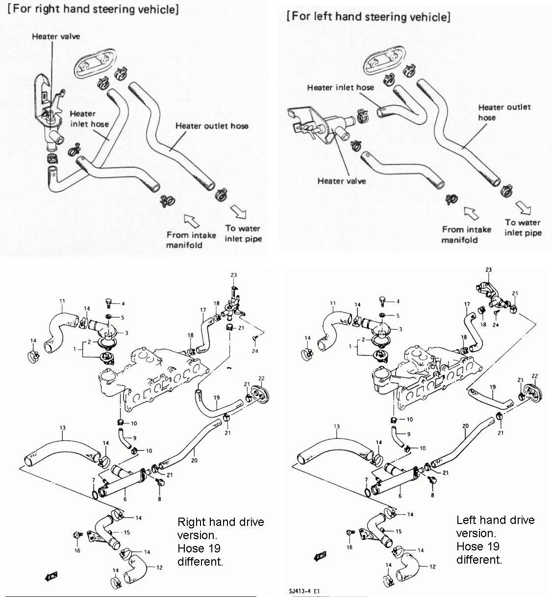

Post by Darrell » Fri Sep 21, 2012 1:06 am
Spotted one potential problem. As these kits are aimed at the American market that is what there made for. Only thing is hose number 19 is different on a right hand drive vehicle. In your photo they look to match quite well, but mine has a tight 90 degree bend just under the heater valve like shown in this diagram.

Post by lazy rambler » Fri Sep 21, 2012 9:35 pm

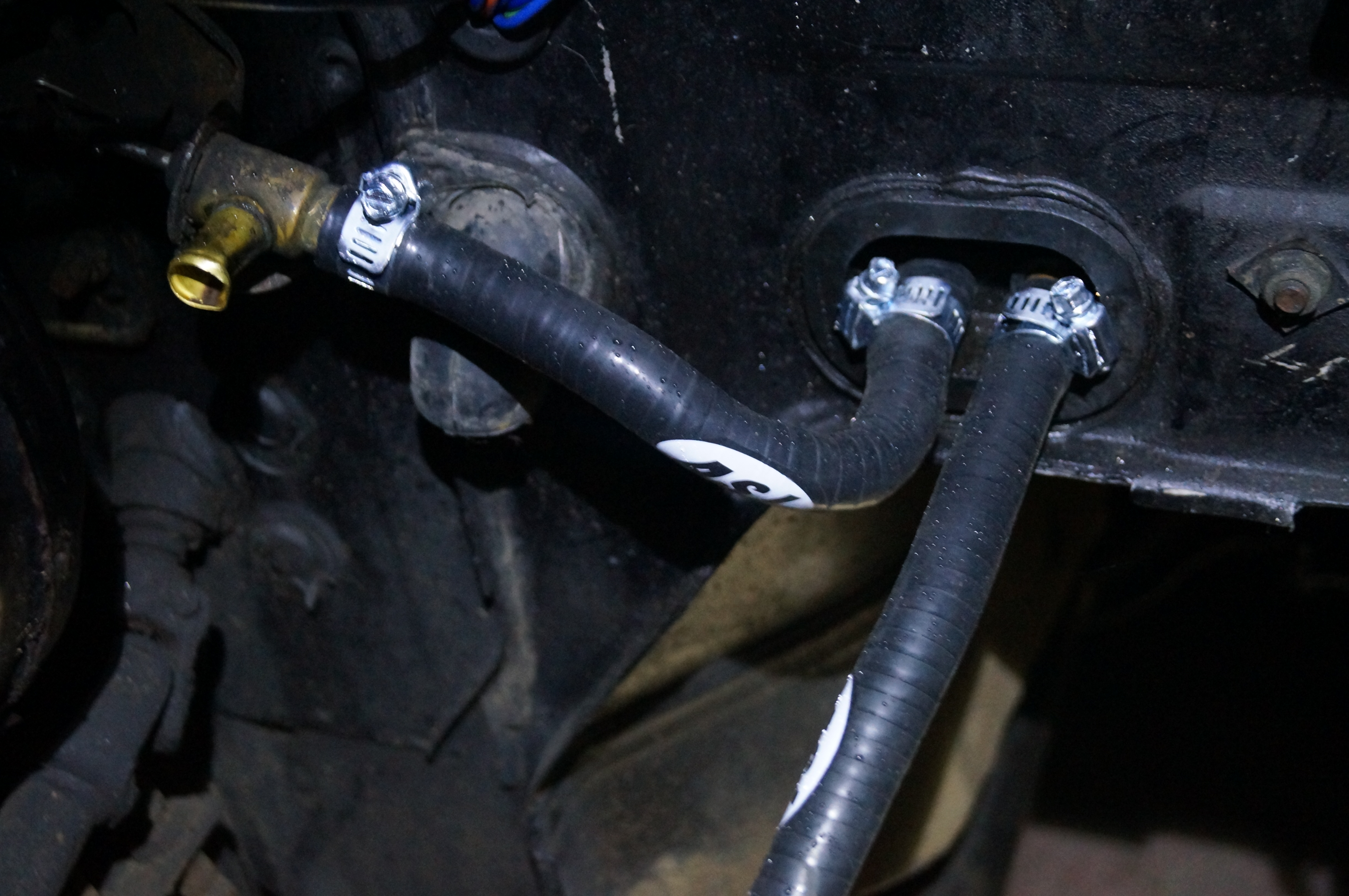

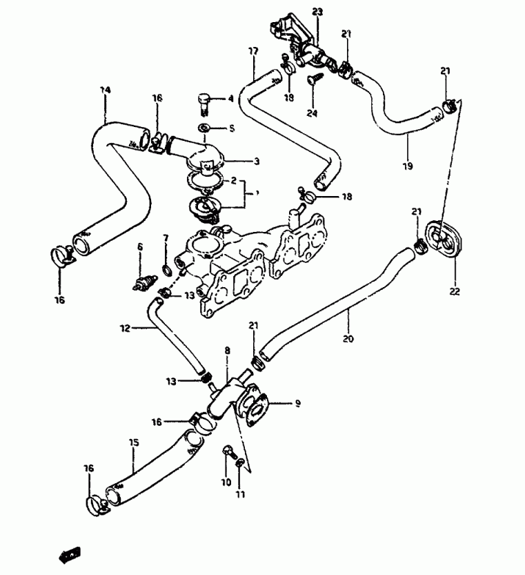

The one I most concerned about is hose 20. As I'm fitting it to a 1.6 the exit for the water rail (or whatever it's called) isn't on the back, it's on the side :er:
Anyway this is 19 in position.
Now a build in progress

Post by Darrell » Sat Sep 22, 2012 1:01 am
I see your heater valve is already fitted at an angle which helped the hose fit :thumbup:
I see what you mean about the water rail being different on the 1600.
