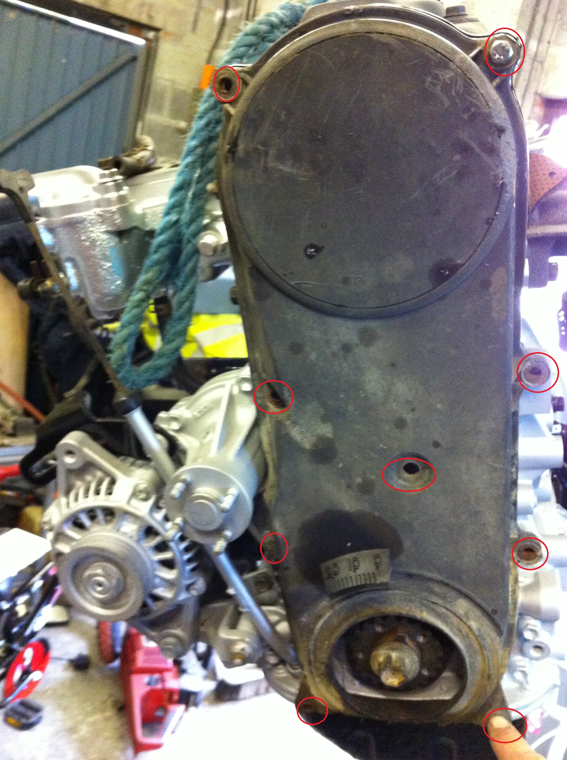

hi, ive been asked how to change a water pump on the 1.6 vit engine so ive done a quick guide ive got the engine in the air at the moment so i took a few pics.
hopefully its right but feel free to correct me, its off the top of my head.
start off by removing fan cover and fan off the water pump
slacken off the alternator and power steering pump and remove belts.
drain coolent
remove pulleys off the water pump
remove bottom pulley off the crank. (small bolts not the big one in the middle)
remove covers
remove cam belt, (not sure if you could keep in on the teeth) possibly marking where it goes?
then remove pulley and water pump and replace.
and put back together in reverse order, and refill the coolant system
bearing in mind the timing will need to be done if you removed the belt but if you carefull you shouldnt be a million miles away.
there is some info on timing here http://www.suzukiclubuk.co.uk/index.php ... =13&t=3202
feel free to correct me.

No you shouldnt need to remove the large boltdamo wrote:im just on with swaping my water pump but im having difficultly on taking off the timing belt cover do i have to take the big nut off the crank? if so how do i undo it with out the engine turning over (its a sj413) but im guessing it should be just the same on a vitara?
Re: 1.6 water pump change
ive had it in gear and hand brake on but its still turning the engine.? how do i get the timing belt cove off then robbie i thought the large bolt had to come off too the cover dosent seem to want to come offany ideas? would appreciate any help
- ROBBIE
- Posts: 4569
- Location: Dorset or stuck
Should be these bolts out
bottom pulley off, fan off and the it should pull offSid James gone but never forgotten
