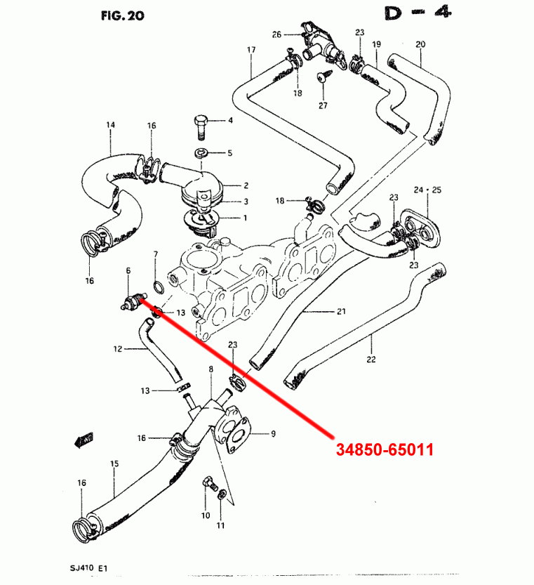

Been and had a look at the online drawings and all that I looked at (about 10) showed it as part number 34850-65011.

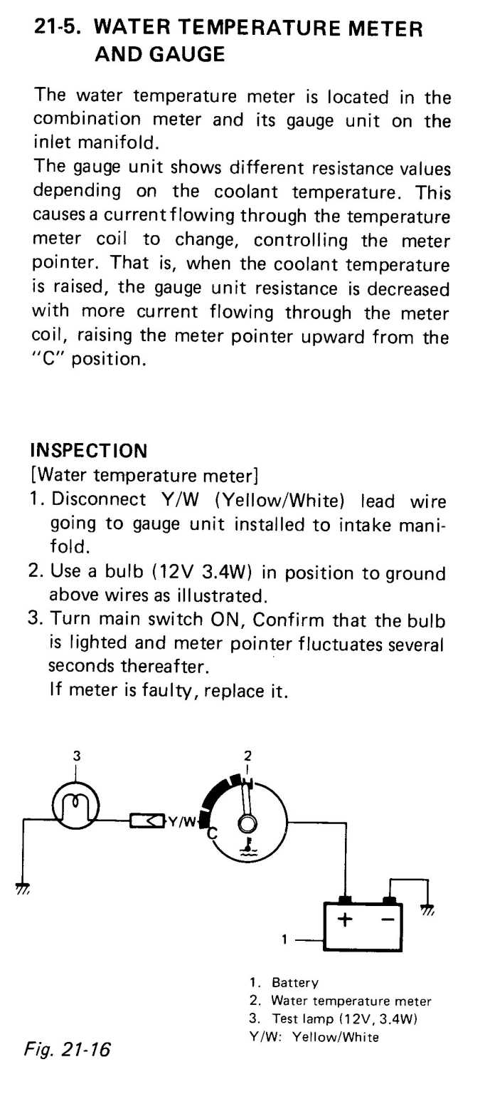

Have you tried a bulb on the sender wire too make sure it's the sender that's knackered ?
This diagram is for the 413 so the wire colour may be different. Don't worry too much about the bulb wattage as you just want to see if the gauge moves proving the senders shot
