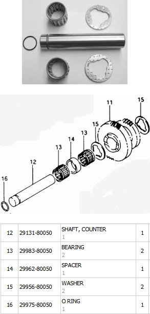

so I took my box apart, and found that the needle bearings in the intermediate gear fell apart when I took them out. has anyone got any idea where i could get new ones from? the guy who serviced it before I owned it said he had replaced all the bearings before, except the needle bearings because he couldn't find them

Post by Darrell » Mon Apr 22, 2013 9:22 pm
Try "Googling" the part numbers for availability over there.
I have found a repair kit as I don't know what state the shaft is in.
http://www.4krawl-products.com/en/trans ... -kit-.html
The countershaft part numbers are the same for the 410 or 413 transferboxes.
Countershaft SJ Transferbox.jpg (33.74 KiB) Viewed 5565 times
