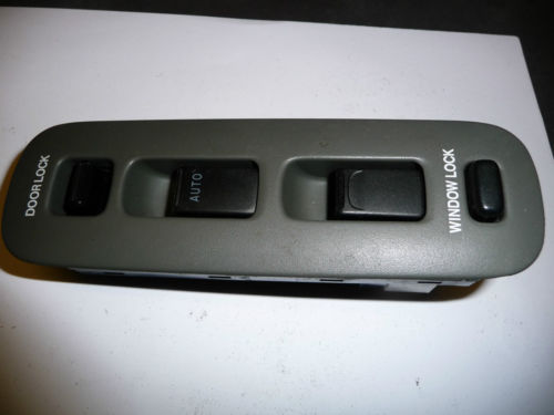

Post by Darrell » Sat Feb 01, 2014 12:00 am
Well had a "google" and this should be the switch on yours.
No help with the auto locking, but you shouldn't need to keep taking the key out to open the rear door. :er:

Thanks mate,will have a try with the fuse popped out.Didnt realise there is a door lock at the top for the rear door lol.
