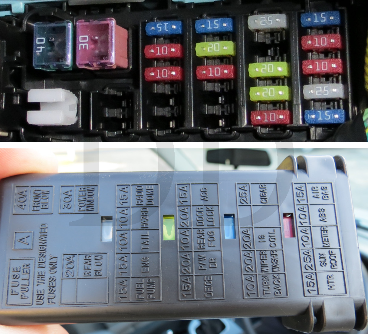

Re: Oh deer, gv indicators not working?
Post by Darrell » Sat Jun 21, 2014 9:46 pm
Have you started with the basics IE fuse.
This mine from a 1600se 2005
Grand Vitara 1600se 2005 internal fusebox.jpg (348.3 KiB) Viewed 4458 times
