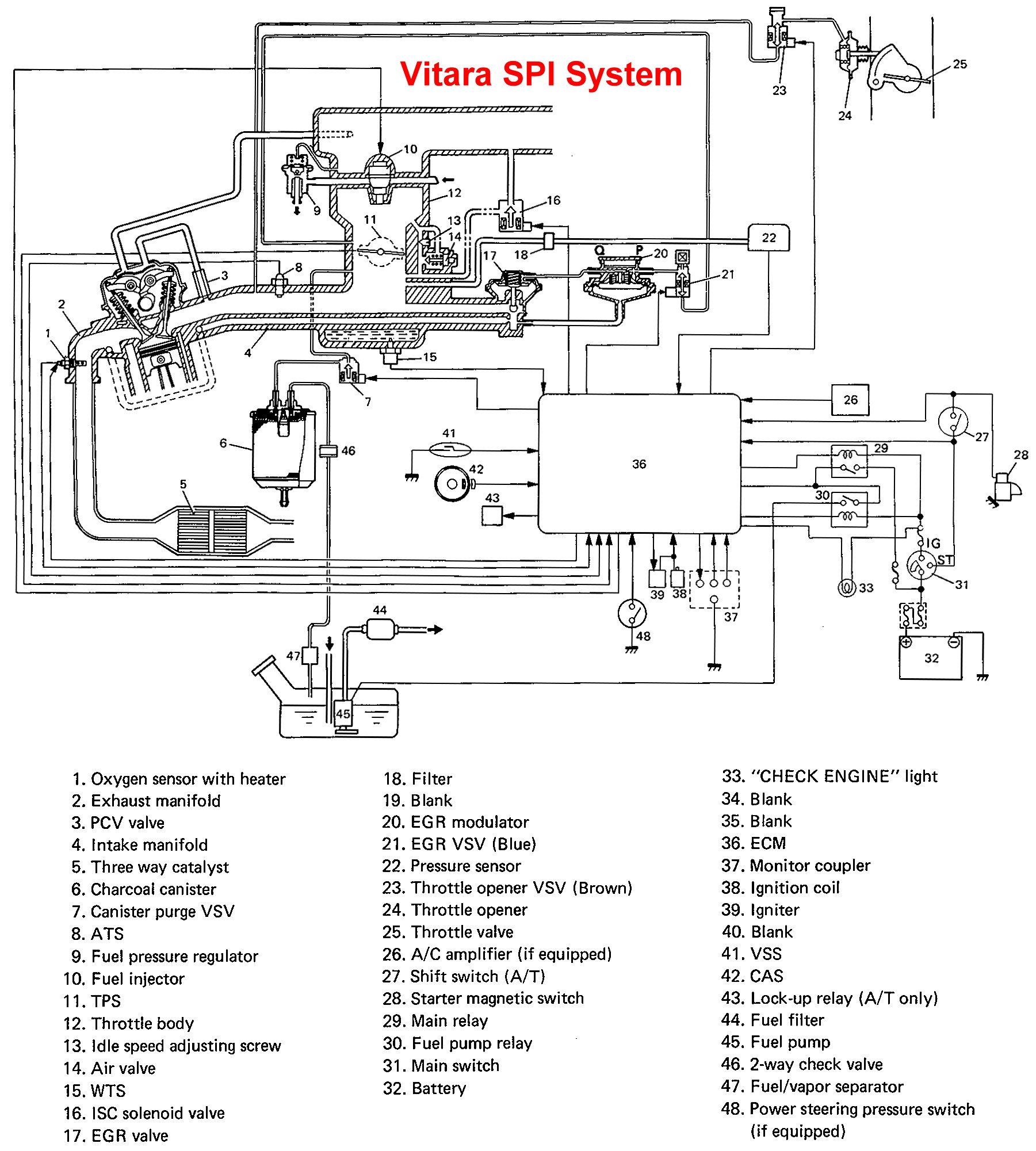

Use a high pressure filter, a Vit one would be OK. You should run it off a relay controlled from the ECU as per the original 16V wiring, that maintains the Ignition fail Safe function.

Ignore the instructions that come with the pump.
Mr Rhinoman's right, as your using the Vitara loom :thumbup:

thanks lads so on the diagram 30 is the fuel pump relay , I just connect up to that ? , just to check how will I know which 1 is which , thanks

Post by Rhinoman » Sat Dec 13, 2014 10:35 pm
You need to follow the schematic that is in the FSM here:
http://www.rhinoman.org
Its a few pages on from that system diagram.

spot on mate think I followed it right fuel pump relay A20 - p = pink wire

Sorry to be a pain lads a was having a look today to see if i could find this relay fir the fuel pump av got bout 4 relays n havnt a clue which 1 i need ,and what is this from petrol tank
