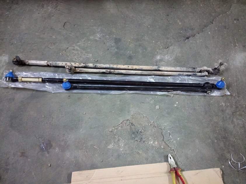

I got one from Japanese 4x4 it cost around £120 including delivery, mine is a Spanish 410 though but I think the jap ones are similar price.

I have heard of people getting them made up with removeable joints on each end, with the threads being cut by an engineering shop. I have been told the balljoints of a 80's series landcruiser will fit. they have the funny double one, as well as the singles, and also have the same taper, so there's no too many fitment issues

I haven't bought it myself but a friend of mine just bought one for about €65... I'm going to get one and will see how much they are to ship to the uk

kiwizook wrote:I have heard of people getting them made up with removeable joints on each end, with the threads being cut by an engineering shop. I have been told the balljoints of a 80's series landcruiser will fit. they have the funny double one, as well as the singles, and also have the same taper, so there's no too many fitment issues
The 80 series TRE's have a large taper compared to the Suzuki ones and the knuckles need to be reamed out to the correct size, the reamer on its own is around £50

ScottieJ wrote:The 80 series TRE's have a large taper compared to the Suzuki ones and the knuckles need to be reamed out to the correct size, the reamer on its own is around £50
so what I've been told isn't entirely accurate, story of a lifetime. still could be a good thing to convert to run cruiser tre's, as they are a lot beefier than the sj ones
