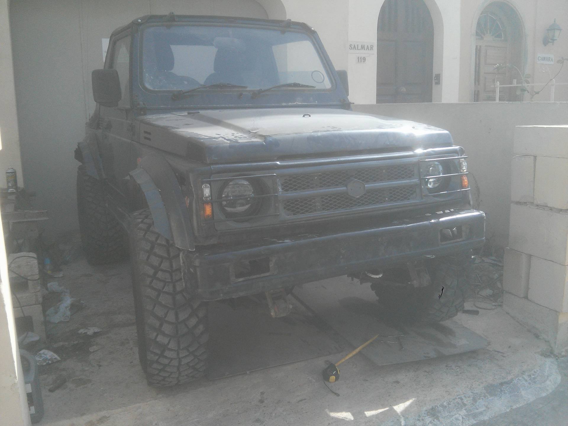

What did I do today.... fitted a gypsy bumper for the VRT/MOT.... and no it doesn't clear the 31s at all haha

Is your VRT as strict as our MOT twiss? are you confident about your LED's going thru OK?

Well they have made it a bit more strict on modifications here this year.... so things like winch bumpers, rollcages need approval from Transport Malta (maltese DVLA)
From speaking to the locals people seem to just swap parts about for the VRT. Only every 2 years so not too much hassle.
But apart from that they can be a bit slacky. Like my last car I VRTd passed with some lights out and they didn't even check things like the seat belts.
