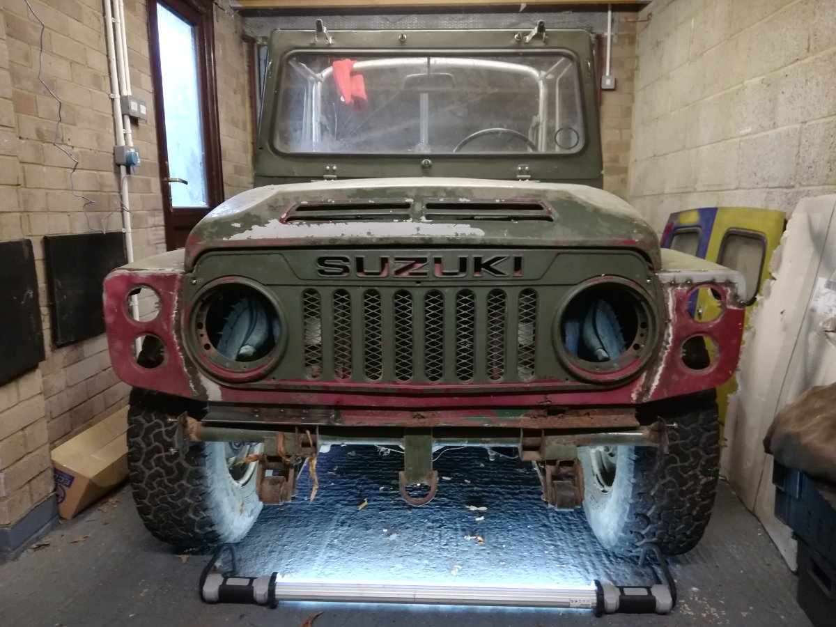

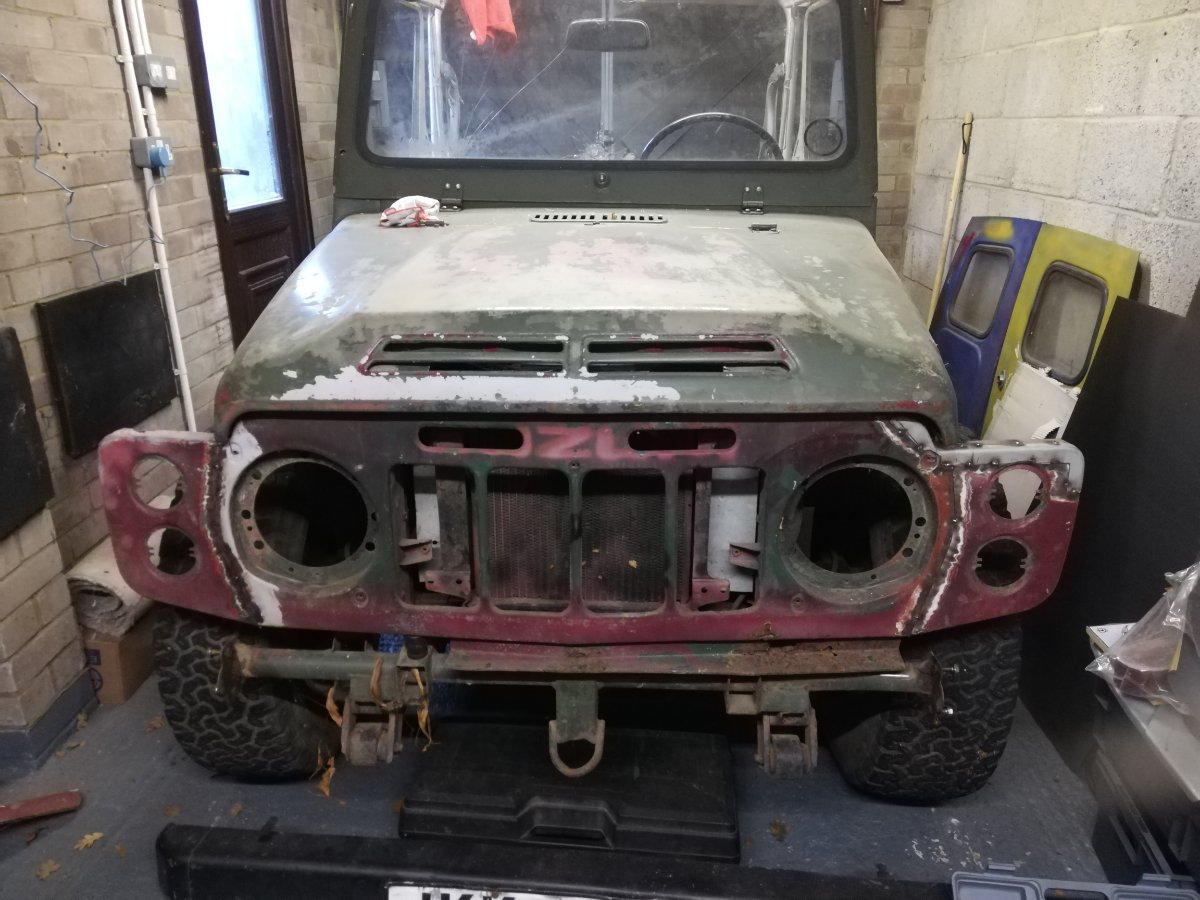

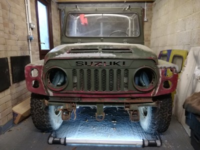

I will be starting fabrication work on the front hopefully this weekend, and fortunately there is enough original metal still there to give me a good idea of how it should all be constructed. The only thing I would like to know is what the exact width of the grill/lights/front panel should be? After that everything should fall into place. Any chance you could throw a tape measure across that please at some point? It would be a massive help:)

Apologies for not responding sooner, I will sort out some measurements for you.Any chance you could throw a tape measure across
Do you have the plastic front grill ?, which will be a useful template to set out the headlight positions.
Re: LJ80 Recommissioning.

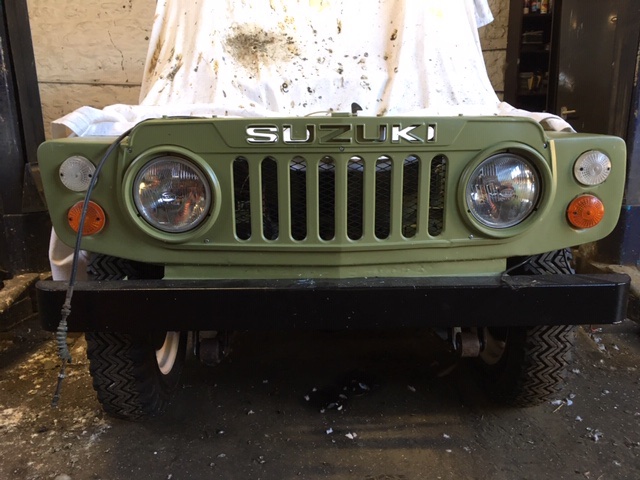

Okay, I can see from a photo that you have got the plastic grill and the headlights are in position.
For a general dimension and using the top centre screw that holds the plastic grill on as a datum, it measures 708mm to the outside i.e. the furthest I can measure just beyond the sidelights. I think my front is original (needs work), it is the front wings that are a later addition.

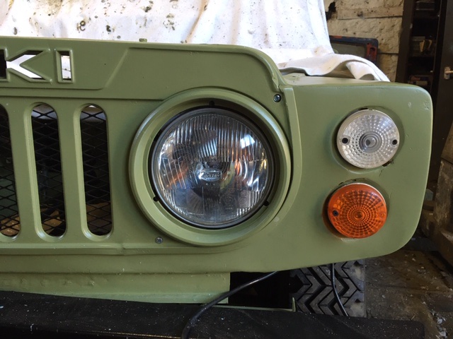

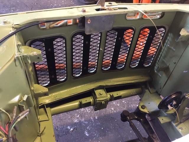

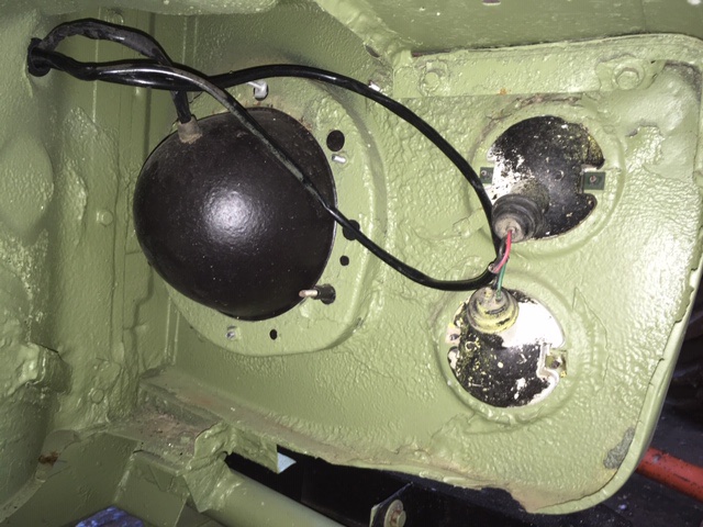

I am attaching a few photos of this area on mine, which may give you some more information.
If you need a more specific dimension I will try and help.

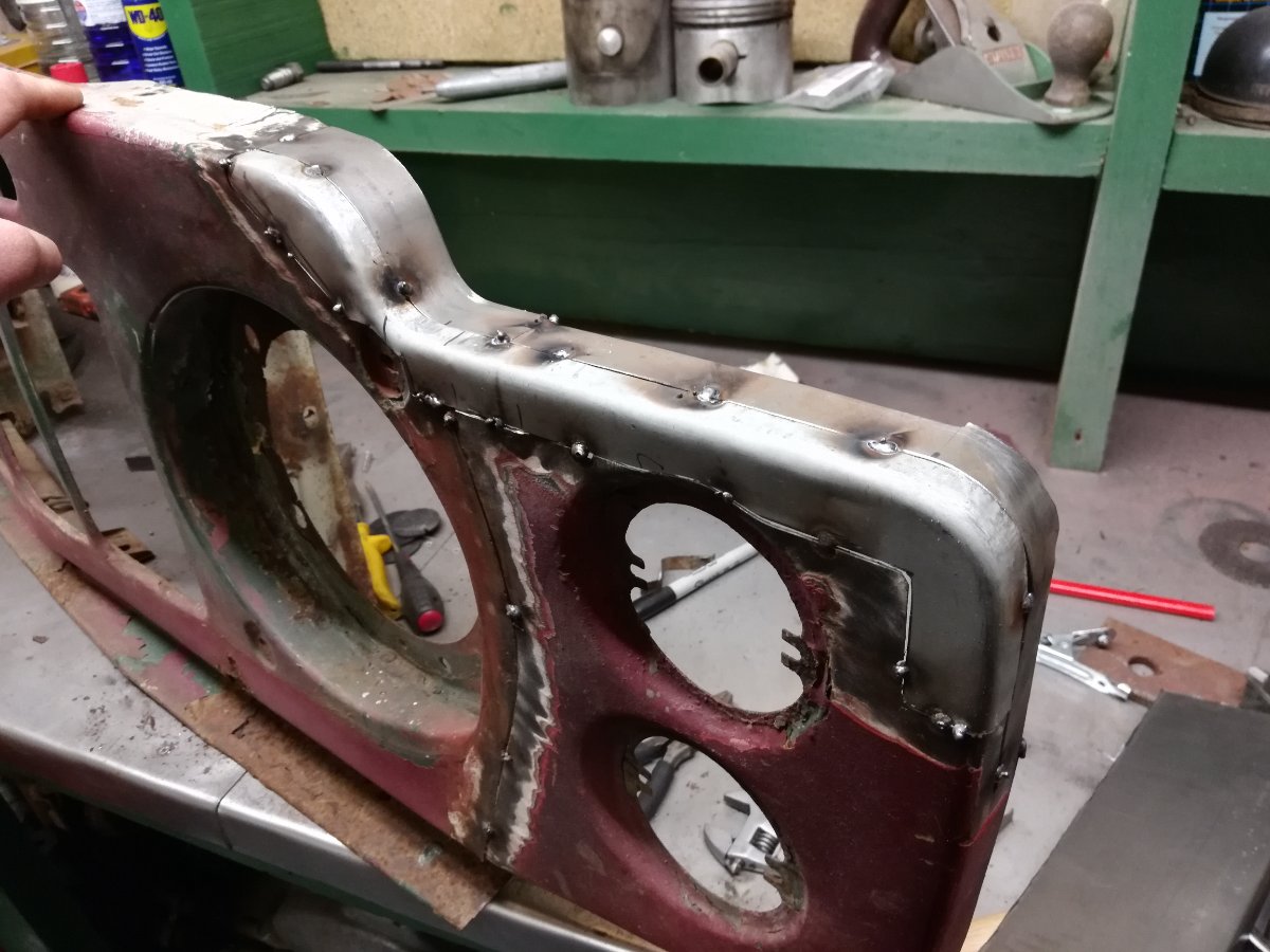

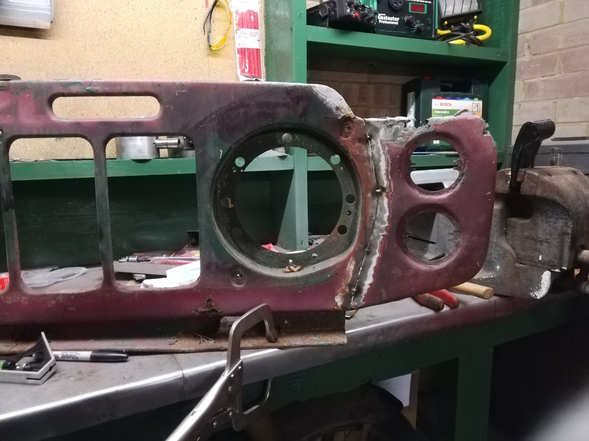

And thank you very much for doing that for me Robert, its a massive help. I have tacked one half of my front panel back together, (just by eye where it looks right) and it measures 700mm from the centre. so it has potentially lost 8mm since it was cut off... 8mm is quite a lot and where its welded on will determine where the outer wings sit, and that will determine how I rebuild the inner arches. so it is important that I get it right.

Neat butt joint, I would not worry about the 8mm. It will mean your LJ will be lighter and have less wind resistance.

Haha, very true! The joint is pretty much exactly how it was originally cut off. I will weld the other side on in the same manner and see how they marry up, as symmetry is the most important thing to me.

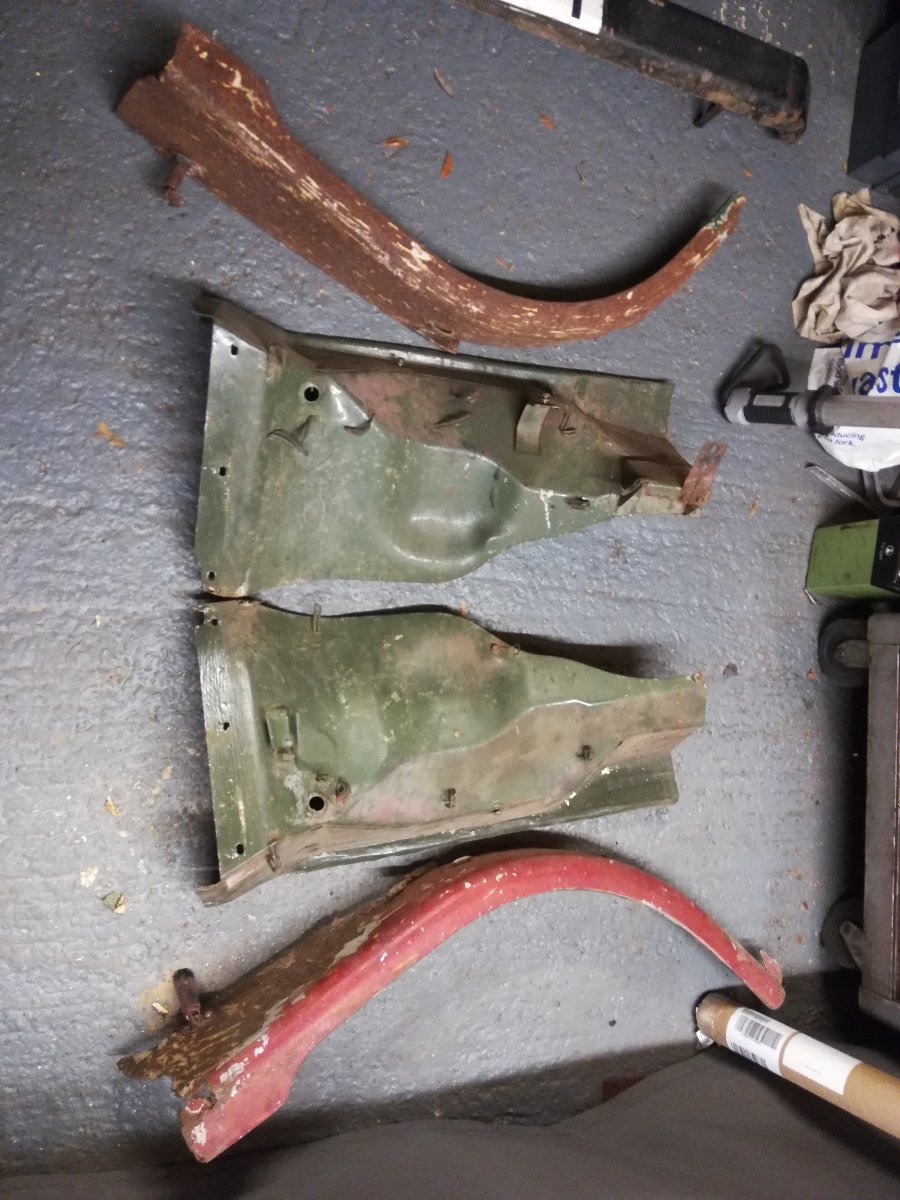

I haven't made any huge leaps in progress recently, but last weekend I went and collected some new wings which scott sold me. Its a big advantage and I'm very pleased as its going to save a lot of time when compared to the old ones which I had planned to repair and use.
