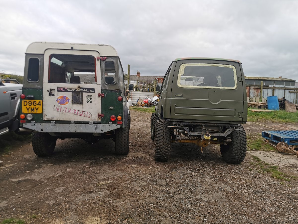

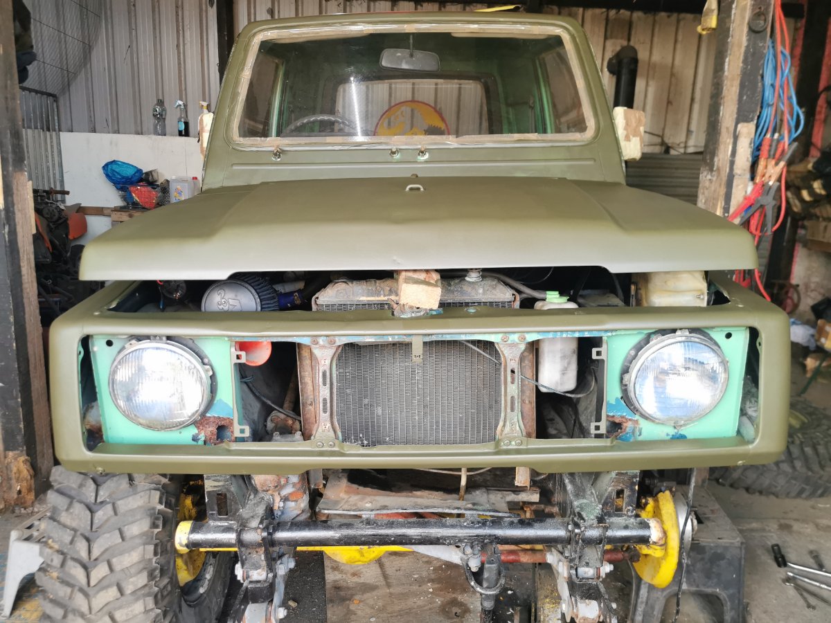

Now I am confused, mind yoiu does not take much :D Couple more pics to see if you can see anymore detail, will take better ones tonight.

Its an sj, bit hard to see but from them pics the axles look like sj axles. Which means you should have 3.9 or 4.1? diffs. Both better than the samurais 3.7.
Samurais are sj's too but have wider axles and a different front end and where the leaf springs mount arent under the chassis like yours are.

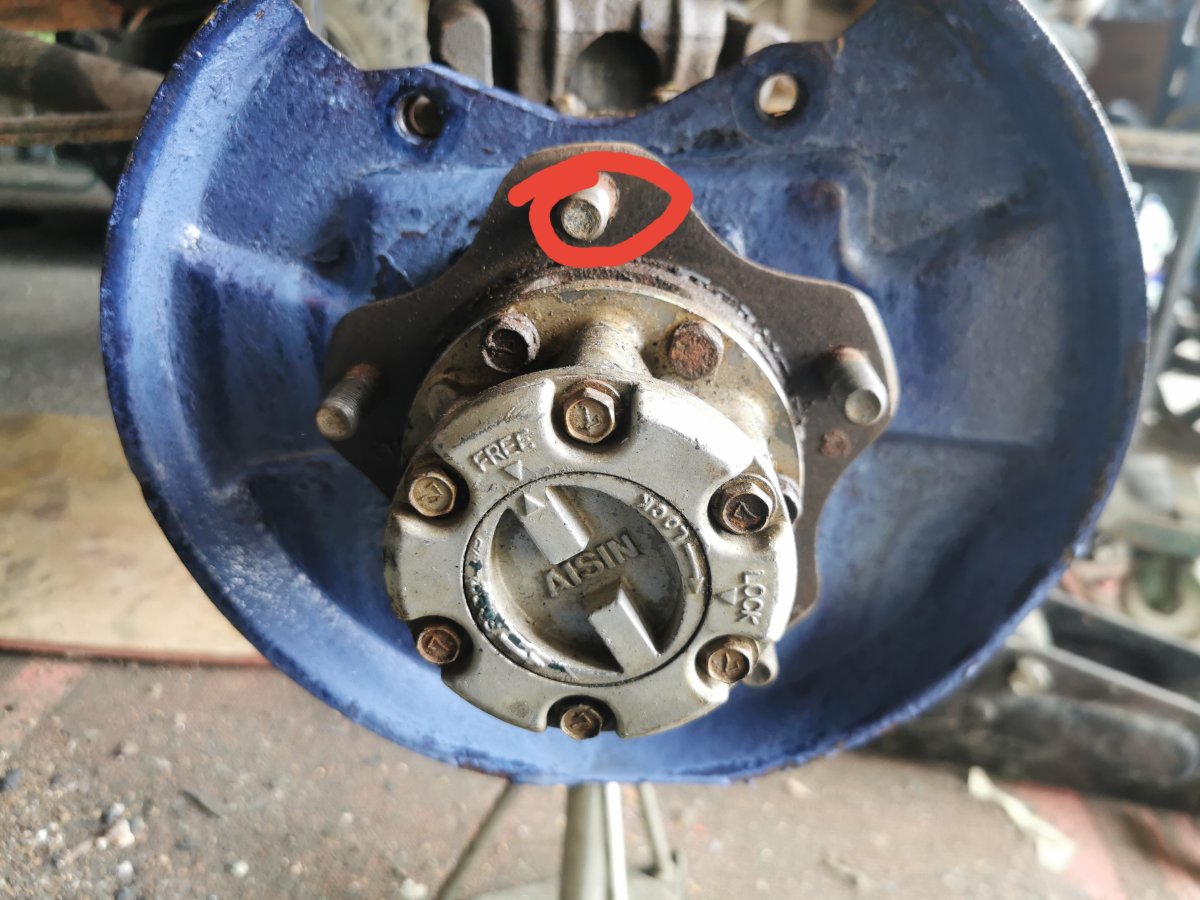

If you takr your front wheels off, measure from face of hub to face of hub it will be either 52.5 or 48.5, that will tell you if you have sj or sammy axles.
Both sj413 and samurai axles diffs are interchangeable and also accept vitara front diffs. Sj410 are different.
For 31" tyres you need a healthy engine, 410 transfer box and 3.9 diffs to be back at standard gearing (thats on a 1.3, a 1.6 should be ok with 3.7 diffs and a 410 transfer)
Thanks again, so when I measure is it from this face circled in red, or further forward ? Cheers
