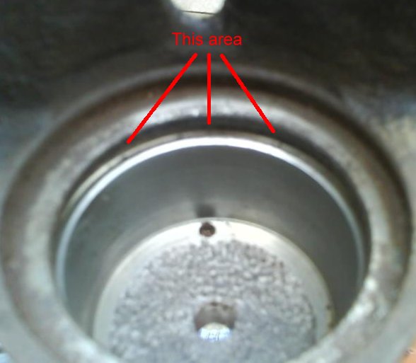

been for another test run, and the locker seems to be coming in at the wrong time or releasing at different time, I have put this down to the one brake calliper sticking all the time. Thought the new lines would of helped this.
Whats the best thing to do with sticking callipers? send them away for referb, do it yourself or buy new? new seem to be way too expensive.

I've had mine seize up a few times over the many years I've had it. I have always just stripped it down and cleaned everything up. The piston is the main part that seems to get grubby and this has always cleaned up nice with wd40 and fine wire wool. The only other bit that may have some rust on and require a little emery paper is the area between the main oil seal and the dust seal/boot.
This depends on how much water has managed to get behind the dust seal/boot. Other than that go for reconditioned units, shop around as the prices vary quite a lot.

Top one Darrell. cheers for that.
Got the piston out and as you said, there was some rust on the areas you said. but not too bad. So cleaned up and replaced. works perfect now, made such a difference.
