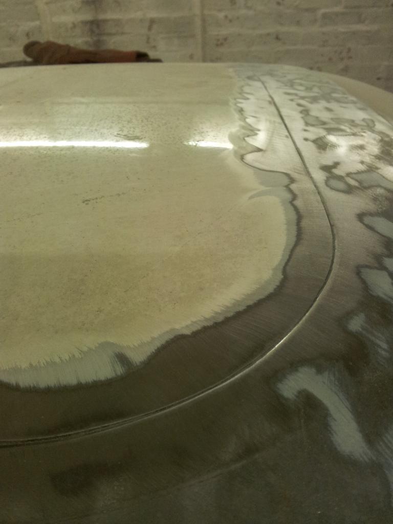

Had a day off today so went down the workshop to play with my joggler..
Started like this.Image
Had a joggle.
Cut and shaped the roof cut to fit.
Ignore the paint..It's all coming off.
From inside.
Just need to hole punch and weld from inside.. Then lead load from the outside.
I'm pleased with the new tool (joggler/edge setter) the two pieces of steel overlap by about 12mm making a stronger join than butt welding and also sit flush/flat on each other.. I'm hoping the join won't be visible from to outside when completed... The inside will be covered by the roof lining.

That's a nice fit with the repair panel! I've got one of those little jogglers, they are damn useful!
