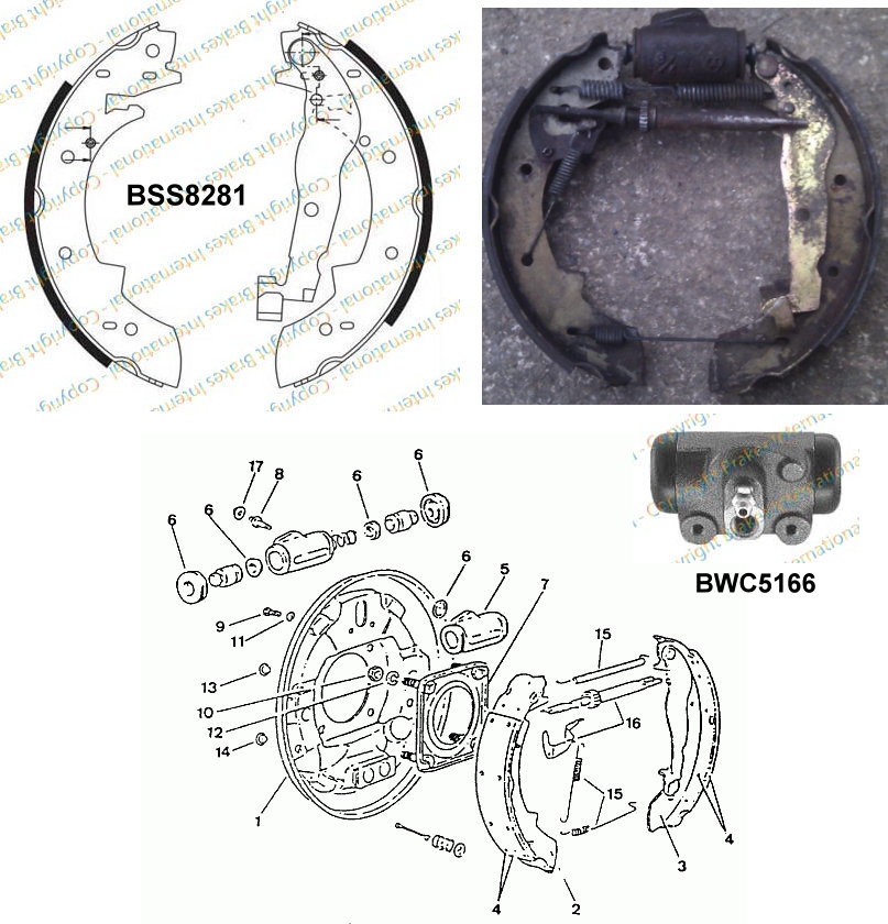

I'm going with they are the Santana with self adjusting mech (but it's missing on one side !!)
- BSS8281.jpg (137.75 KiB) Viewed 5483 times

Well the top drum came of my zook which my zook is jap built
I was thinking on what pads to get as I don't need the handshake thing

Re: i need help with brake shoes and cylinders on 410
The shoes without the handbrake lever are for a smaller drum

I forgot to measure the inside of the drum to make sure there both the same
Plus on my axle it Tss of unlike my other axle
So that means I have got to get the right cylinder
- Zook axle
- IMAG0270.jpg (1017.1 KiB) Viewed 5475 times
- Spare axle
- IMAG0289.jpg (938.88 KiB) Viewed 5475 times

Just remember though your SJ is 27 years old so what's fitted isn't necessarily what it left the factory with

Just to add a little more confusion to this, that looks exactly the same as what is fitted to my Sammi. The shoes with handbrake lever, cylinder, even the mounting of the T piece for the brake pipes.
- IMG00098-20110505-1854.jpg (475.75 KiB) Viewed 5466 times
- IMG00513-20110220-1703.jpg (426.31 KiB) Viewed 5466 times
