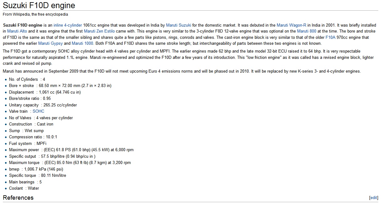

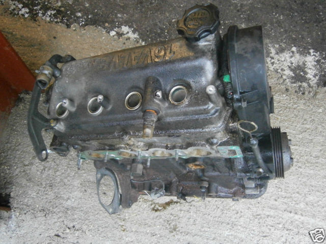

Post by Darrell » Thu May 02, 2013 8:09 pm
I checked the diagrams for the alto and it came up with this
"Alto MA800 RF410 SB308 SH410 SS80"
I have no idea which one has the f10d engine in it :oops:
I looked for pics of the f10d but this is the only one I found out the engine bay.
