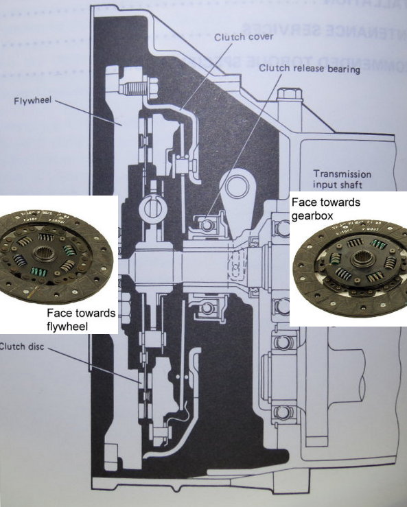

Re: Clutch grinding and full Adjusted but no drive????
Post by Darrell » Thu May 30, 2013 10:36 pm
Guess what ;)
413 clutch.jpg (99.77 KiB) Viewed 4083 times
not me :D
