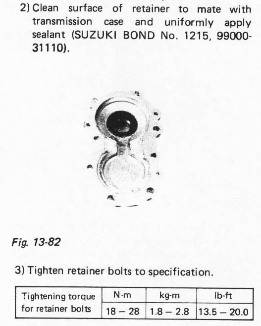

Jordi wrote:I am right in thinking its just take the cover off behind the release bearing. Swap seal & refit?
It looks that way from the diagram.
Piece of cake once the box is out. ;)

You might need a new gasket for that cover too.
Re: Front gearbox oil seal emergency!!!
Post by Jordi » Sun Jun 30, 2013 9:34 pm
Sure liquid gasket would do.

Post by turbo-tom » Sun Jun 30, 2013 9:48 pm
cant see why gasket in a tube wont work! :D My old 5speed box leaked alot and sounded like cement mixer.. all because i was too lazy and didnt replace the seal and one day went out forgot that it needed oil and boom dead gearbox.
Post by Darrell » Sun Jun 30, 2013 9:49 pm
"Silly-cone-snot" is what suzuki recommend :thumbup:
