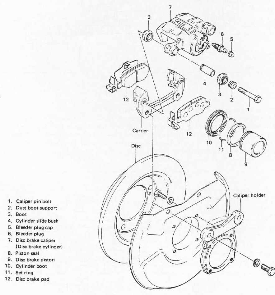

Yep I gave it a clean after I took this pic
Yep I am well chuffed got it all working fingers cross naw I can move it in and out with my fingers :)
Last questions boys which way around does this have to be Chears
