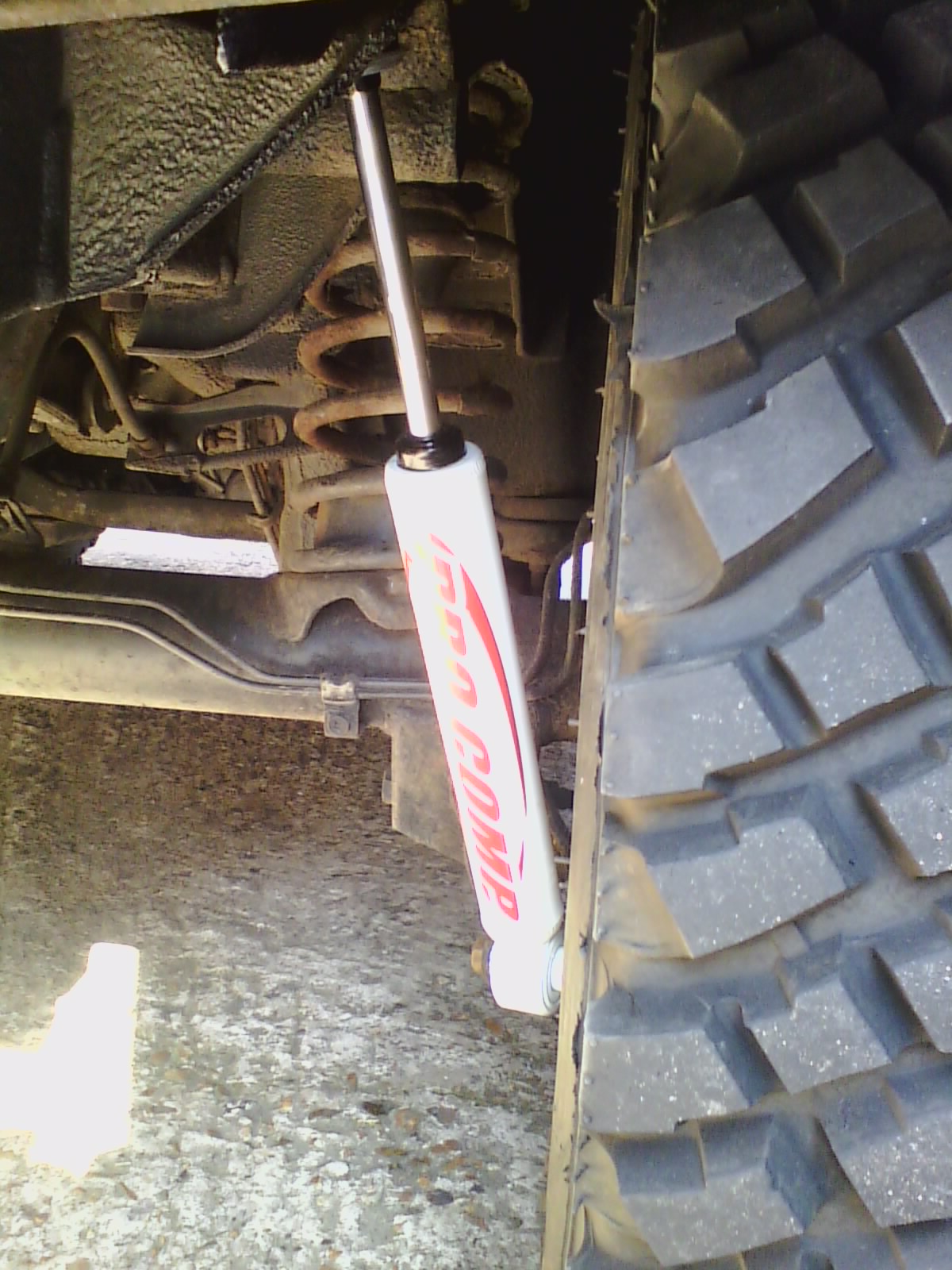

dan_2k_uk wrote:Scottie had some cheap shocks that seem to have worn well but I can't remember what they are.
Astra shocks, with the pins converted to eyes by welding on rings, right?
The other suggestion was Rav4 shocks. Someone with a shiney SJ fitted them, I just can't remember who right now...
Seen Rav4 shocks on the bay for £20 a pop. That's gotta be cheaper than ES1000's. Having said that, I have a set of ES1000's I knicked off a junker, I just haven't gotten around to fitting them to my SJ...
Re: Andy's LWB Zuke
Post by donkeychomp » Fri Nov 08, 2013 10:33 pm
How about a set of these. Don't be fooled, they are KYB shocks, £19 a pop.
Posts: 11709
Re: Andy's LWB Zuke
Post by ScottieJ » Sat Nov 09, 2013 1:41 am
Yeah mine are KYb astra shocks, they work well offroad but are a bit stiff on road in the back because of the lack of weight.
Rough country aren't that much better than pro comps but you can get them from llama4x4
One day I'll actually get around to ordering some bilstein 5125s from the US
