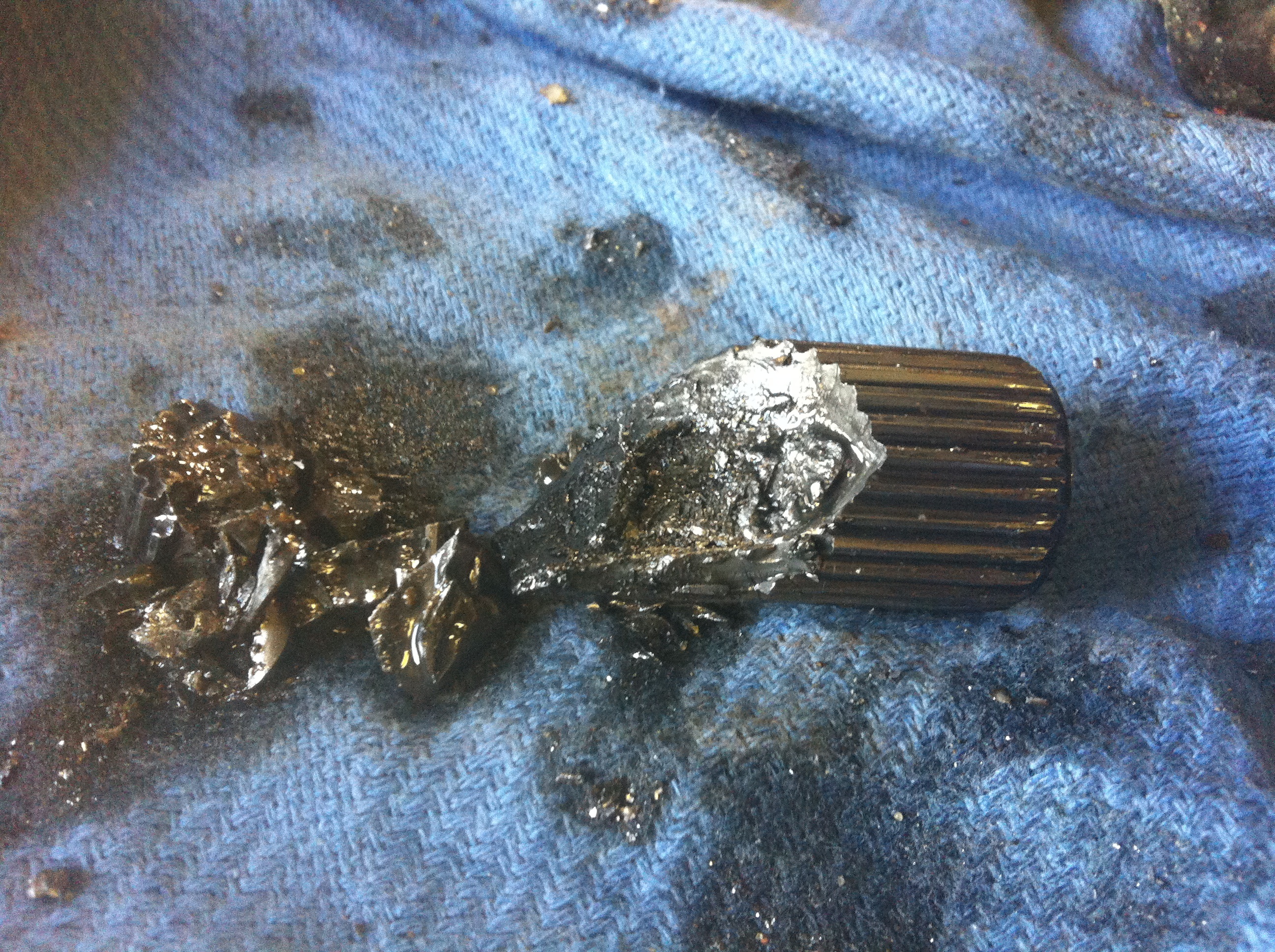

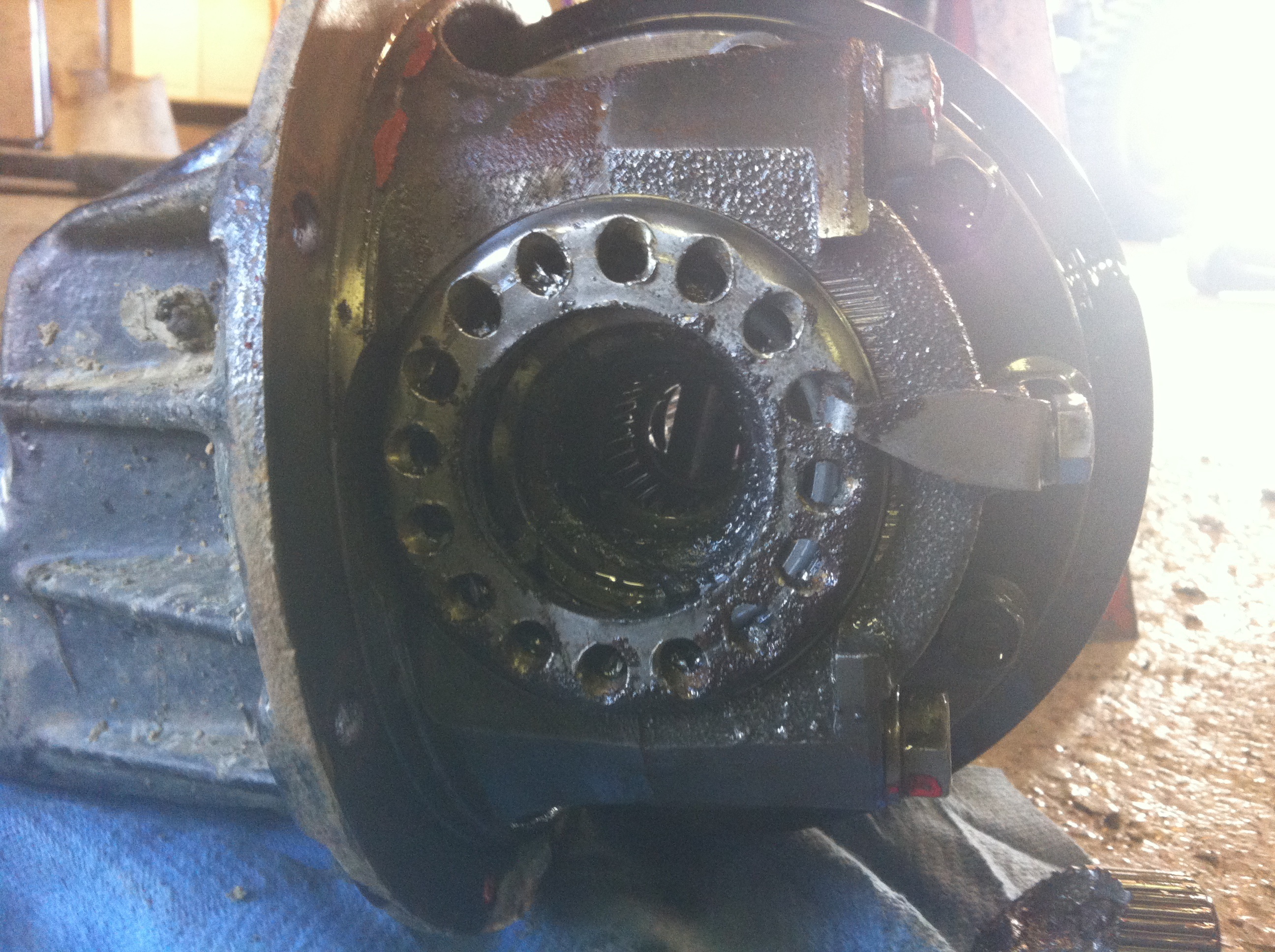

It's the diffs which don't last when the shafts explode Andy !!

Re: Full float rear
- image.jpg (1.54 MiB) Viewed 6025 times
- image.jpg (2.4 MiB) Viewed 6025 times
Re: Full float rear
The diff won't always get destroyed from a failing shaft, It's mainly if the vehicle carries on getting driven with the snapped shaft.
