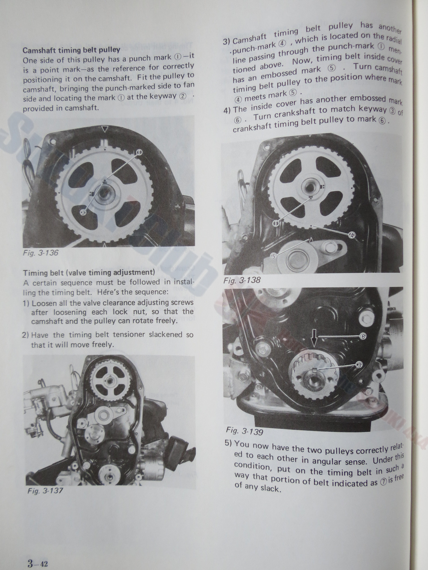

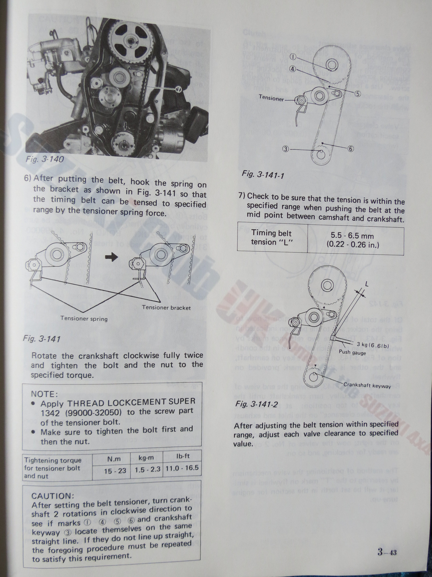

Re: Getting To The Timing Belt
Post by Darrell » Tue Feb 11, 2014 7:33 pm
From the 410 workshop manual.
I don't think many (if any) people bother to slacken all the valves off.
