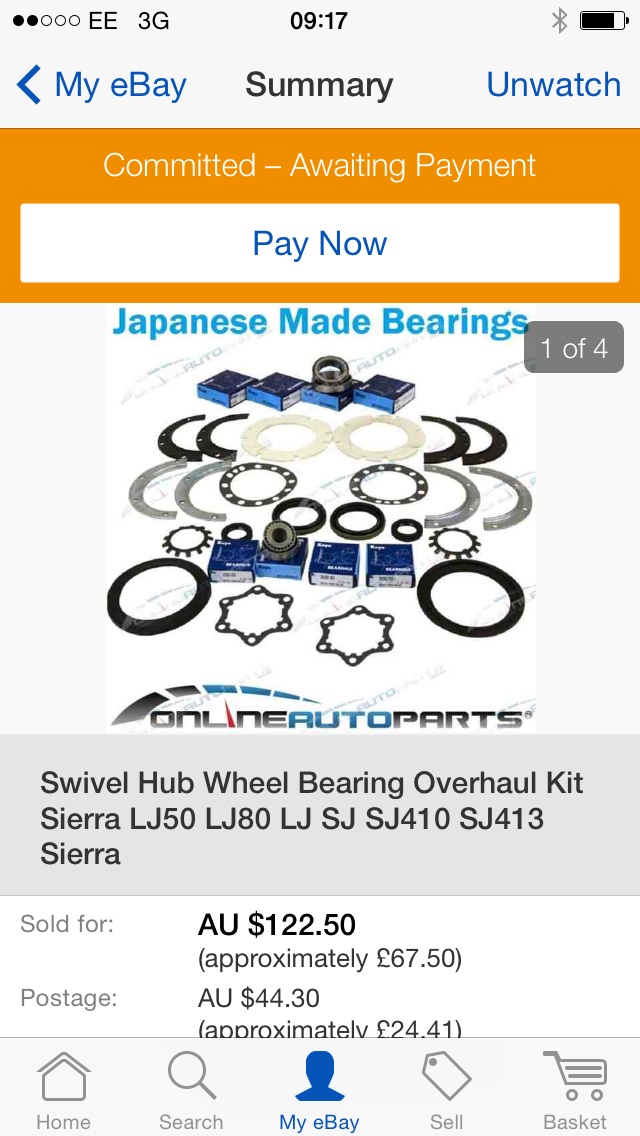

Post by Tramp » Mon Mar 24, 2014 10:22 am
......ordered :thumbup:

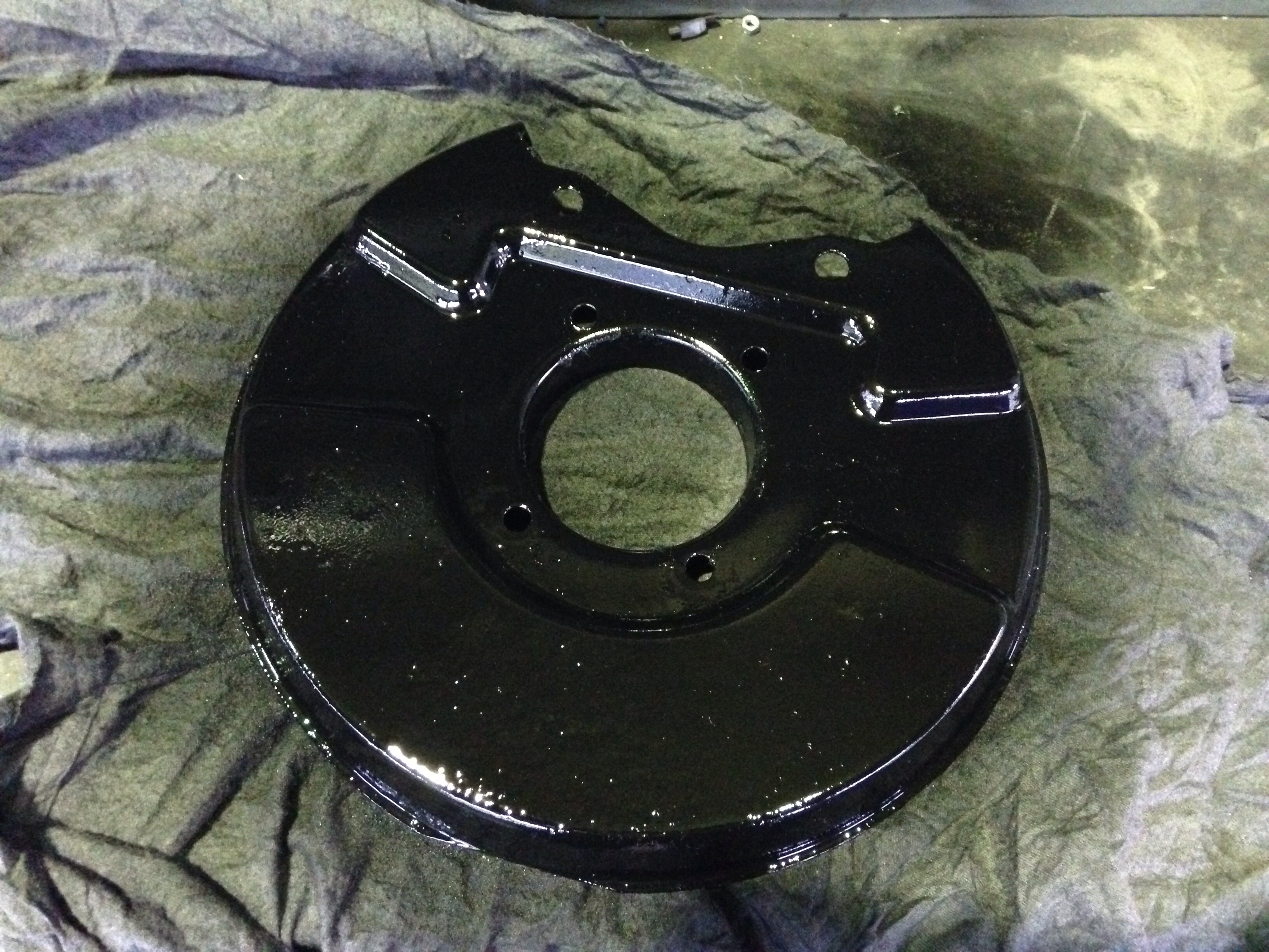

I've had a busy evening..........
Hopefully it will be dry by the morning so it can be refitted,

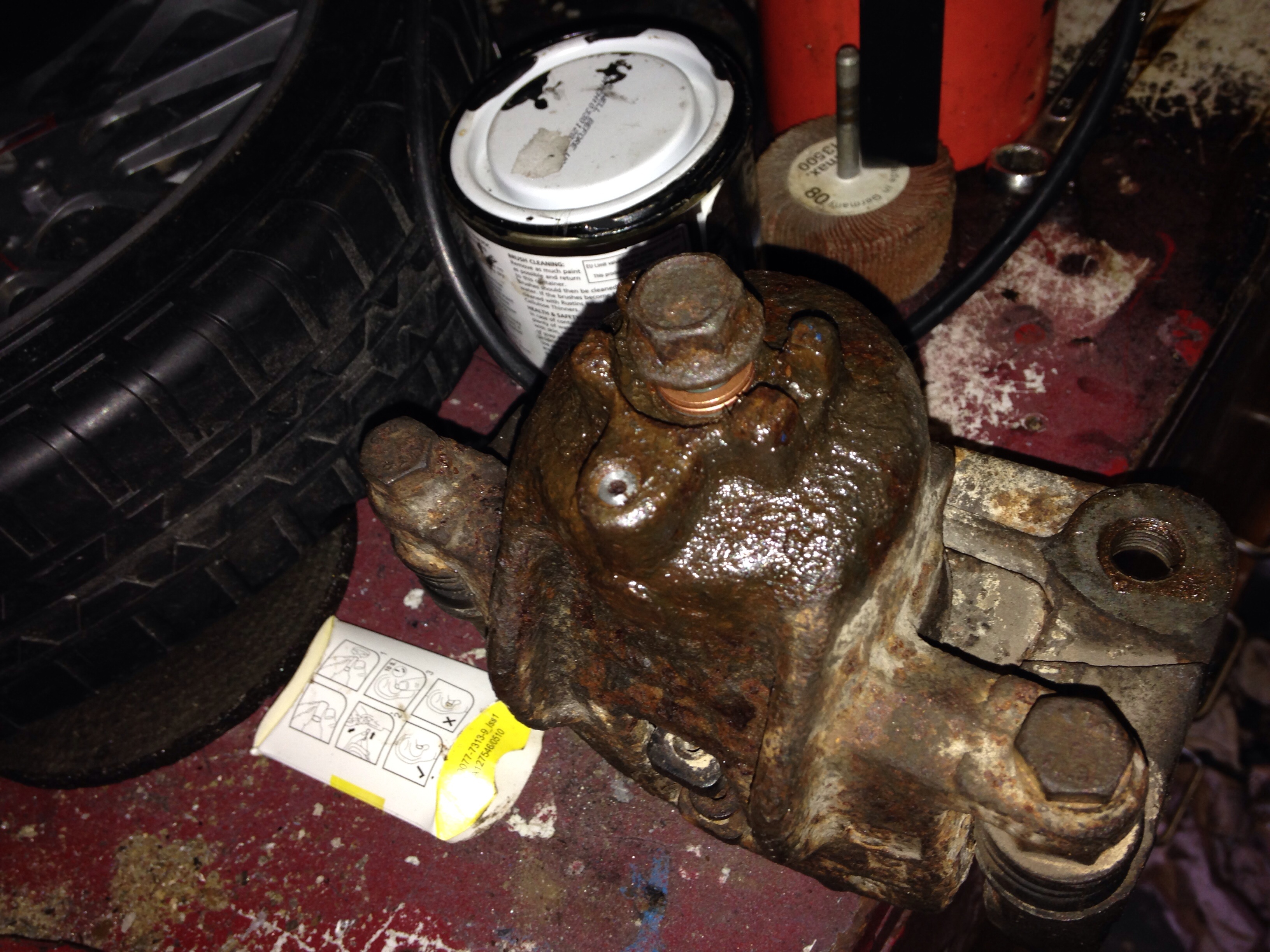

Another fun day, I fitted my new bearing assy and king pin bearings on the passenger side, I fitted new brake hoses too but suffered a small issue
What are your thoughts on this? Drill it out and retapp it? Or do I need a new caliper? The drivers side bleed nipple is just as reluctant to be removed!
Re: Tramps Truck,
Post by ScottieJ » Sat May 31, 2014 8:43 pm
Nice work! Will be awesome to see your Sk back on the road!
As for the nipple you could try a stud removal tool. http://www.ebay.co.uk/itm/110868152075

Post by Tramp » Sat May 31, 2014 9:57 pm
