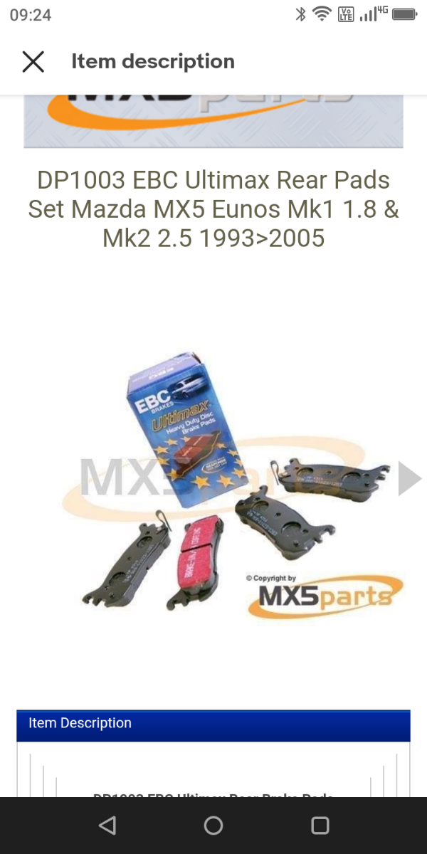

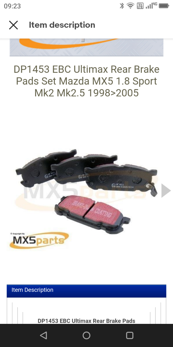

Theres 2 types of 1.8 rear caliper from 1998 to 2005. A 251mm and a 276mm disc version.
I have used a 251mm version without realising but its working better than any handbrake set up iv had before and better than my friends jimny with rover 600 calipers.
A 276mm version should work even better with more pad to disc surface area.
The first picture is the 251mm pads (distinctive pad design)
The second is the 276mm pads

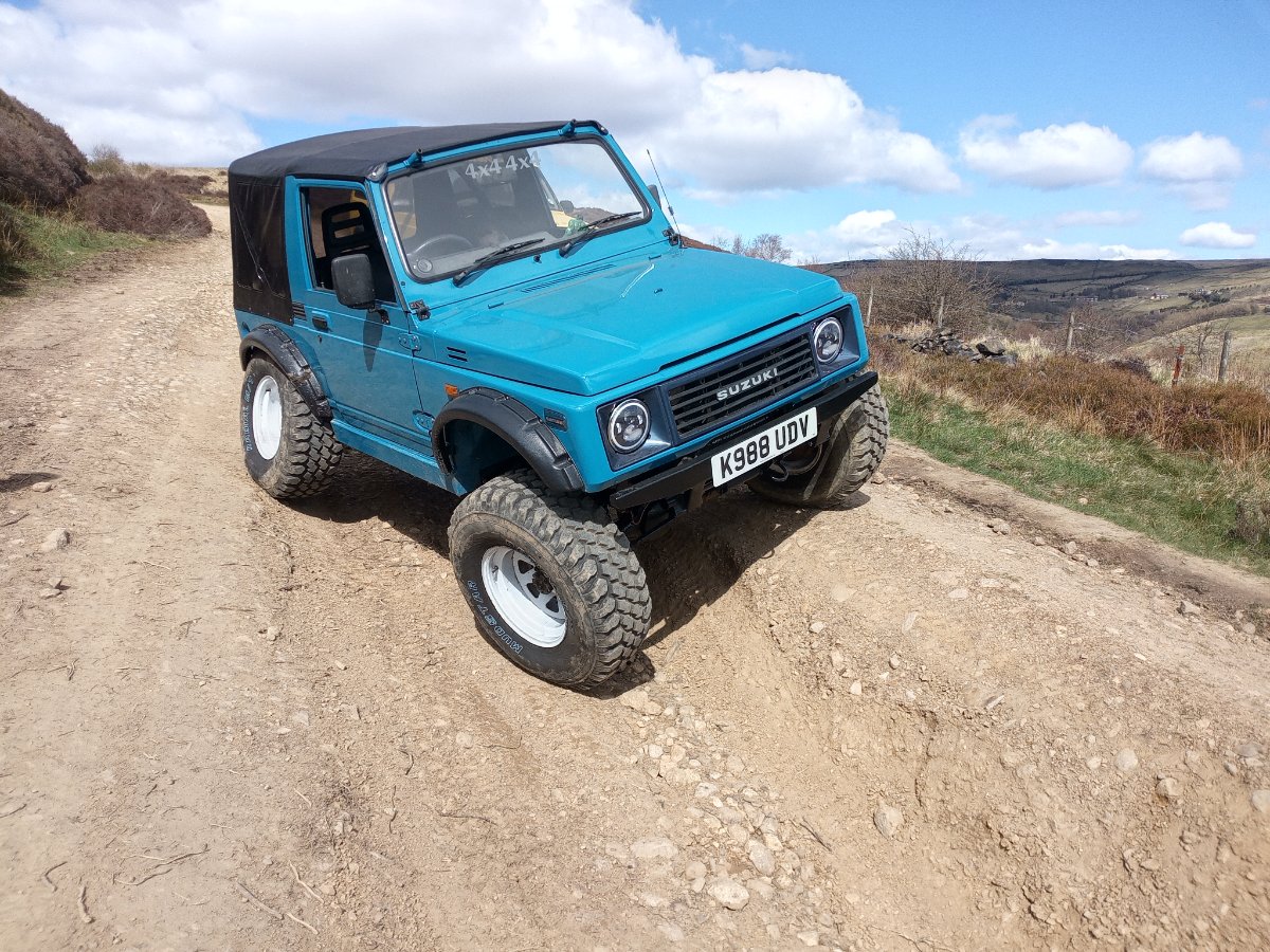

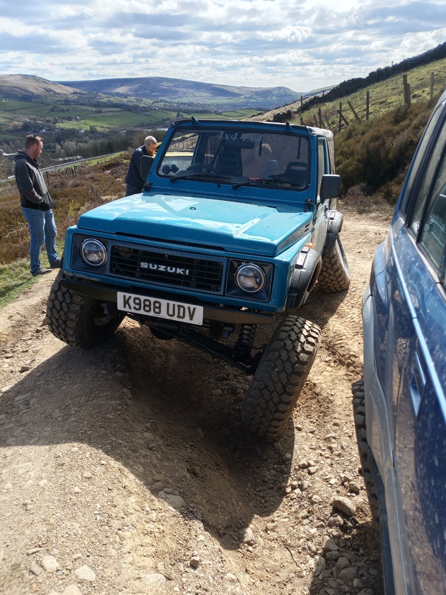

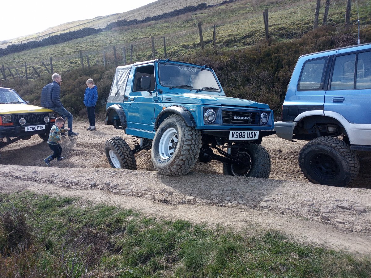

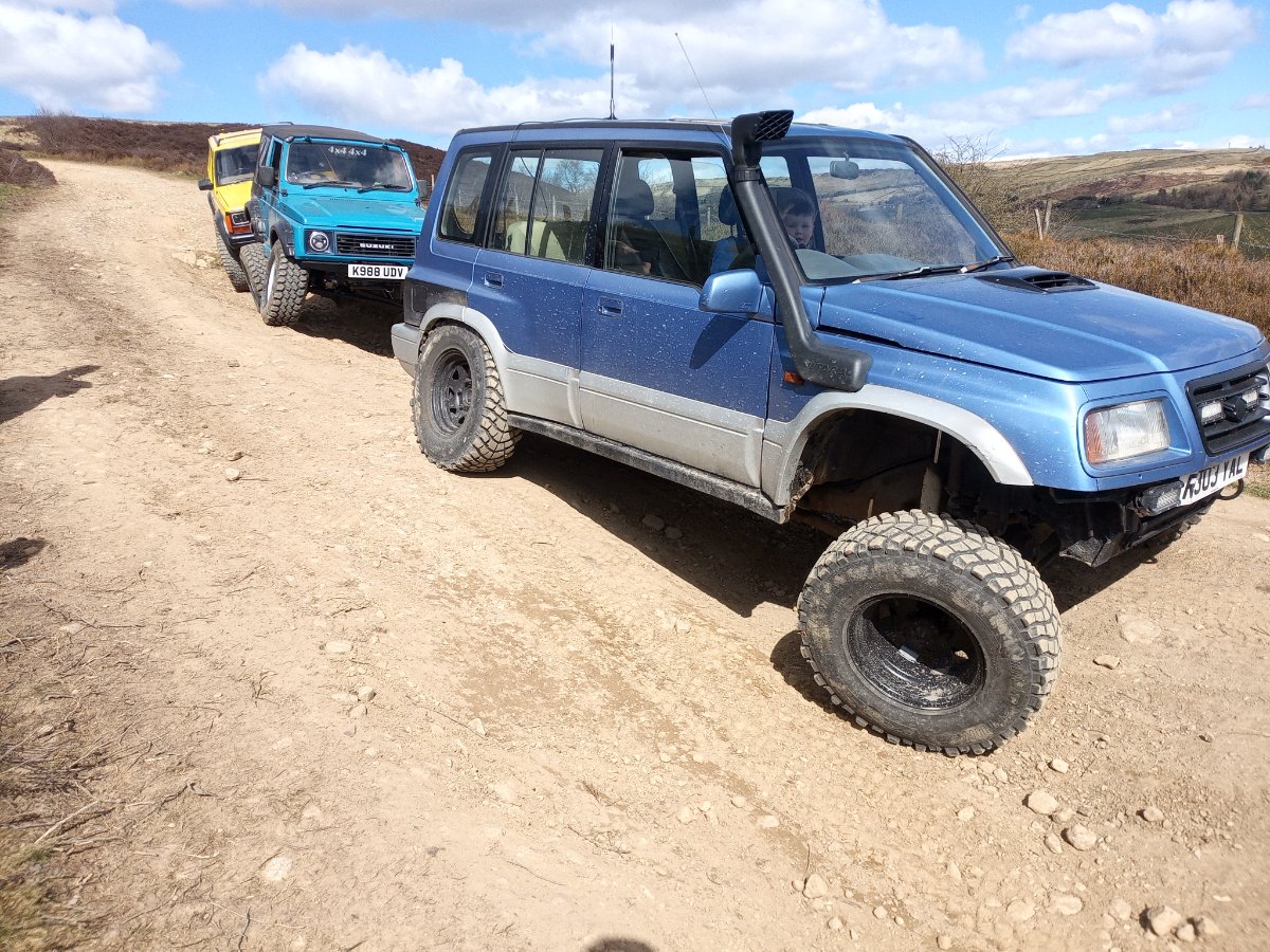

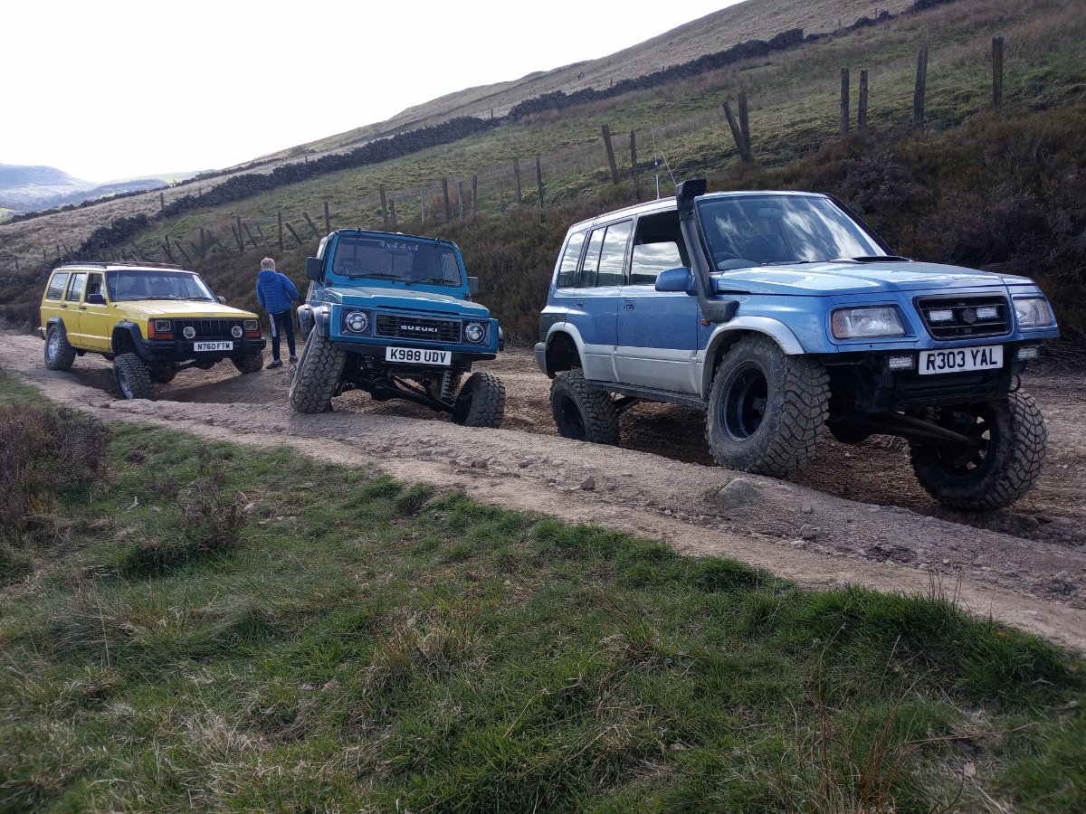

Today was the first offroad outing and excell it did. Its completely different to how a leaf sprung handles the offroad. I was a little concerned that on full flex it wouldnt have enough pressure on the ground to grip but i have a video showing otherwise! Couple of pics

Post by donkeychomp » Mon Apr 05, 2021 9:31 pm
What a great little truck. You've done a cracking job mate.

Post by d_r_1989 » Mon Apr 05, 2021 10:38 pm
Thank you, not quite finished yet but very happy to test it in the real world

Re: Coiled turqoise samurai
Post by Jordi » Thu Apr 08, 2021 3:17 pm
You do know someone was following you in one of those american 4x4s?

Jordi - :hahaha: it used to be mine for a brief period last year. We had just taken the anti roll bar off to see if it could actually get anywhere, compared to my white sj its pityful, let alone the turqoise one!

Post by stimpy » Sun Jun 27, 2021 9:42 pm
This looks bloody brilliant mate. Job well done!!
The only thing I noted was the rear brake lines on the back of the axle - if you were to do any serious off roading in it id be wanting them above the axle... That said, a branch can get anywhere if one gets it wrong!...

Post by d_r_1989 » Tue Jun 29, 2021 11:08 pm
Thank you very kind!
So far other than them lanes she's been a tarmac princess so the brake lines aren't an issue! I really do need to get her muddy more. Surely there's a Suzuki club UK green lane event overdue.......... 😁
