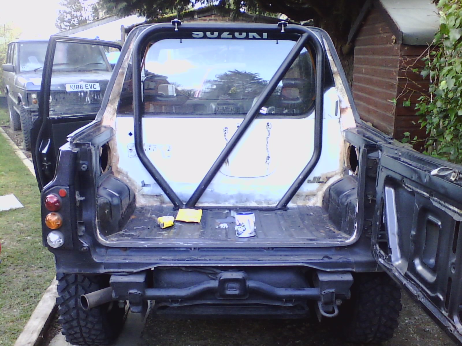

Not to sure on the last pic from inside the range rover, you could have not included the steering wheel haha

Did that on purpose...wondered if anyone would notice.

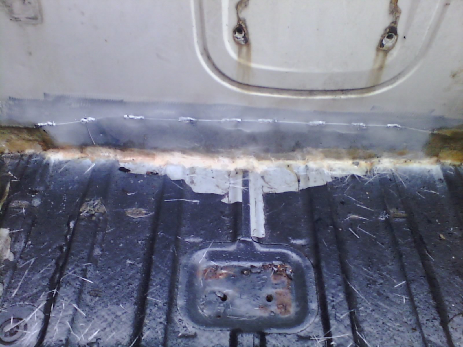

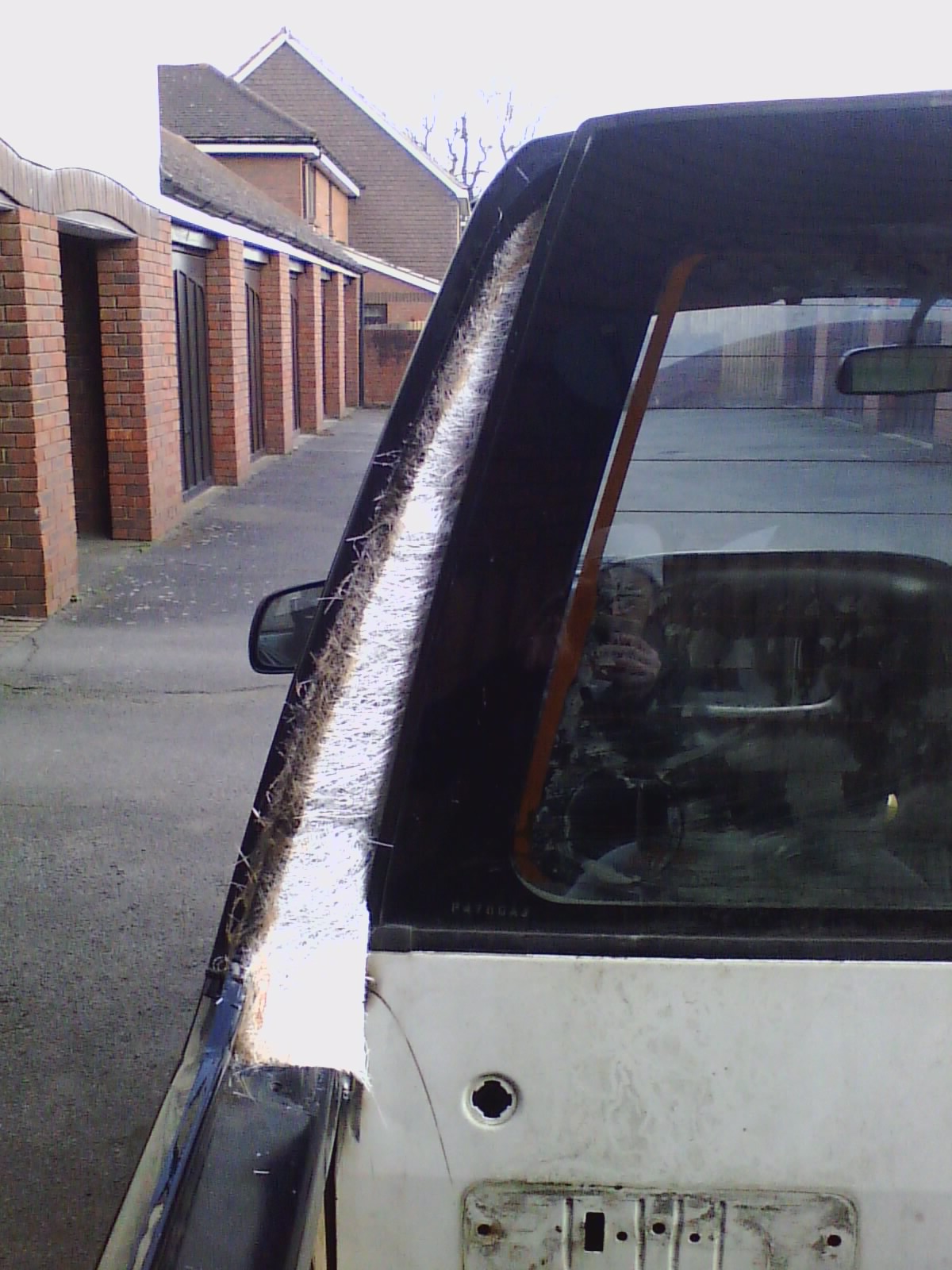

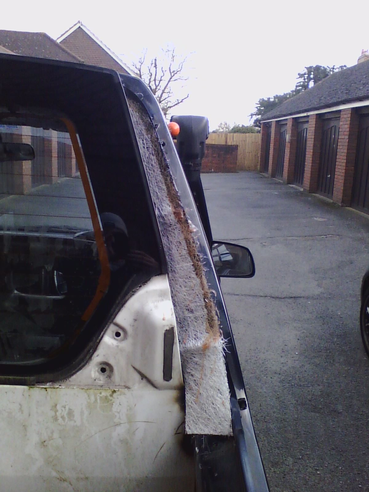

Got some more done today, using the ever popular CAD method. Started the fibreglass and then ran out of resin doh!

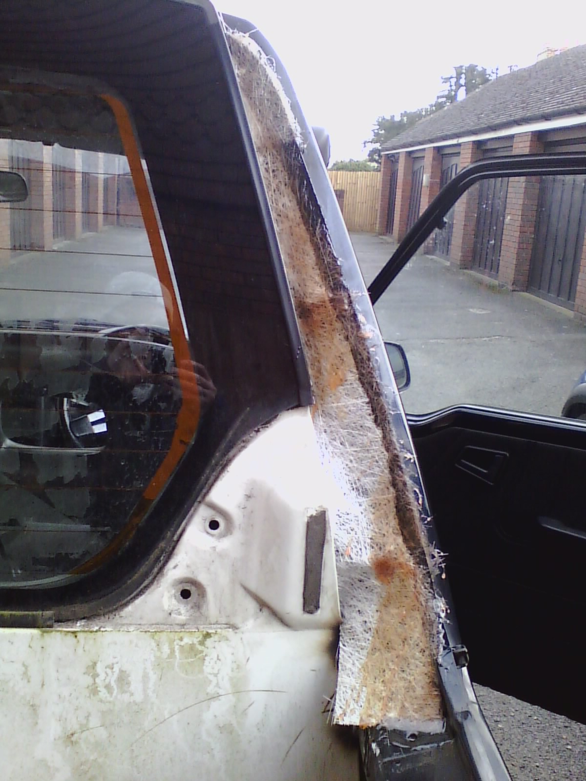

Post by donkeychomp » Mon Feb 24, 2014 8:56 pm
All watertight. It doesn't look pretty and it doesn't need to as it'll all be hidden by an alloy plate.

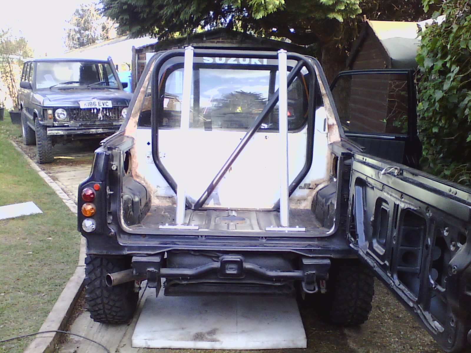

Off on wednesday to my mate's place to get the tub lined in ally. Oh and the roll cage will be going back in...but beefed up!

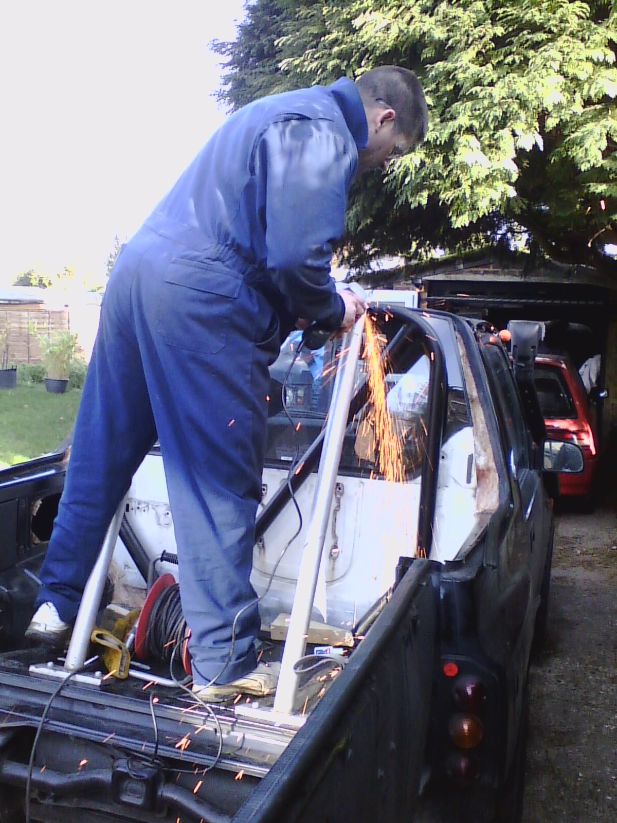

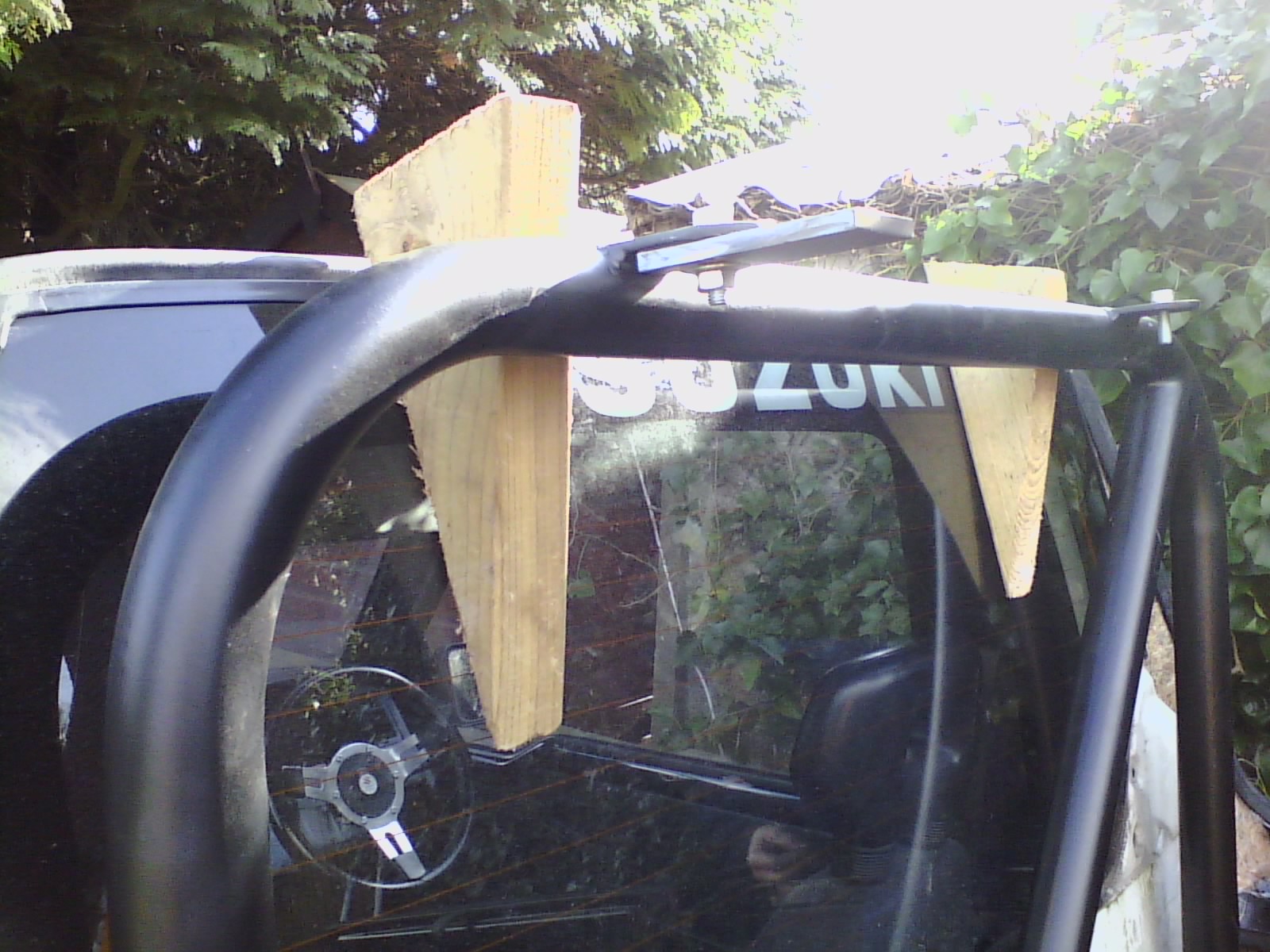

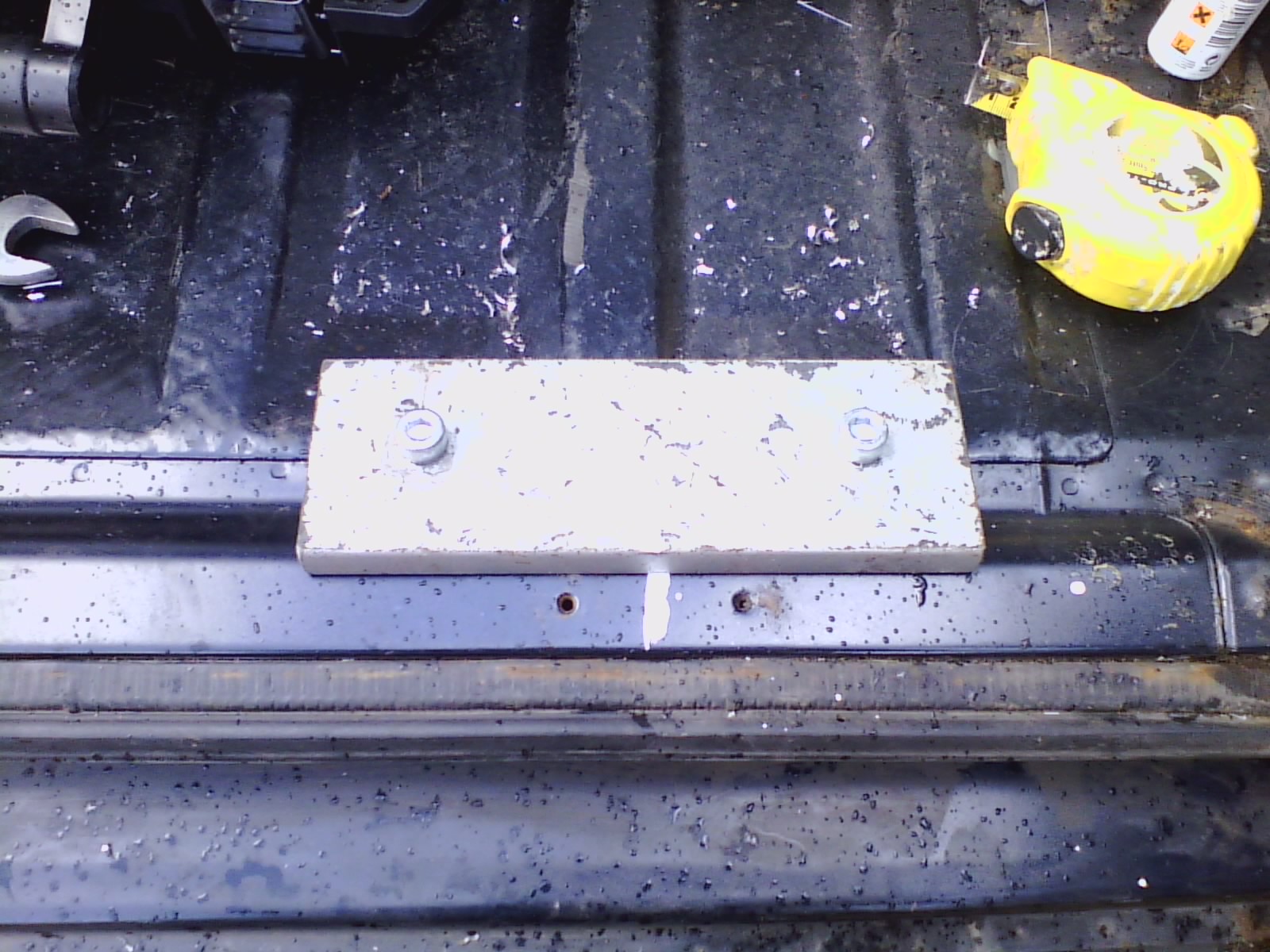

Well, we managed to get the cage extended and in. Four mounting brackets were made out of bloody thick steel, these were bolted to the top of the original cage and the floor. The two bars were then welded to the brackets. It is rock solid, just hope I never have to test it in action!
I'll take it out this weekend and get it painted. I think it looks pretty funky..
using CAD (cedar aided design)
the floor brackets
the floor brackets
measuring the old cage up

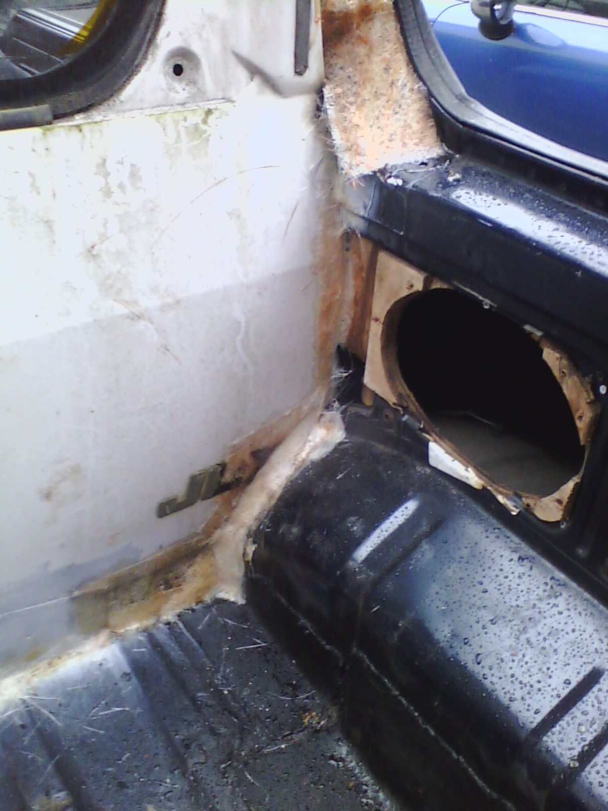

The holes in the back where the speakers where? They are coming inside the cab, 2 behind me and 2 in the dash. In that little space that's enough!
