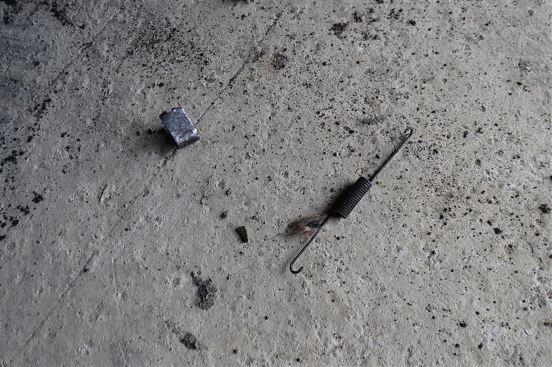

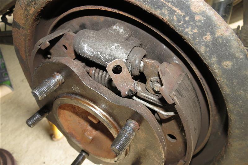

The reason for my delayed departure on Friday:
This bit is what is left of one of the brake shoe retainers, both had gone missing:
These bits fell out when I took the drum off:
Given the almighty bang when it went and the subsequent loud sound of metal grating on metal I was quite please to find that it was something quite simple to fix. I put a couple of universal retainers on there and manually adjusted it up until I can get a replacement adjuster ratchet 'pawl'.
