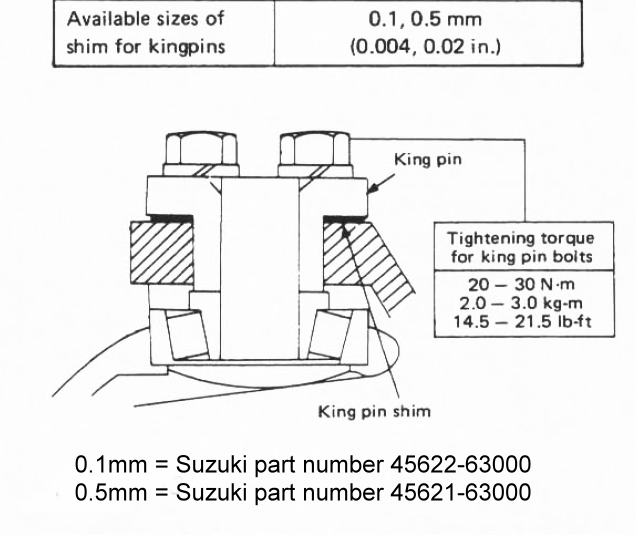

Thought I'd better post something :D , Torque settings and shim numbers (even if they are on the other diagram :oops: )
I won't bother with the preload, I doubt any of us go through with that bother :er:

Still need some kingpin shims and also one or the stepped bolts that goes in the knuckle seal retainer if anyone can save me a trip to suzuki it would be appreciated.

Dan come visit my workshop at the weekend and ill sort you out some shims and the bolts ;) anything else you might need? I really need to clear out some of the Suzuki parts store I seem to have hoarded over the years :lol:
