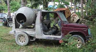

In other news..... the gearbox is like a cement mixer!
Could be worse :D
