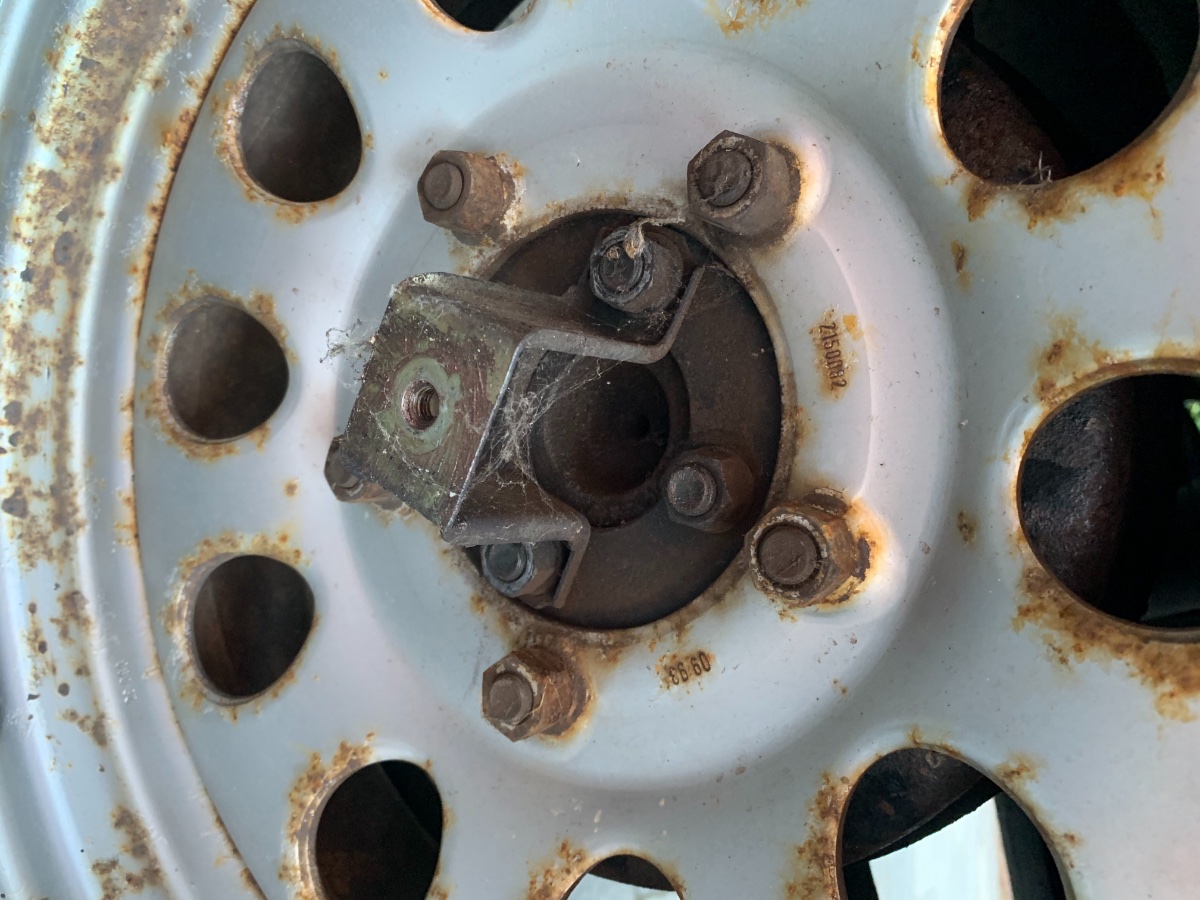

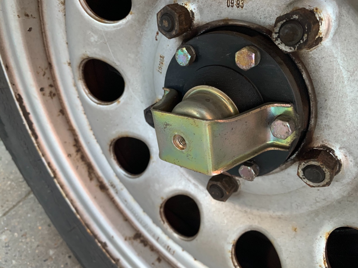

Guys, see attached pics of what's under the plastic caps front (new looking one) and back. What are these exactly and if they're not autos do I need to reverse every time I take it out of 4wd into 2wd or is that unnecessary?

Post by Jordi » Sat Aug 08, 2020 5:27 pm
Unnecessary to reverse.
If the 4wd lever is in 4wd, you are in 4wd.
Move the lever to 2wd and you are in 2wd. Simple as that. Don’t need to drive it forwards or backwards.
The front is just a fixed drive flange in constant mesh with the half shaft. If you undo the bracket for the plastic cover and pop off the little domed cap you’ll see the splines on the end of the shaft.
The rear is just the end of the half shaft.

Post by SMITHEREEN » Sun Aug 09, 2020 2:09 pm
Thanks Jordi, it’s all making more sense now
