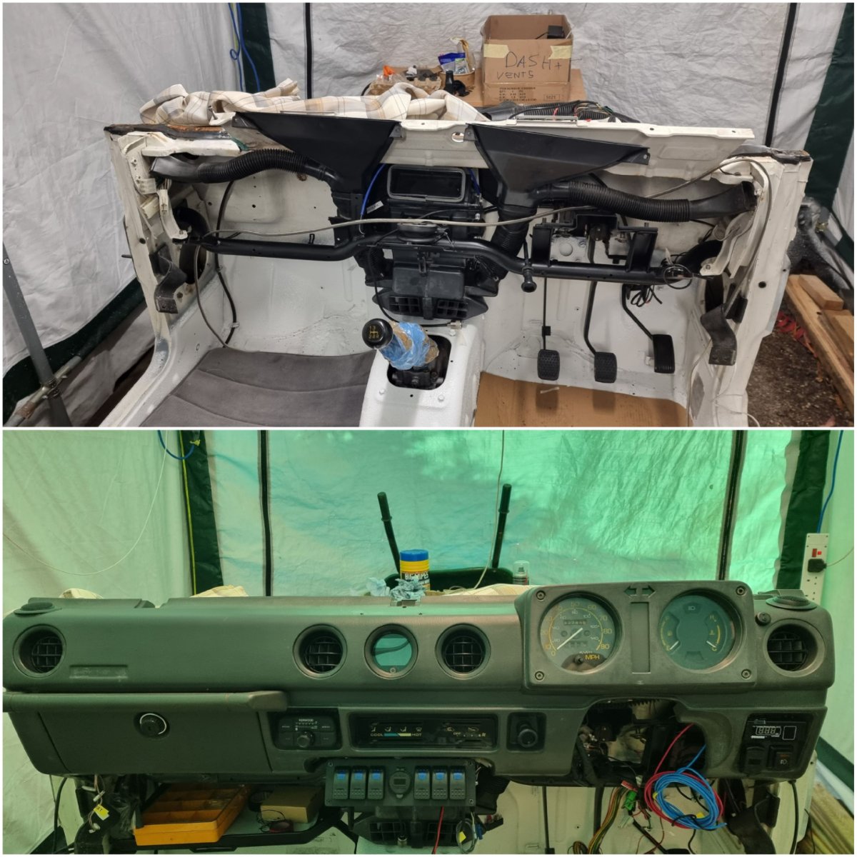

Lots of new parts were introduced, new wiring, new fuseboxes and all time consuming but a great puzzle for over the winter months.
Dashboard back in, out, in, out and in again. Electrical testing completed, after solving strange ground faults and broken 4x4 & reversing switches, all sorted now.

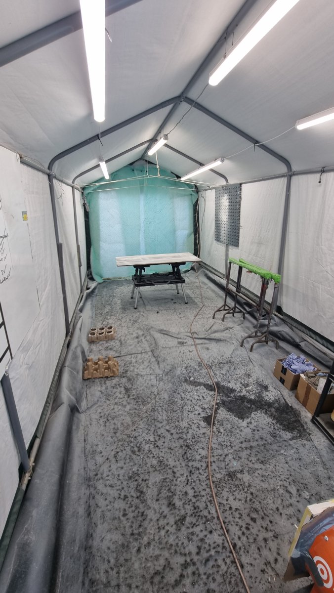

Update time!
I'm making good progress, amazing!
Briefly..!?!

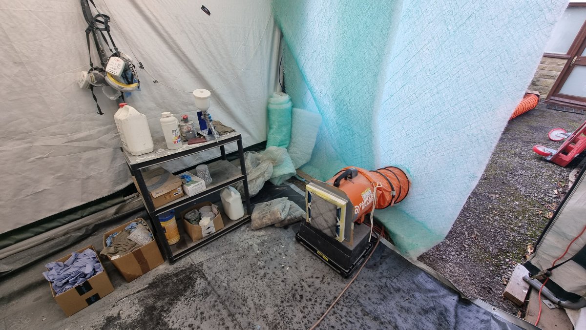

Create a 'Blue Peter' spray booth in the Clarke CIG81020 garage, complete with carbon filter extraction.
This worked out really well, and the dust and bugs were almost nonexistent.
Also installed an extra 4 led 6 foot light fittings.
The light level is 'brilliant' and well worth the £60 for the 4 light fittings from Screwfix.

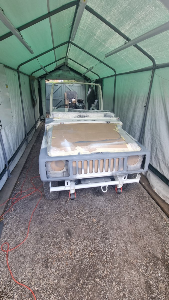

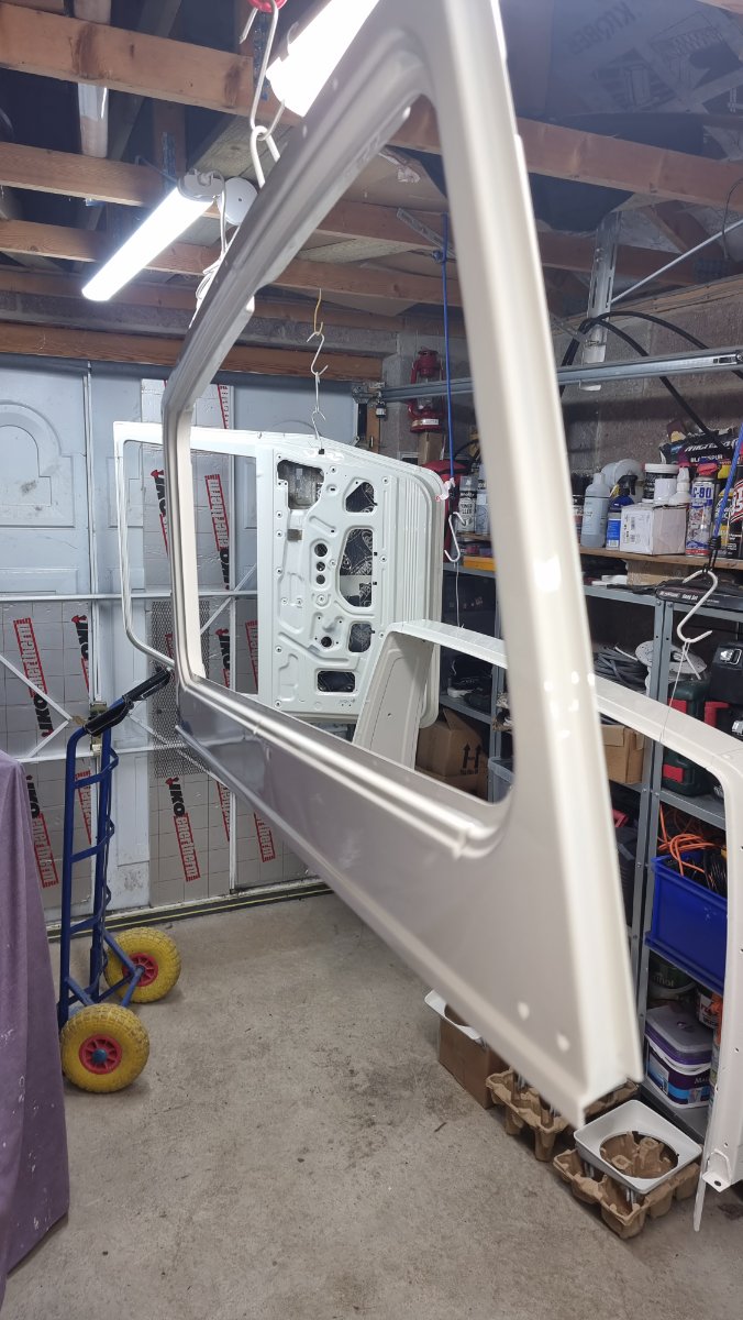

Then, fitted the front end back on and started preparing the bodywork for spraying.
There were quite a few dents and scratches.
I suspect that the bonnet was used as a temporary shelf for transportation of bales of hay, it was covered in a variety of gouges and scratches..!
I managed to pull the dents back out and set about the panels with wet n dry grit paper, which varied between 120 - 2400.
Hours/days of laborious rubbing down (no fingerprints left!) prior to the Primer build layer.
Then more days flatting back prior to the 2K top coat.
I used Suzuki 17A which was the original colour, which has turned out really nicely in the Blue Peter booth.

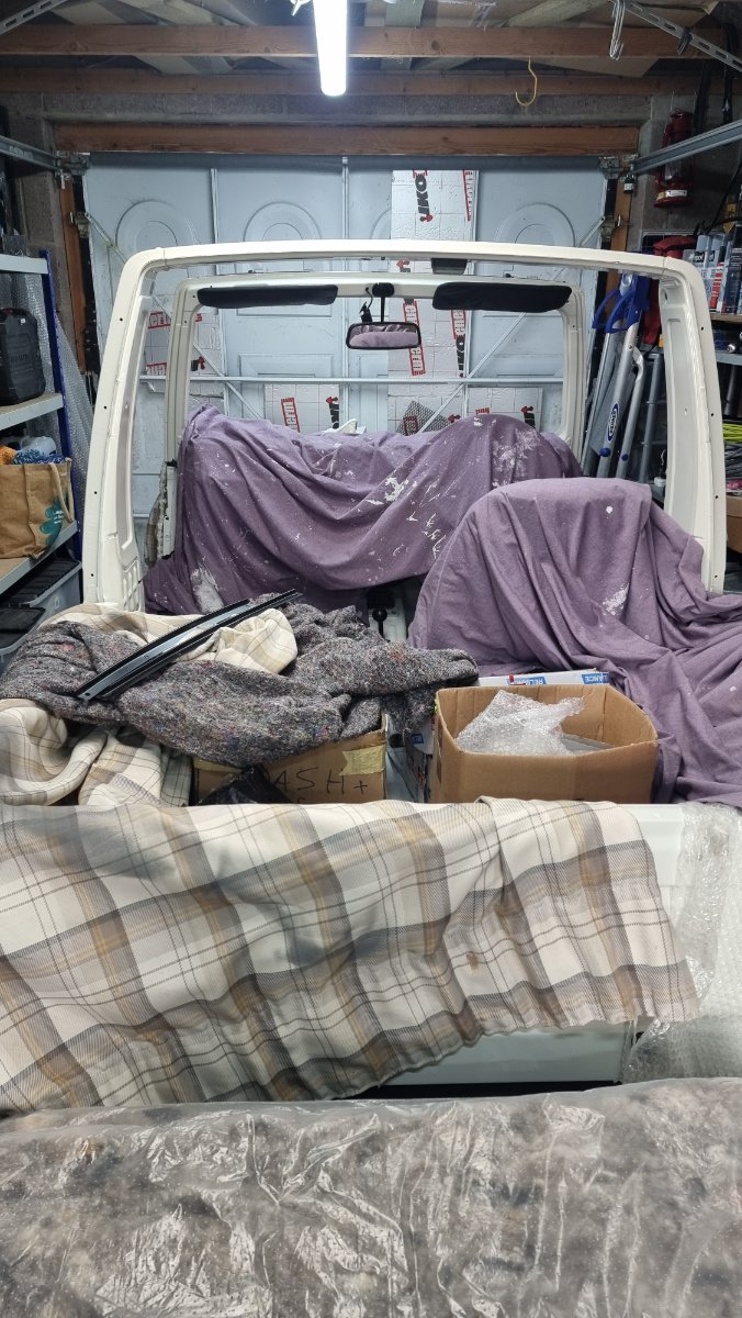

I then decided to move the SJ to my 'brick' garage. 2 reasons:
Firstly, to clear the Clarke garage to be able to spray the bonnet, tailgate, windscreen surround, doors, B pillar and a few odds and ends.
Secondly, the brick garage is warmer with the diesel heater and easier access to tools/parts etc.

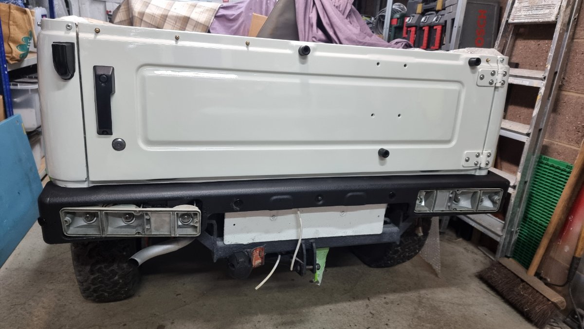

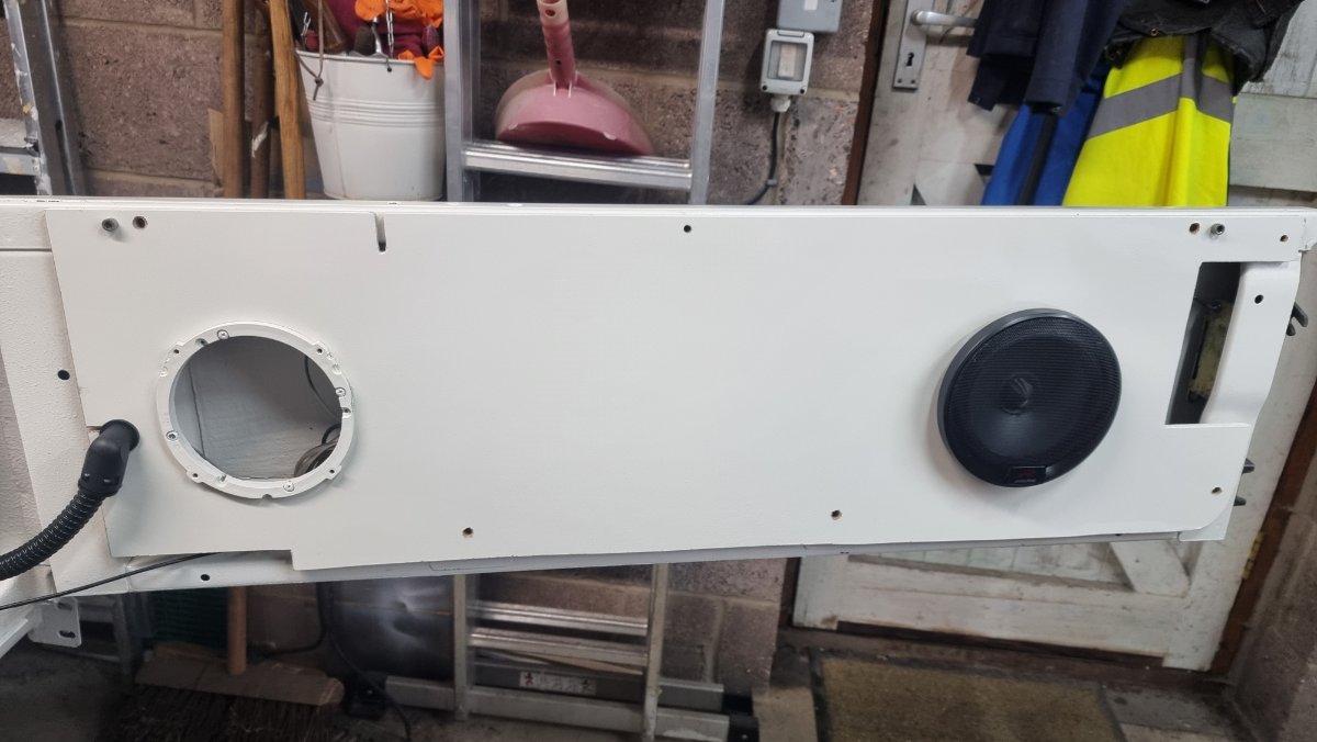

So, since then I have started working from the rear, reinstalled the tailgate, the rear bumper, lights, new tailgate speakers, new rear bumper sensors, manufacted a pair of rear side cards with auxiliary 12vdc outlets, and installed the CB antenna mount!

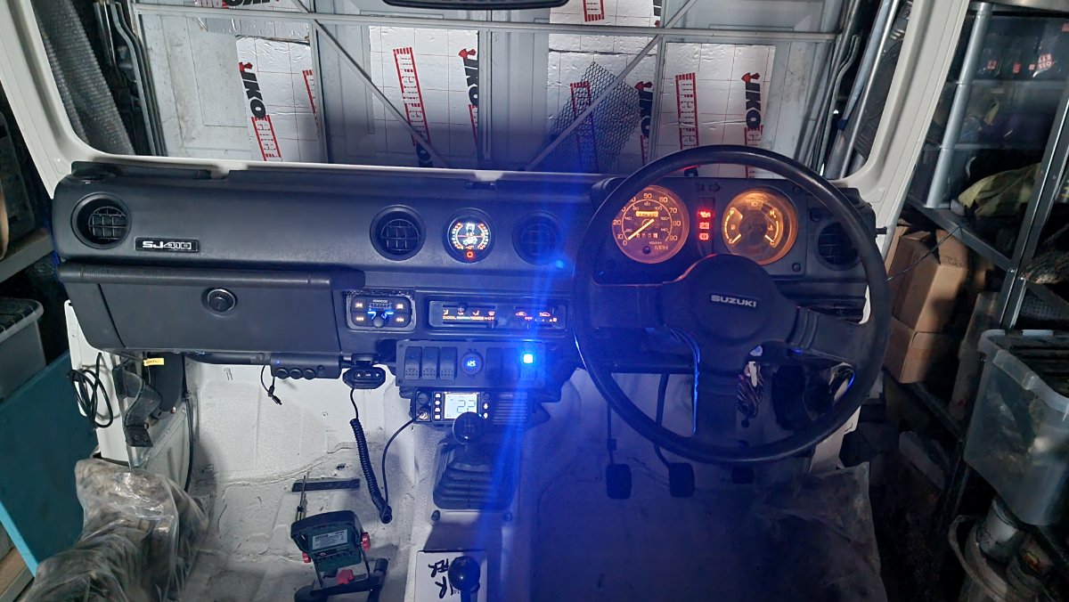

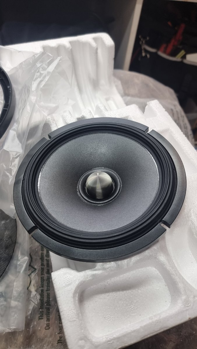

I commissioned the Kenwood KAC-M5024BT and fired it up via the Alpine RS-65C speakers, with the inphase sub woofer, it sounds awesome 👌
I'm currently working on commissioning the dash cameras and also the reversing sensor system and I hopefully will have this done by next week 😅

My Suzuki equivalent of Christmas 🎄 lights 😁

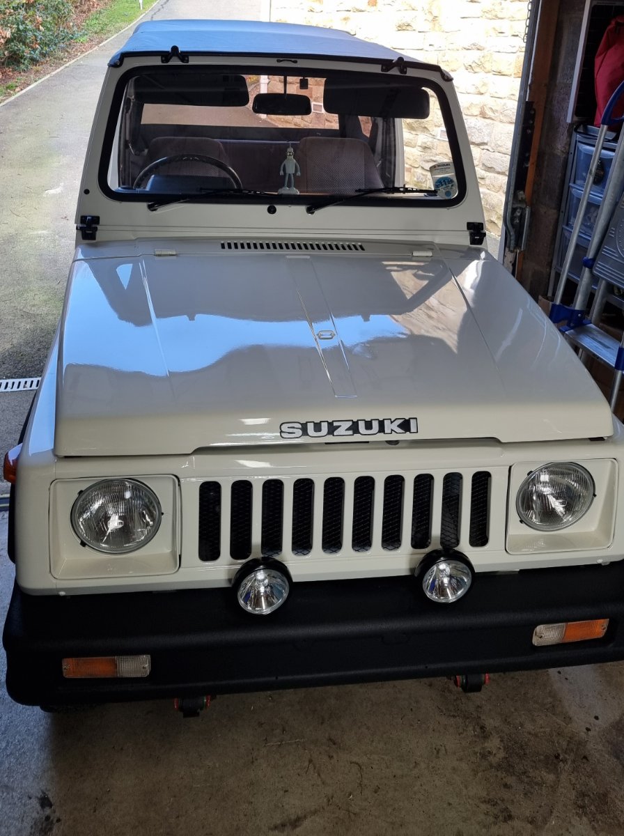

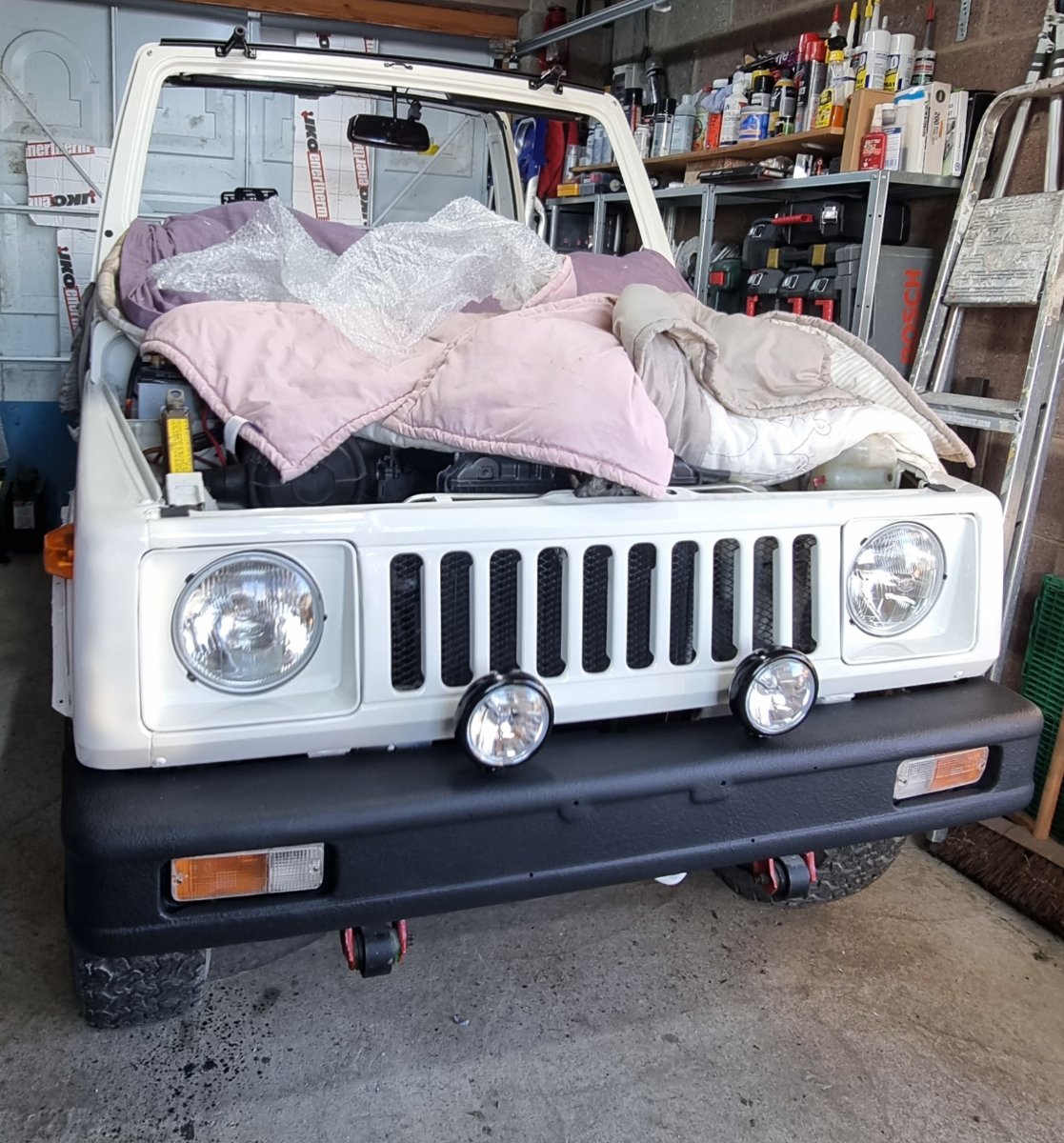

Not a bad days work, install indicators, new spotlights onto freshly sprayed bumper, then trial fit the bumper. Also reinstall headlight surrounds. It's nice to see a 'face' again after nearly 3 years!

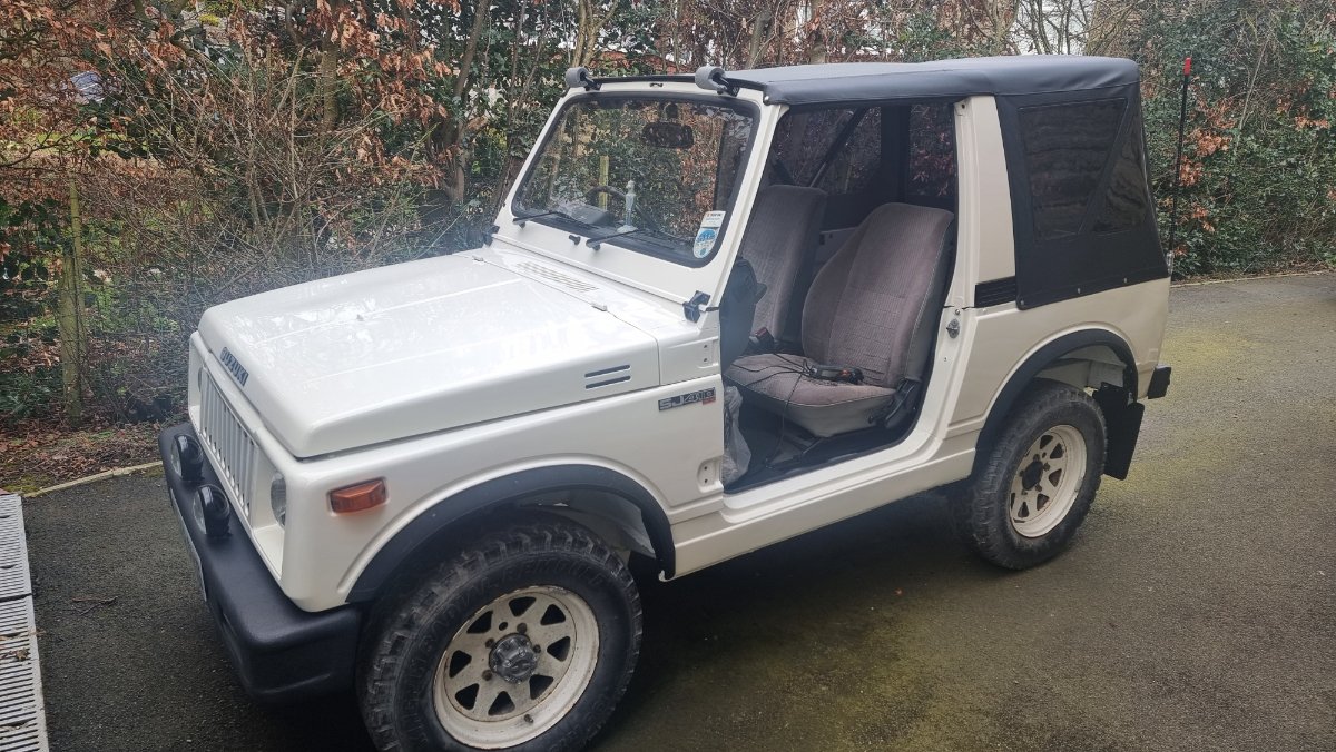

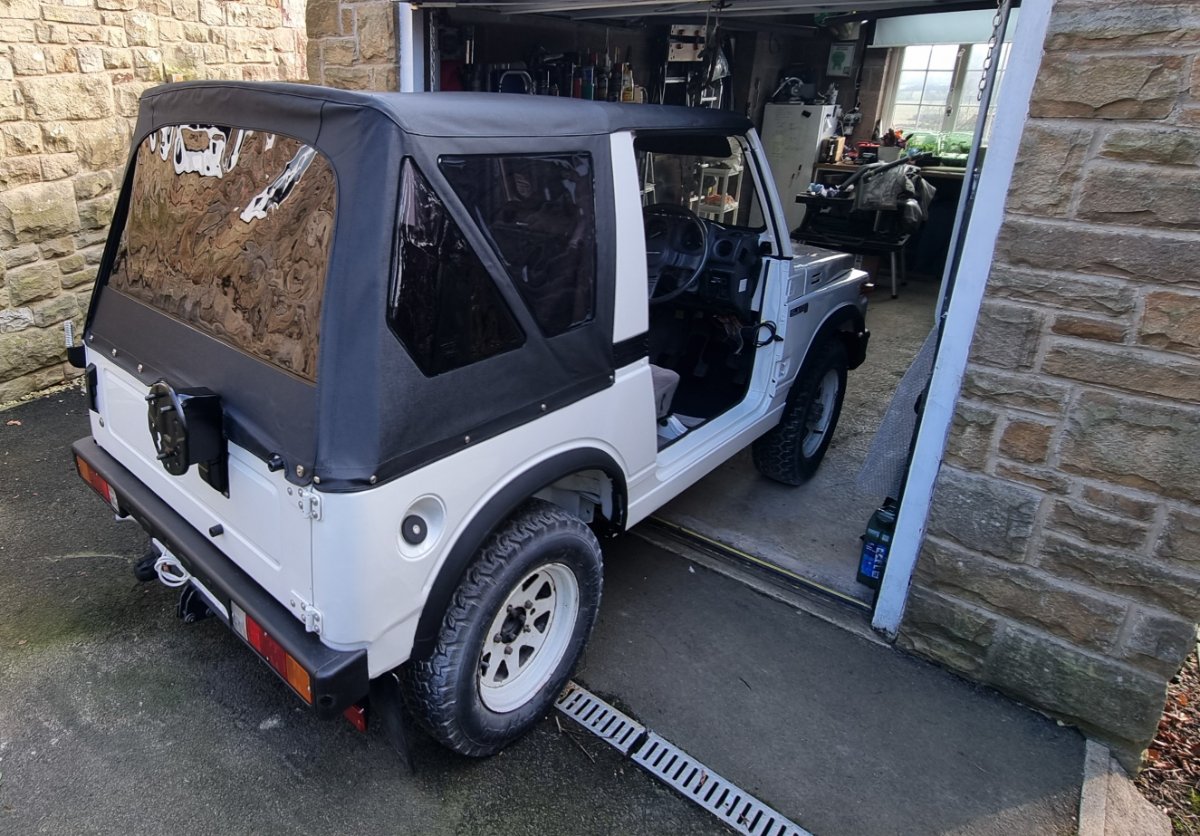

Post by Flumps » Fri Apr 11, 2025 9:00 pm
Getting closer..
:hmm: I can tell because I'm starting to run out of parts to put back on!

It's been a long haul, but I'm starting to finally see the finish. Hoping to MOT sometime in May.
