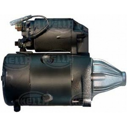

mk1joe wrote:hi, ive wired up the new coil with the black/green wire but at the starter motor end it is disconected and im not realy sure where it goes. could anyone tell me where abouts to connect it or maby even a picture?
cheers
joe
The black/green wire should also be going to the starter motor, and connect to the same terminal as the thin wire
(thick wire is 12v main start power, thin wire just activates it)
Re: engine cuts out
Post by Darrell » Mon Dec 12, 2011 7:11 pm
If the black/green wire was connected to the same terminal as the black/yellow (thin wire) the starter motor would run continual. The black/yellow wire has a diode inline to stop this. I really don't see why the black/green is there at all. I also found this pic when I seached for a 410 starter, it shows where I assume the black/green wires goes. But both wires seem to be doing the same job. Bloody suzuki no wonder I've lost most me hair :bawling:
