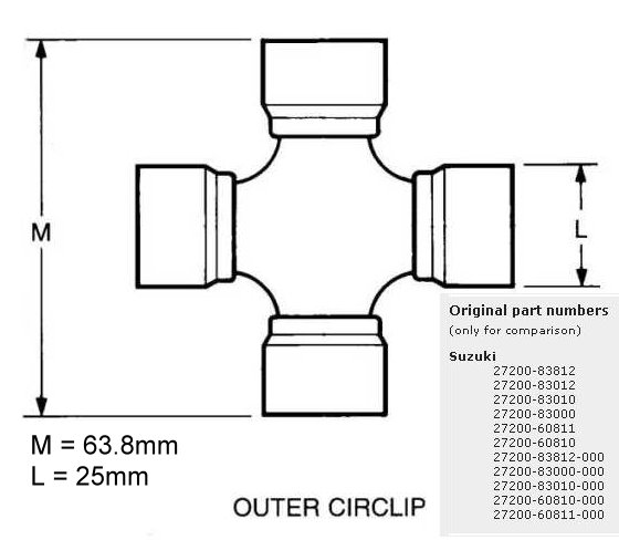

Darrell wrote:There's some info on th UJ's in the "stickies" that suspiciously looks just like the info I put on Difflock years ago :poke:
http://forum.suzukiclubuk.co.uk/vi ... 12/t,2250/
There's generally 2 different sizes 23mm or 25mm cup sizes.

Where abouts are you Chris, I have new UJ's sat on the shelf (25mm ones). I only paid a tenner each for mine direct from my works bearing dealer. White box one's that I thought no way, but he assured me they are good and that many of the well known brands re-box them. Well I fitted 4 a couple of years back and they seem fine.
