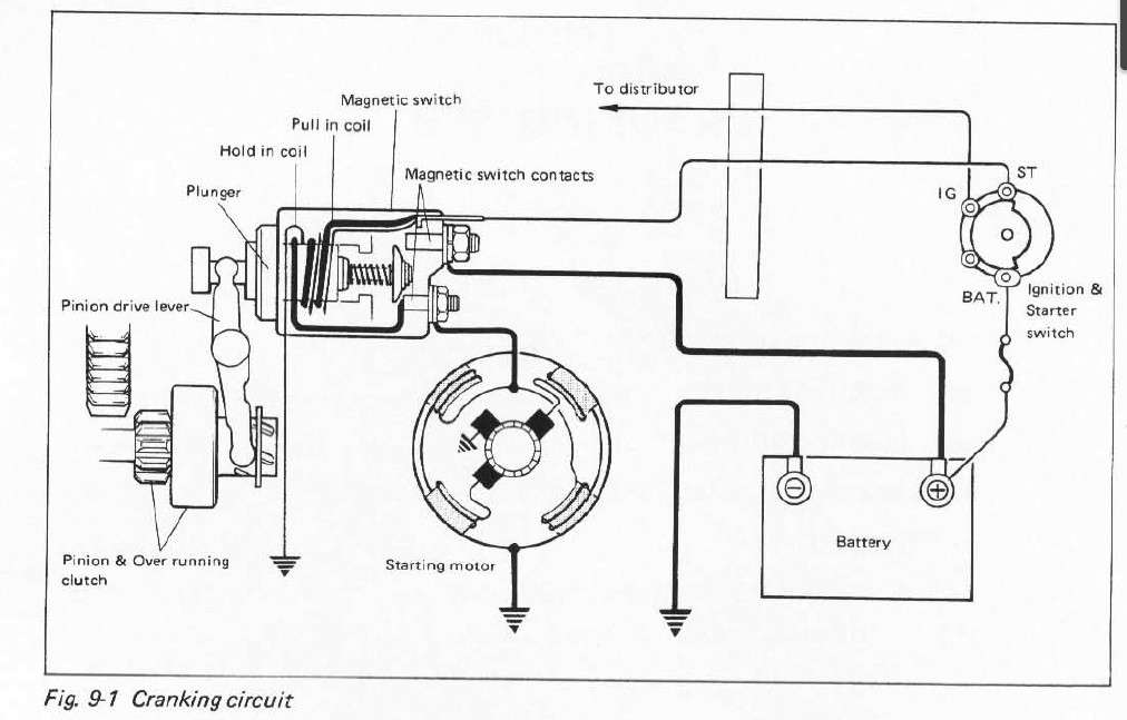

Think Ive found the problem.....It would seem that when the bendix gear is stopped with something (i.e. a flywheel) the motor just spins.
Basically I hooked the motor up sitting on the side and when I put power accross the solenoid it started to spin up, so I stuck a spanner against the bendix gear and it just stopped, while the motor continued to spin up.
No wonder it cant turn a flywheel!!!
EDIT: I cant understand why the motor spins with just the solenoid being powered on the small spade connection? It seems to spin the opposite way to what I would have though it needs to, to turn the engine. Maybe Im just being dozey

Re: Few questions about 1.6 conversion
The starter solenoid has 2 coils in it, one goes direct to earth (hold in coil) and the other goes to the motor winding (pull in coil). This will make the motor spin with just the solenoid powered.
And before anyone asks why is it like this I haven't a bleeding clue
, I thought it was just the one coil to earth
I had the same problem with the one way clutch on mine once and couldn't get a spare clutch anywhere and ended up buying a recon unit.
When I was a lad (only 20 years back
) you could buy the starter parts separately and fix them yourself. Now everybody just wants you to buy new or recon.
- starter motor internal wiring.jpg (135.16 KiB) Viewed 7097 times
Ah ok, thanks for clearing that up mate!
I guess that means my starter isnt broken then, which brings me back to square 1 and trying to figure out why it wont mesh, its not even NEARLY meshing. Although a couple of times when I let go of the key it would kind of "kick" the flywheel a few mm but thats it.
Does this sound like it could be the clutch mechanism then? Im not sure if its normal for the bendix gear to stop when apply something to it.
Being a sad git and always wanting to know how something works, found this--
The dual coil solenoid offers high actuation force in a small package compared
to a single coil solenoid. It uses two separate coil windings to allow the solenoid
to be held energized for long periods of time without overheating. The first
wound coil (pull coil) operates at a high current level to provide maximum pull or
push. The second wound coil (hold coil) holds the plunger in place after it has
completed its stroke.
Still not sure really
chris71920 wrote:Video of whats happening.....is this normal?
http://www.youtube.com/watch?v=lEazoT9o ... e=youtu.be
No, looks like the overun clutch is knackered
Would like some other opinions before you condemn it though.
What Im doing with the spanner is effectively the same as it engaging with the flywheel and not being able to turn it, yes? Hopefully that is the problem, at least I know what it is then lol
Some more opinions would be great though
Has this clutch gotten covered in oil at and point ??
Which part is the actual clutch? The gold coloured round bit inside, under the gear?
EDIT: just realised its on the diagram above. Not that I know of, i did put a tiny bit of grease on the spiral gear at the bottom of the shaft. but only a tiny bit after I cleaned it up
