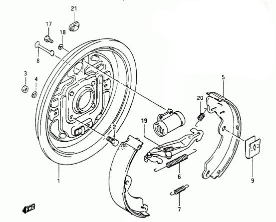

Post by Darrell » Tue Feb 19, 2013 9:03 pm
The cylinders on my 413 are different IE: one has fluid in/out, the other fluid in/bleed nipple.
Your also going to need a couple of self adjusters (part 19)
Here's a pic of mine
rear brake .jpg (45.65 KiB) Viewed 6945 times

Re: Wheel hub empty
Post by fozzyx123 » Wed Feb 20, 2013 1:50 pm
thank you very much, thats just what i was going to ask for...... ive bought all the bits, just waiting for the cylinder to arrive then i can start assemblty.,..that diagram will make my life a lot easier, much obliged

Re: Wheel hub empty
Post by fozzyx123 » Wed Feb 20, 2013 1:56 pm
ok so ive just opened all the boxed.....and im still missing a piece :*-(
what is number 19 in the diagram please?

Re: Wheel hub empty
Post by fozzyx123 » Wed Feb 20, 2013 1:59 pm
ok....just re - read your post.... self adjusters...lol
are these again specific to the model?
it's just a n/s i need as the o/s is in tact... does anyone happen to have one?

Re: Wheel hub empty
Post by fozzyx123 » Fri Feb 22, 2013 3:02 pm
would you happen to have the nuts & bolts needed for the brake cylinder and shoes?

Re: Wheel hub empty
Post by fozzyx123 » Thu Mar 07, 2013 3:14 pm
what are parts numbered 8 & 21 on the diagram plz and where can i get them?

Re: Wheel hub empty
Post by ScottieJ » Thu Mar 07, 2013 3:41 pm
21 is just a rubber bung to fill in a hole in the backing plate to stop crap getting in.
8 goes through the backing plate, then through the shoe and is held in by the number 9 clip.
