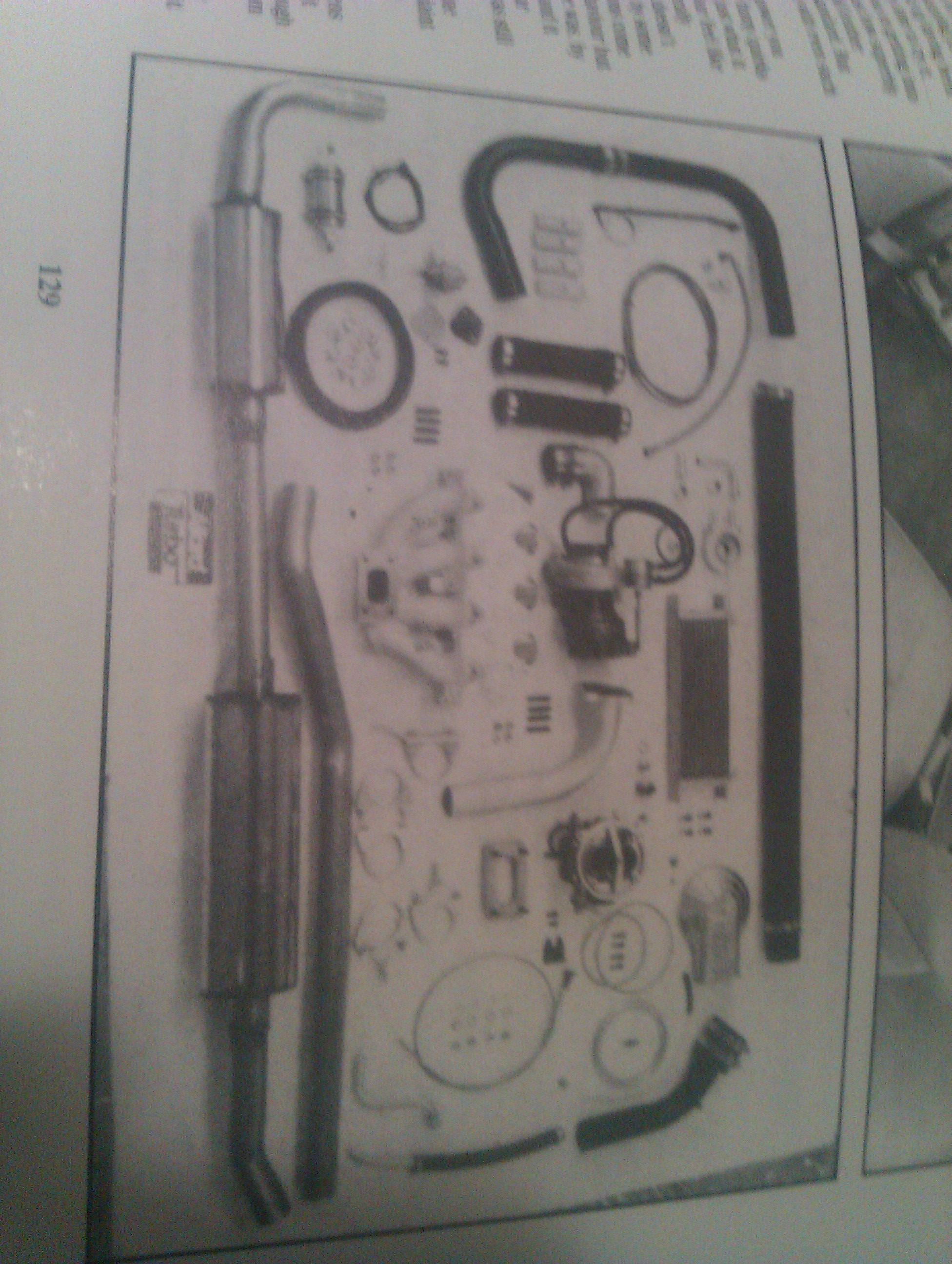

Allard definatley did a turbo conversion for both the 410 & the 413..... I think it used the janspeed exhaust

Allard turbo kit for the 413.... the kit isnt labelled but it uses the downdraft weber carb and doesn't have an inlet manifold to convert the 410s from side draft
Allard turbo kit
Allard turbo kit
Sorry for the poor pic, it was a photo of page 129 from the 'suzuki gold portfolio'
:thumbup:
