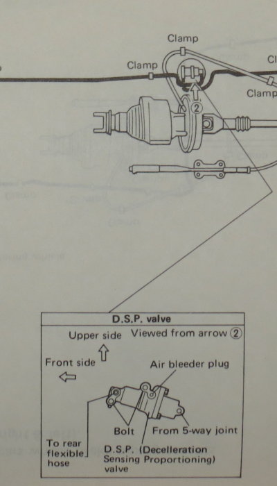

Re: Brakes seizing on help.
Fitted to the LWB only ??
- dsp.jpg (50.65 KiB) Viewed 6389 times

So the thing up front is the portioning valve and the one at the rear is the DSP valve. My SWB 410 has one.
The manual shows the 410 fitted with a load sensing valve. (early models)
dsp valve (later models)
I'm only going by the book, and we know what Suzuki are like
Ye my sj has a dsp valve aswell
I.was wondering what that thing was tbh
Oh, right, might be a load sensing valve on the back of mine then, but there's definately something in the brake line on the chassis/

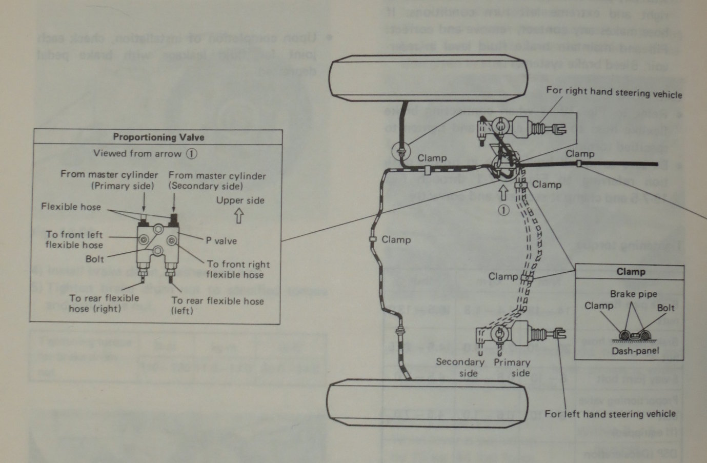

Looking in the Sammi manual.
- Diagram.jpg (119.53 KiB) Viewed 6375 times
- P&B.jpg (56.94 KiB) Viewed 6375 times
- 6 Way Joint.jpg (37.36 KiB) Viewed 6375 times
Thats the Sammy.
Ant said his was the same as mine.
Ahhh, that explains my confusion.
