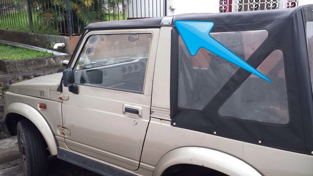

You also asked about soft tops coming off, yours defiantly will, but not whilst
This plate is fitted, I don't know why someone would add a plate here? But with this removed your roof should be detachable,

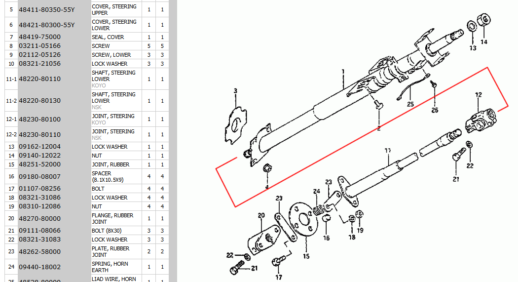

I would also check the steering shaft UJ (part 12) and rag joint (part 15) condition before buying anything.
Steering box adjustment http://forum.suzukiclubuk.co.uk/vi ... =15&t=3310
I would also check the ball joints on the pitman arm to make sure they are OK.

I'd recommend tightening the steering box like in the above guide, it's easy to do and its amazing the difference it can make!
