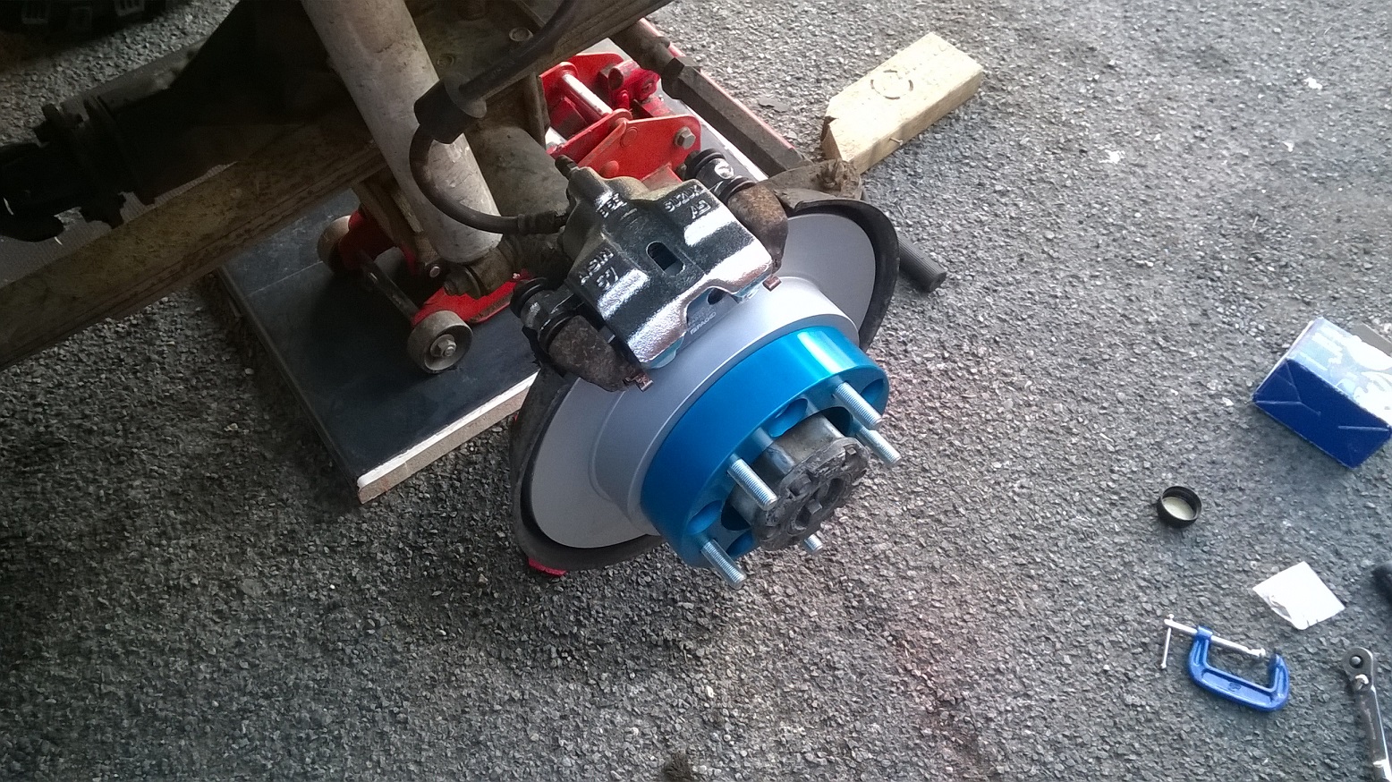

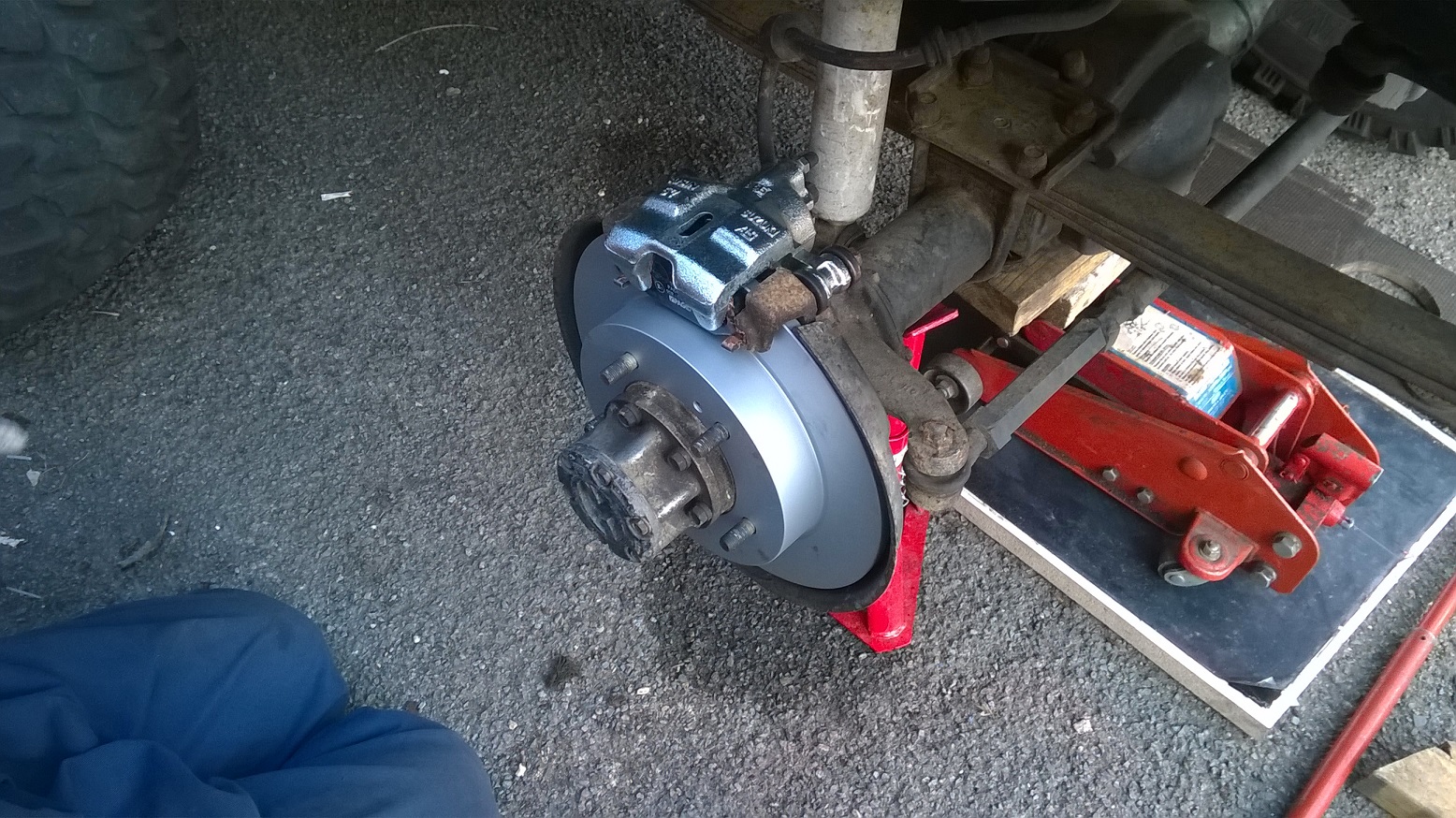

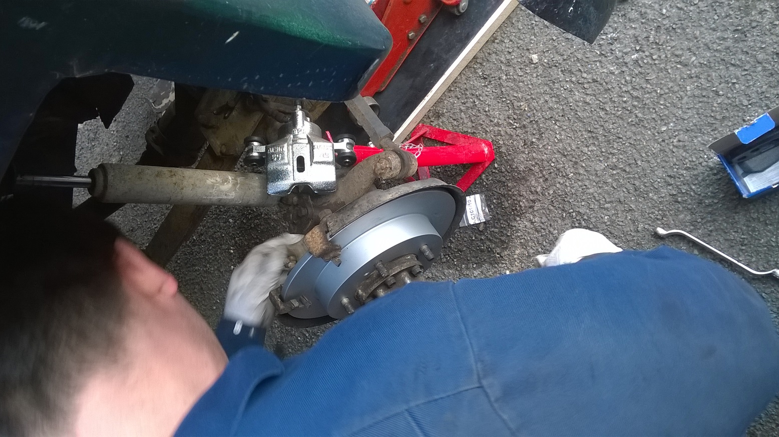

The knee is a minor inconvenience now my back has joined in the fun and games. Back to the docs on monday...it's so painful I can barely stand up. But Piglet6 got her brakes sorted and all seemed fine but they have gone all spongy now. Maybe it's because I haven't done the master cylinder yet? Time will tell..the new spacers went on the front only to discover the rear already has them to balance the axle widths. So they are going on the Vitara after the virtual lift is finished.

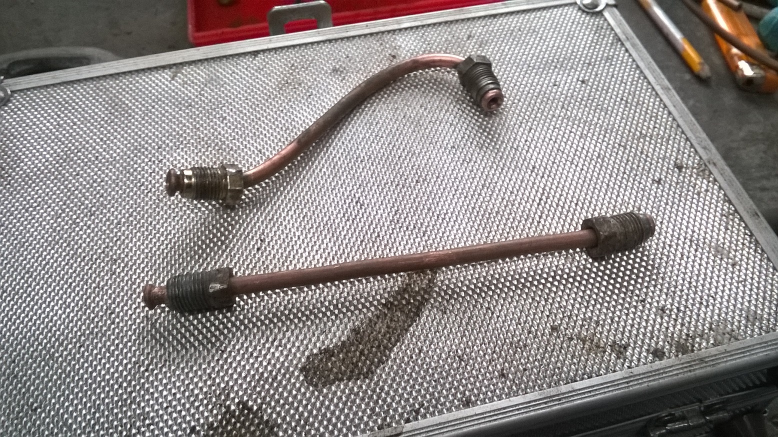

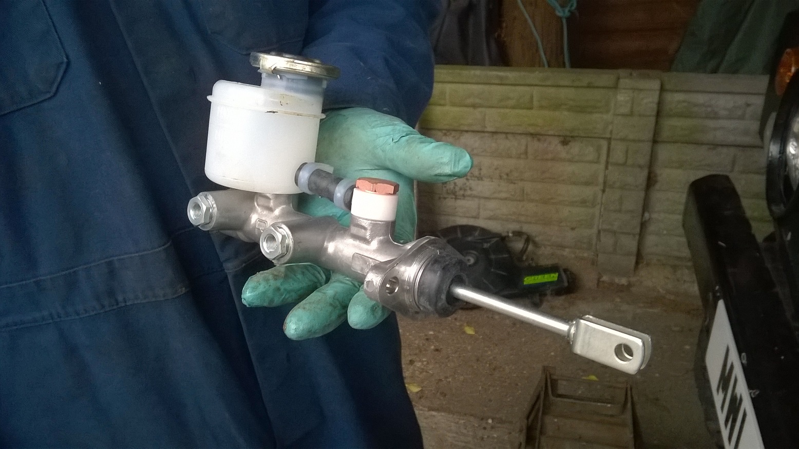

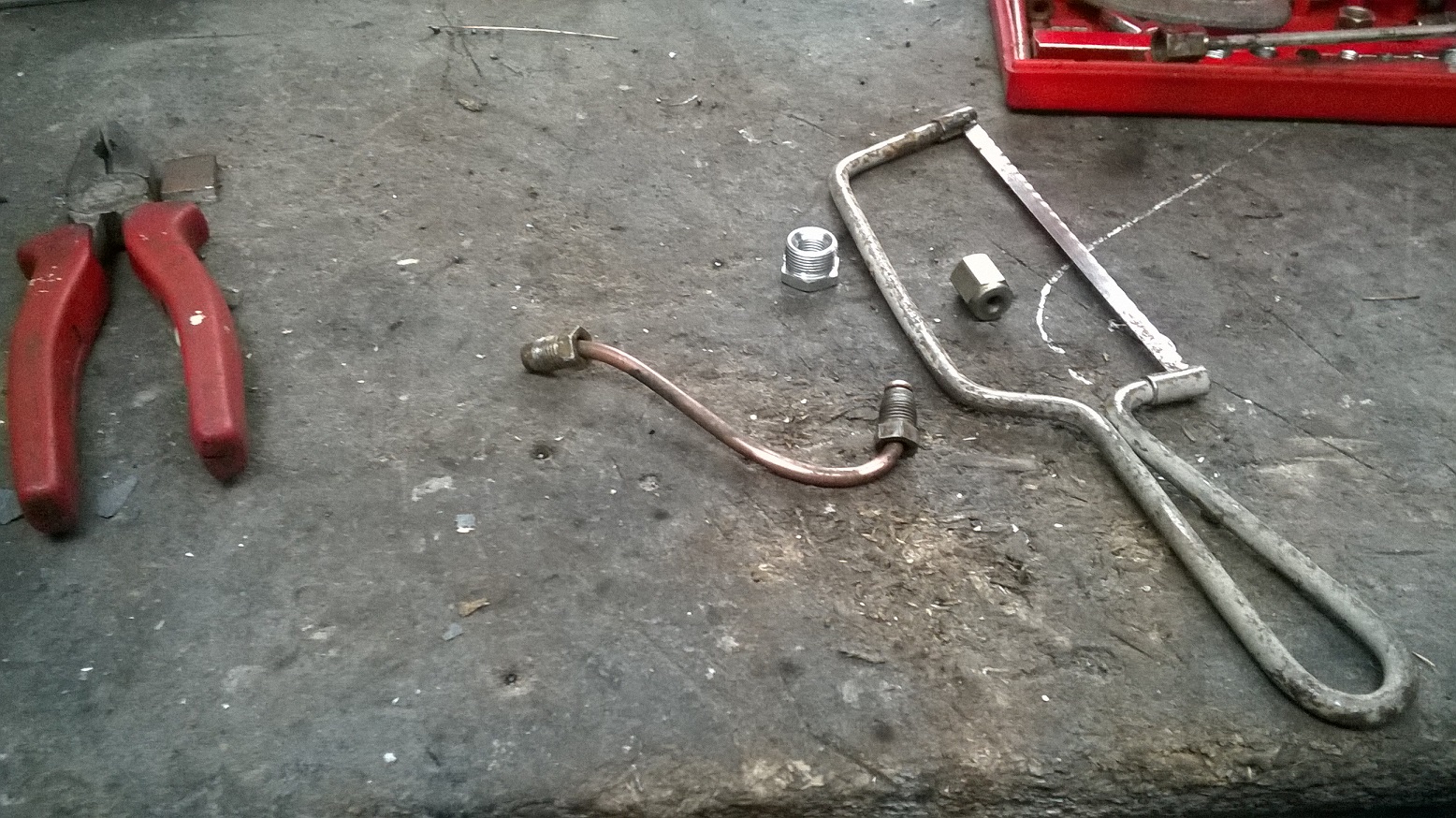

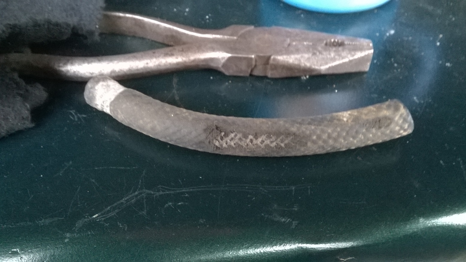

New master cylinder in and the brakes all bled, a new copper pipe needed making up and that fuel line is shagged! Still not right..I suspect the load proportion valve but the bleed nipples are knackered so I'm looking for a new one. No luck so far.
