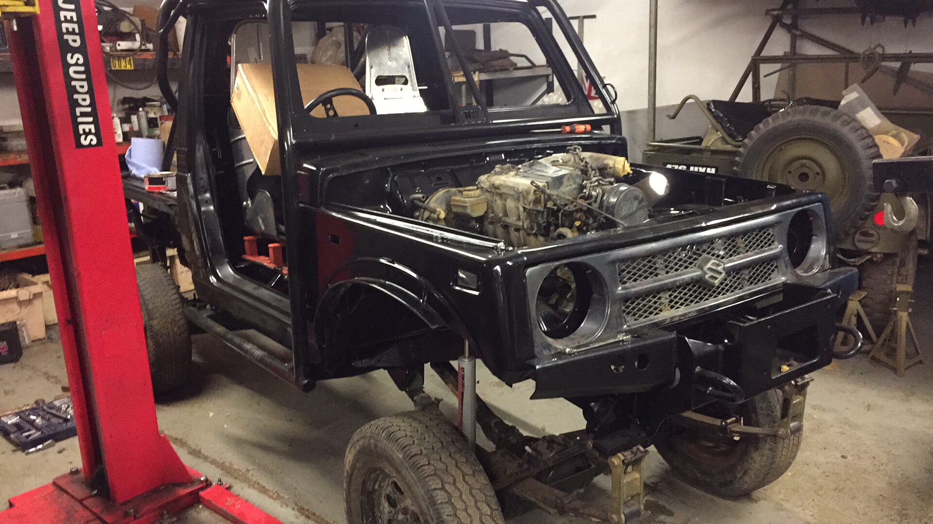

Post by mike harris » Wed Nov 18, 2015 8:40 pm
Bits bolted on
Engines in
Gearbox in
Tbox in
Shocks on
Dash bar and pedals in
