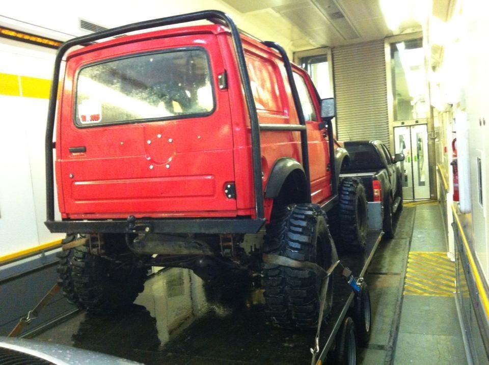

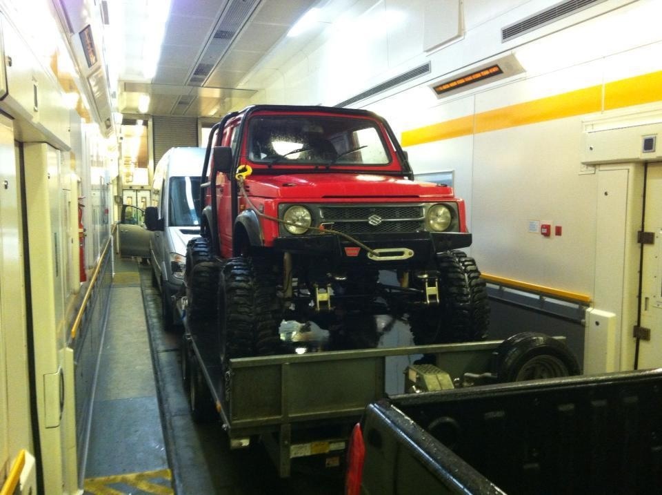

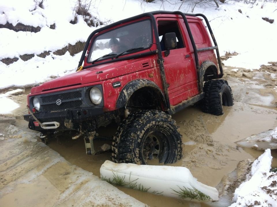

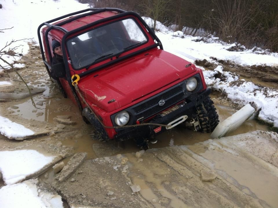

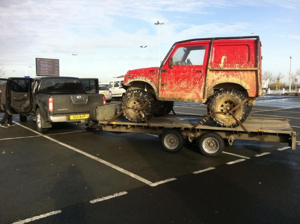

I only took a couple of ice, wasn't there long !!
