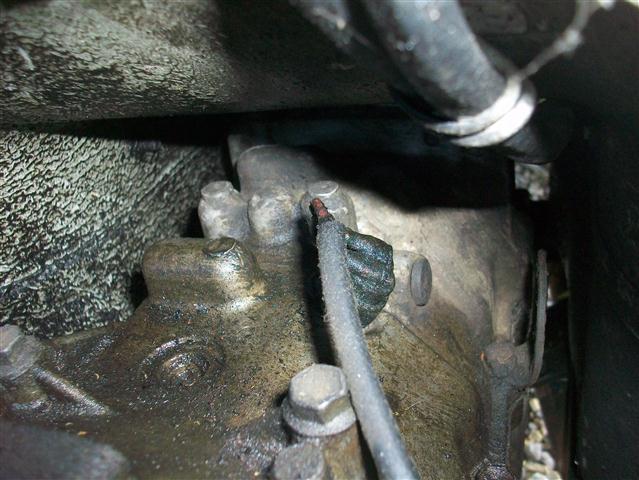

Pictures of the wiring for you. Hope they are of some use. Shows where the wiring goes to for the reversing light.
Wouldn't trust it from my SJ as I'm still finding parts that are fucked/bodged/broken from previous owners.
Red arrows shows where the reversing light wires on my SJ run.
Hopefully gives you an idea of where to look for the wires for your reversing light.
Top of the Gearbox.JPG (75.01 KiB) Viewed 8603 times
Gear box Wires.JPG (130.35 KiB) Viewed 8603 times
