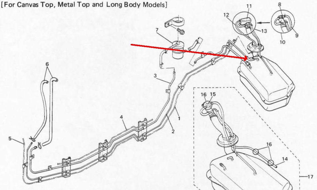

Was it this hose you replaced....
The small hose you changed wasn't the fuel return pipe was it
- fuel.JPG (93.86 KiB) Viewed 7571 times
Re: Changed the fuel pump but theres something wrong
i changed both, both were perished and i replaced them with new piping, but yes that arrowed on is the one that was leaking, dont know why though its not connected up front.

Smalljeep wrote:i changed both, both were perished and i replaced them with new piping, but yes that arrowed on is the one that was leaking, dont know why though its not connected up front.
Should no longer be any pressure on the return pipe, so don't know why it was leaking
