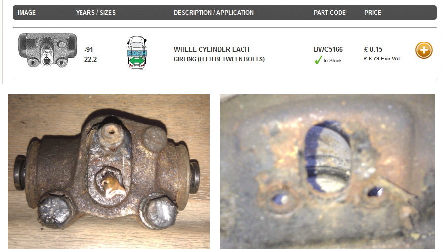

This is my passenger side cylinder
Plus I can only fit these cylinders on my rear axle as these holes here are different one is round and one is oval

Re: i need help with brake shoes and cylinders on 410
Take the shoe's n bits down your local motor factors and get them to match you up some new bits is your easiest bet.
Dont get them to search for parts using the registration as theyll get you the wrong bits.
I tried Kevin coopers or motor parts direct and there prices was way high compared to eBay but that was for jap brakes but I want Spanish
I I.might go up there again with the part number that darrell has and see what they have

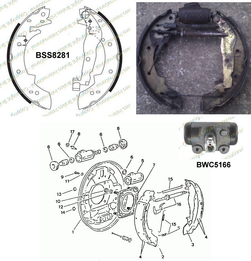

- BSS8281.jpg (137.75 KiB) Viewed 5170 times
Your gonna hate me if anything is wrong
Yes buy 2 cylinders
The shoes come as a set of 4
Yes buy 2 cylinders
