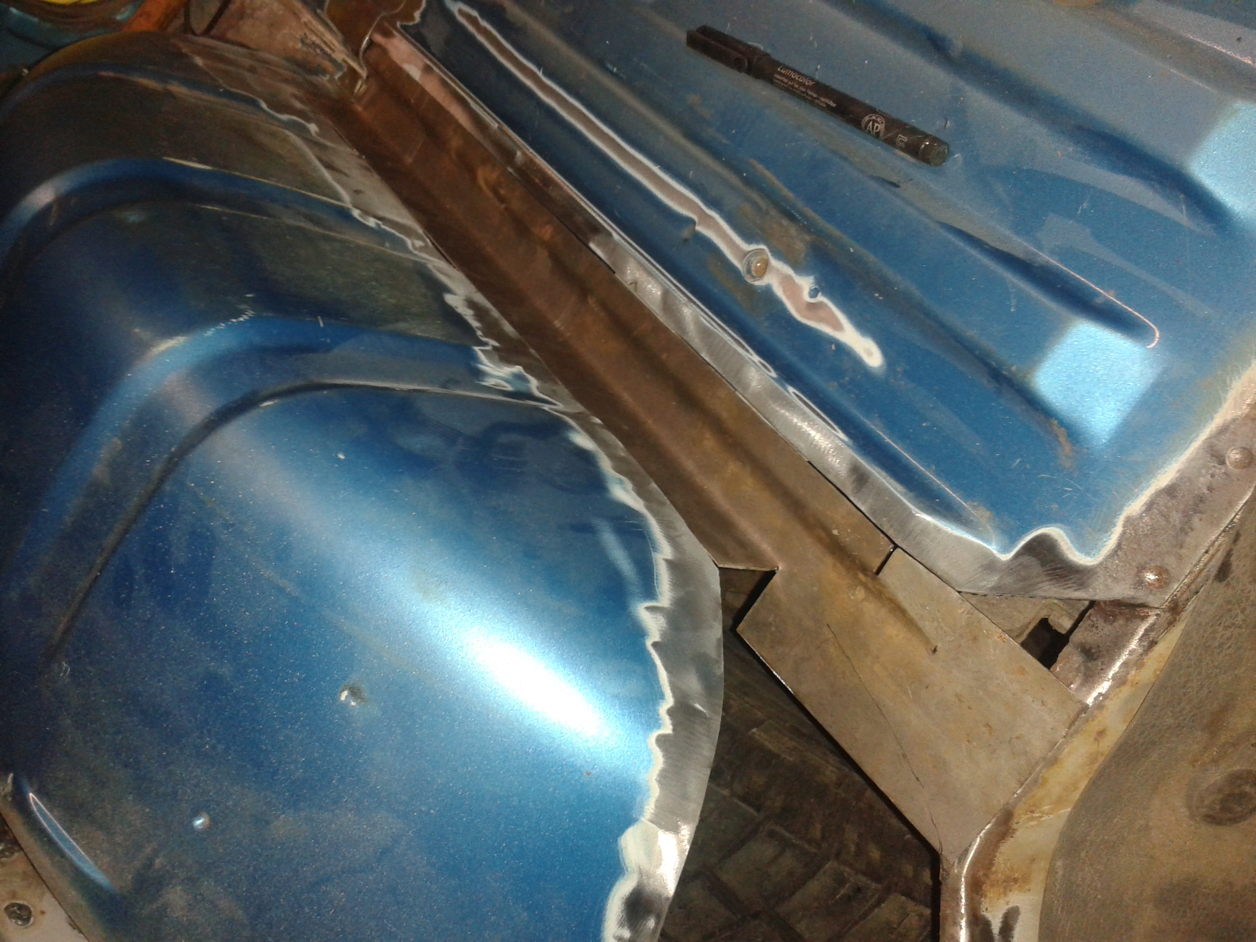

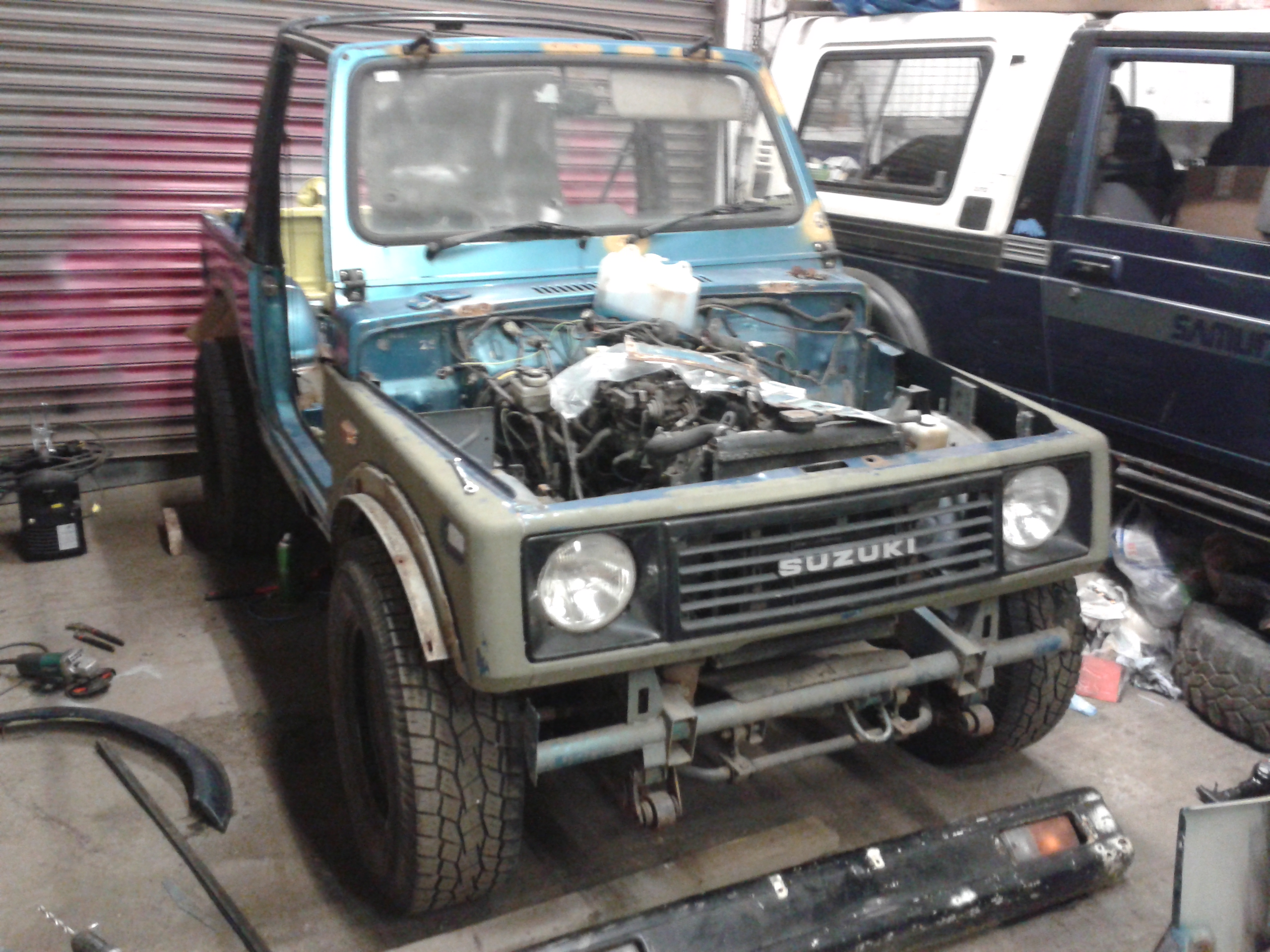

Mig arrived. Its like welding with butter. Love it

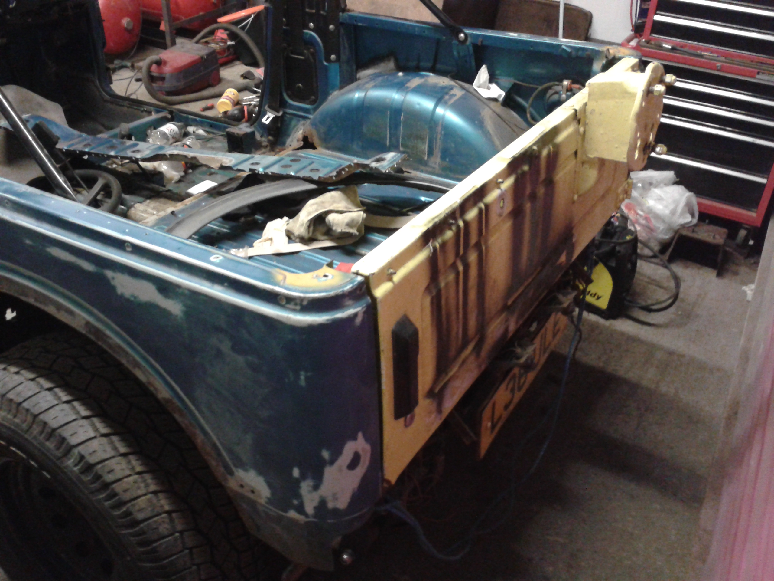

Done a wheel arch repair to test it out. Used the old front wing
As a doner for the patch. New front end shoved on to. Also

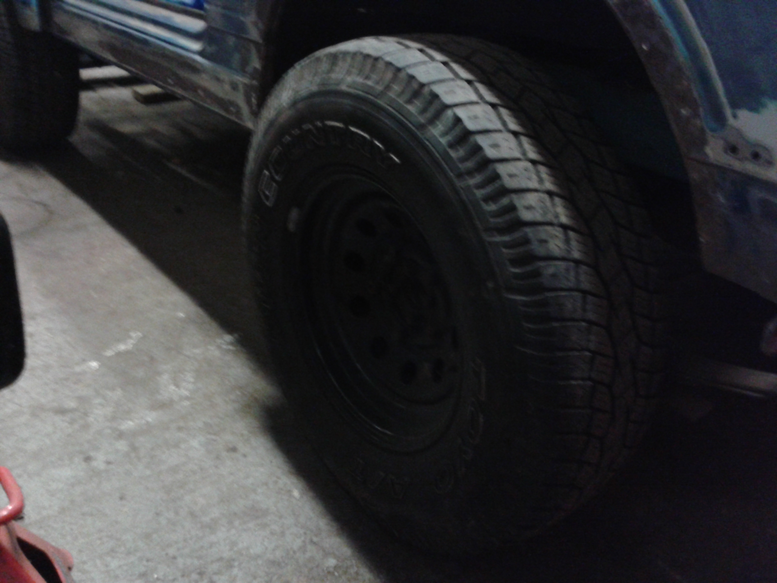

Stuck a straighter tailgate on. Started to mod the door hinges aswell
30 9.5 15 boots on some modular wheels also

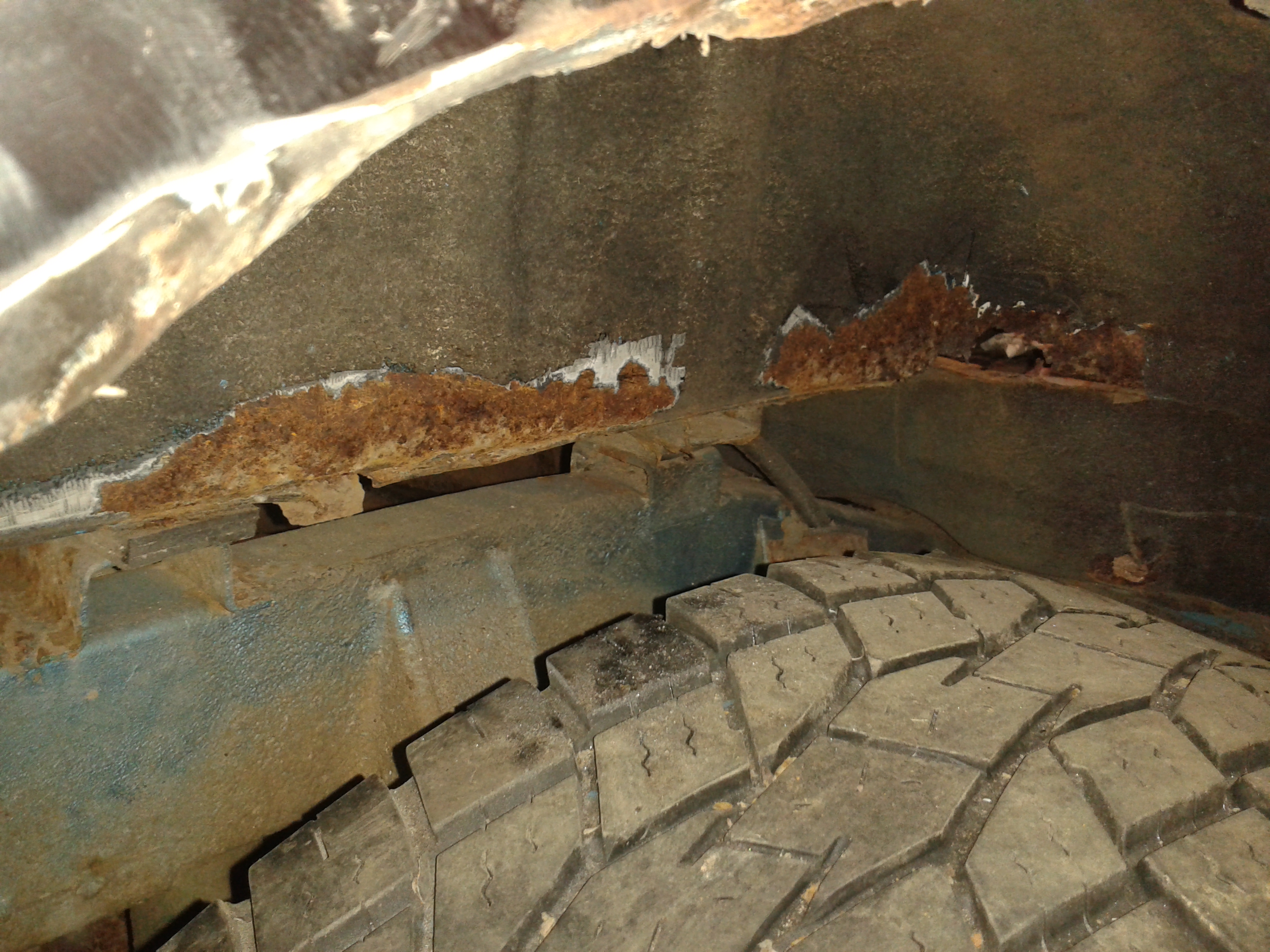

Dam it!
Did the Spanish use salt as underseal?!!!!!!

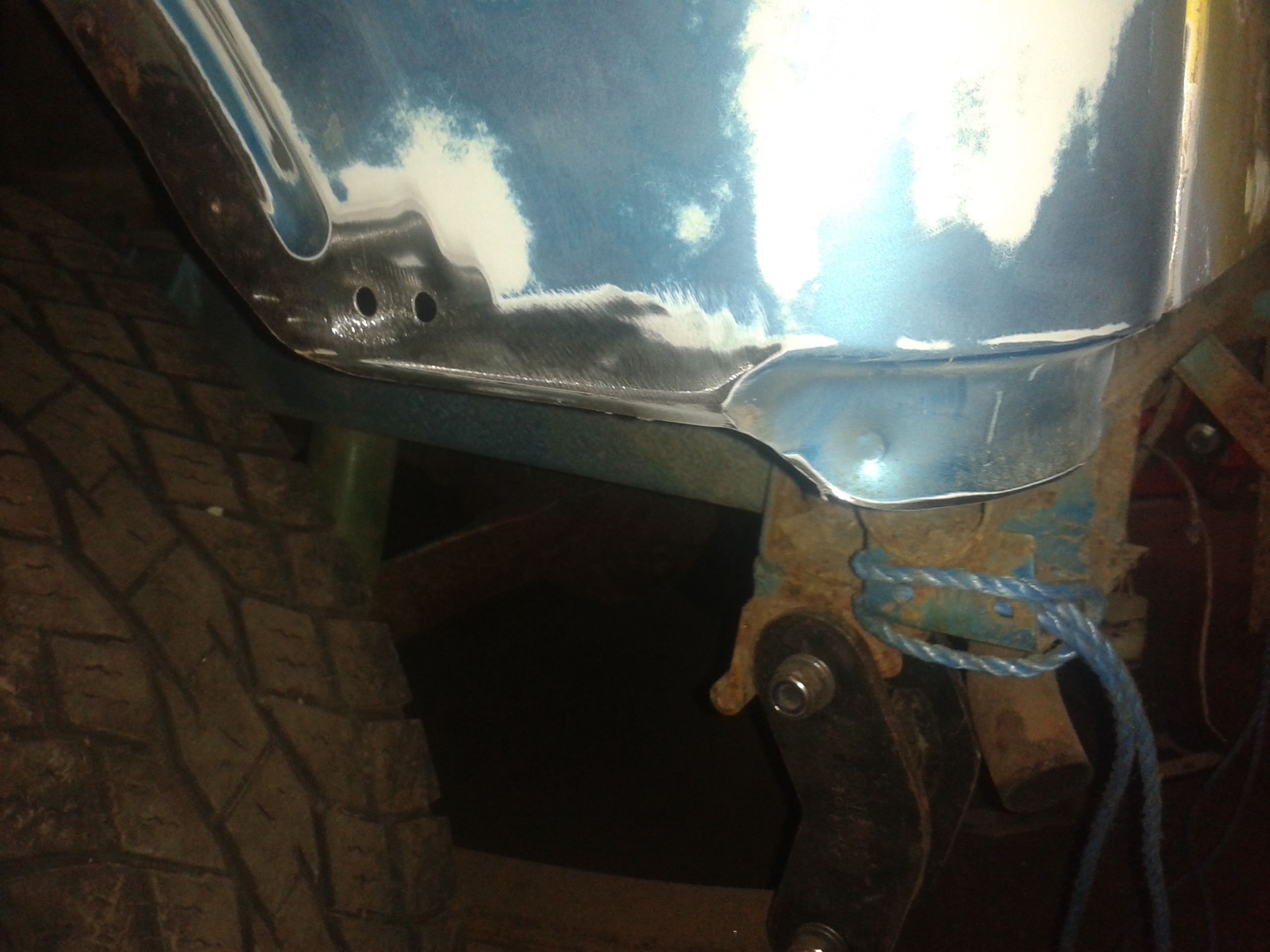

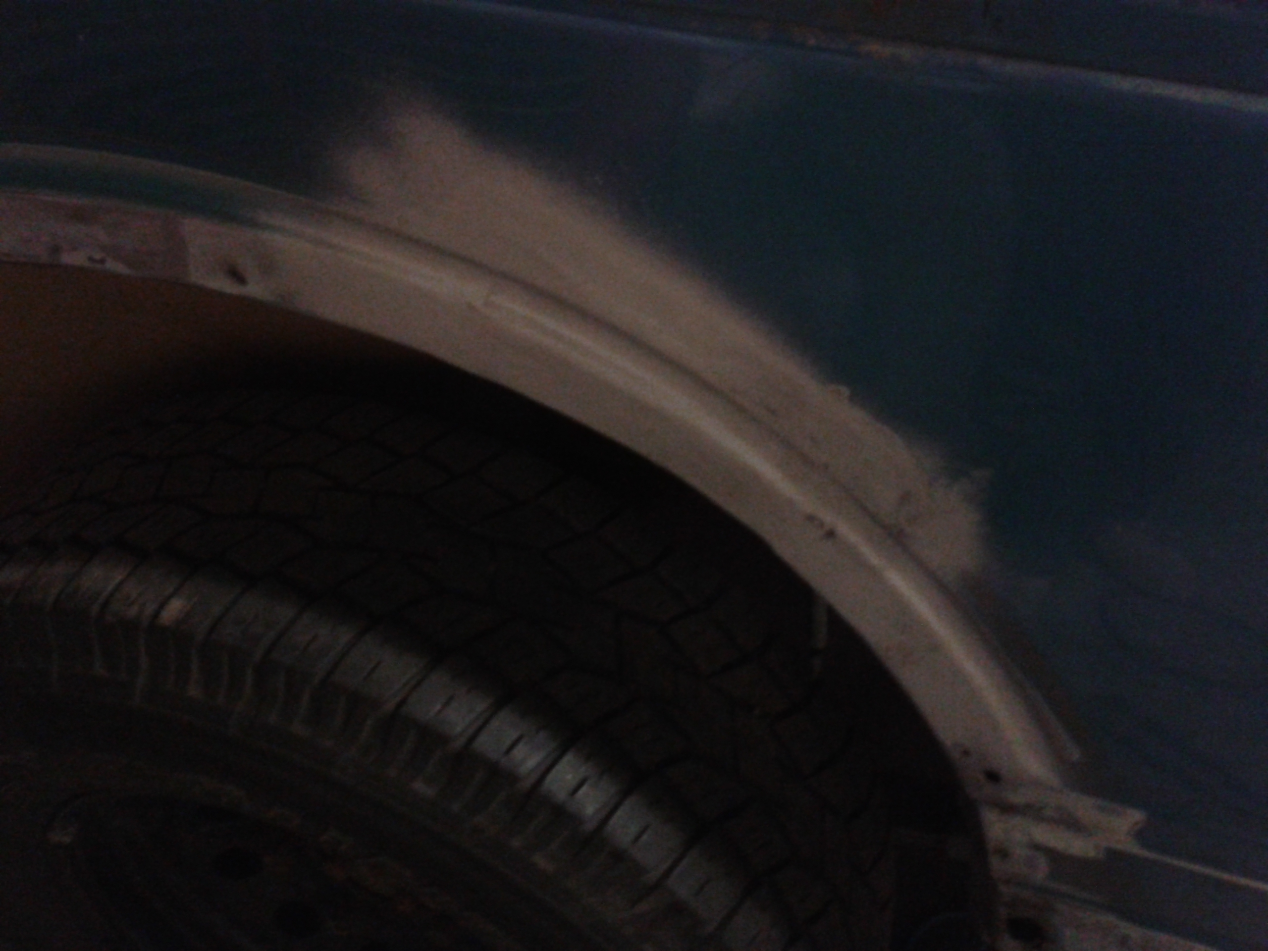

Re: The bitsa zuk
Post by andyrew » Fri Apr 04, 2014 8:23 am
So
Fuel tank had been removed for welding purposes
Looks like its a new pattern part. Said "made in Canada"
And would have bare metal when fitted so its covered in
Surface rust. A good sand and some red oxide was then applied.
Tacked and smoothed out the extra holes tgat had been
Drilled in the rear and pluged up the indentations from
Where I drilled off the spot welds on the wheel arch trims.
Bumper gap panel was rusting on one side as was the mud
Flap brackets so these have been trimmed away too. Ill fab
Some different flap brackets at some point.

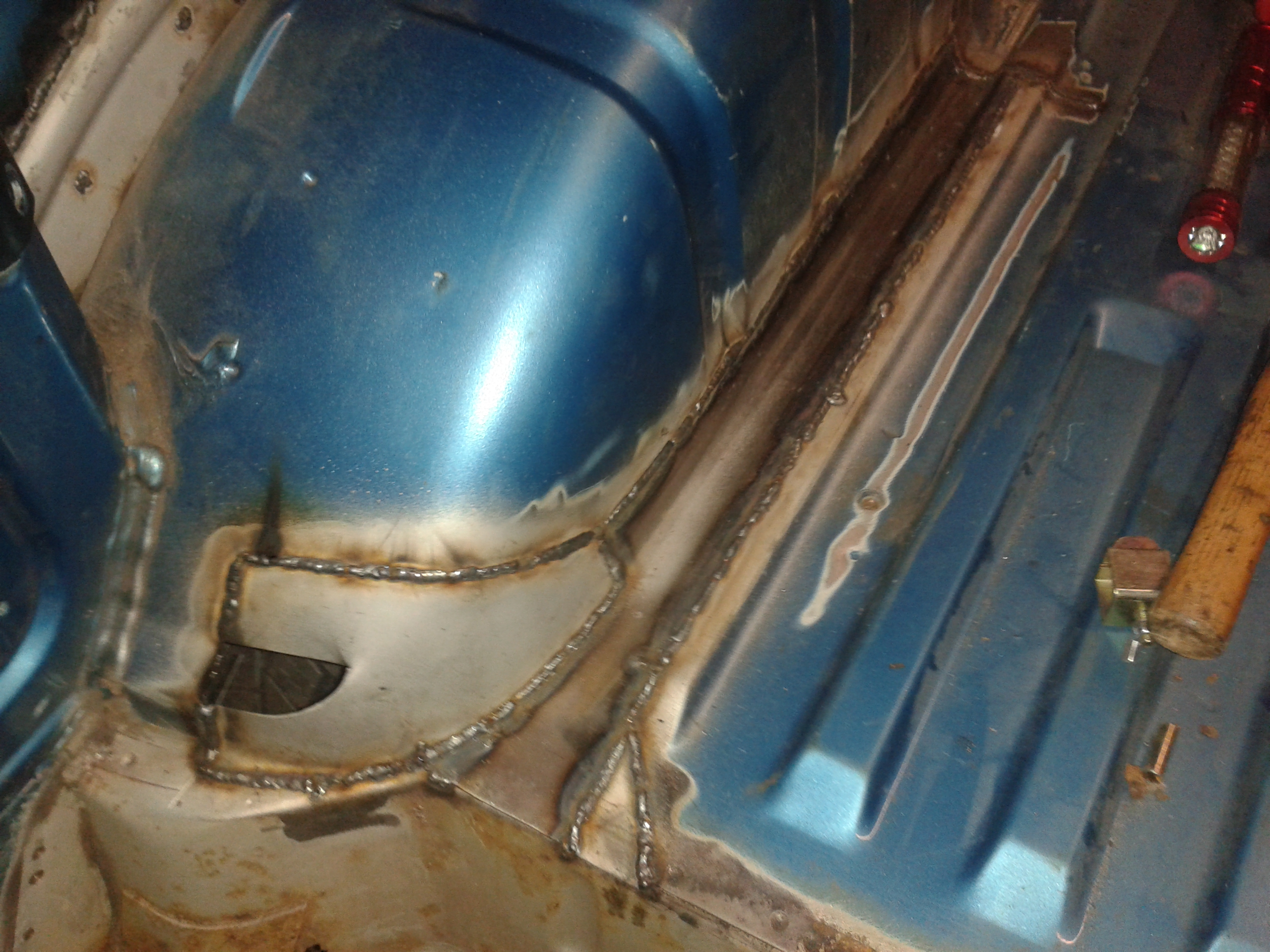

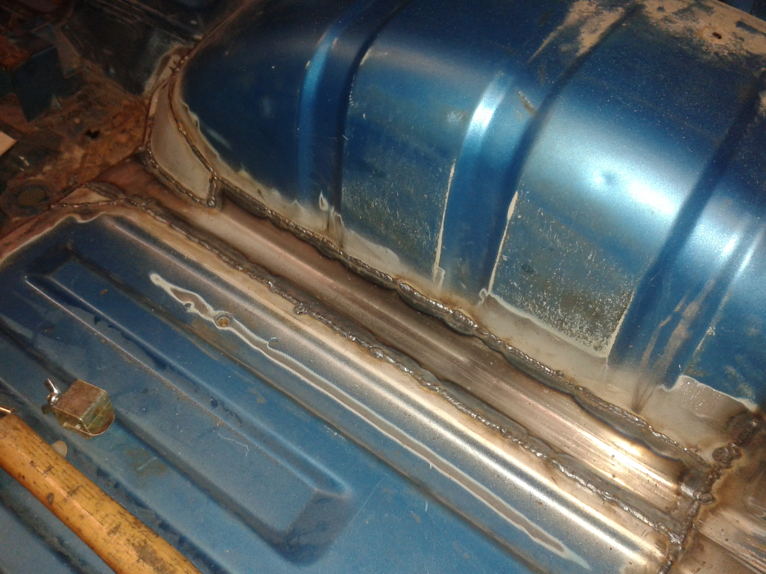

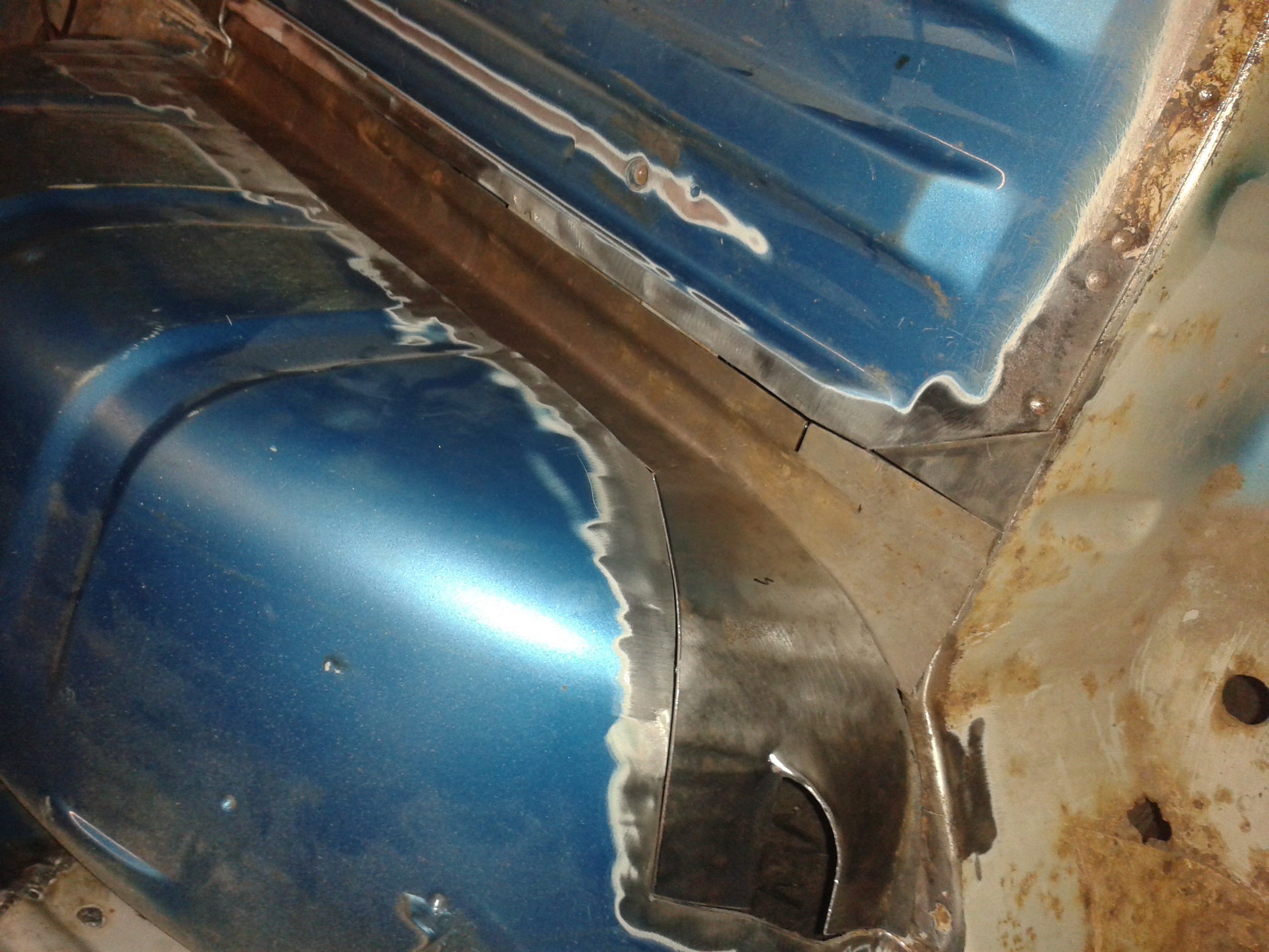

Anyway rot chopped out new panels fabbed and Buzzed in
Re: The bitsa zuk
Post by andyrew » Sat Apr 05, 2014 10:55 pm
Nice and solid
Posts: 11705
Re: The bitsa zuk
Post by ScottieJ » Sun Apr 06, 2014 12:03 am
Tidy work! :thumbup:
