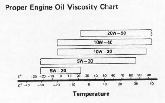

It says under the bonnet on a sticker, in England we use 10w40, I'm sure Darrell will post a viscosity chart in a minute, I'd have thought it would be the same for .
Re: Bought a very old Suzuki Samurai - In need of some help!
I would say 10w/40 should be fine
- chart.png (115.94 KiB) Viewed 7748 times

Take it back and tell him he was wrong, a 20W-50 isn't really suitable.

Remember jmods is in the Seychelles, not cold and damp Blighty, so he won't have any cold start concerns.Rhinoman wrote:Take it back and tell him he was wrong, a 20W-50 isn't really suitable.

Well going by the chart I would say that oil is suitable given your climate. http://www.visualitineraries.com/articl ... helles.asp
As regards the level just add oil, leave 30 seconds and recheck level, repeat until oil level is at the F mark.
We don't generally use that oil over here because in the winter we can regularly be below freezing.
