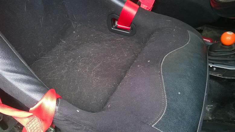

Sit rep, Scottie was right after all. I took off everything I could think of and it was all fine. Felt behind the carb and felt a bit of a blow but thought that was just the fan. Removed fan and got a mate to blip the throttle and AHA! There is a sodding bolt missing out of the back of the carb! So, new bolt in and she runs as normal. She was parked up at my garage with the doors off for about 3 weeks and the local cats have used her as a hotel...I have managed to get the fur off the seats!

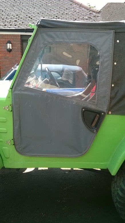

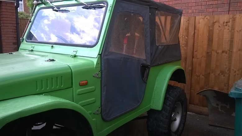

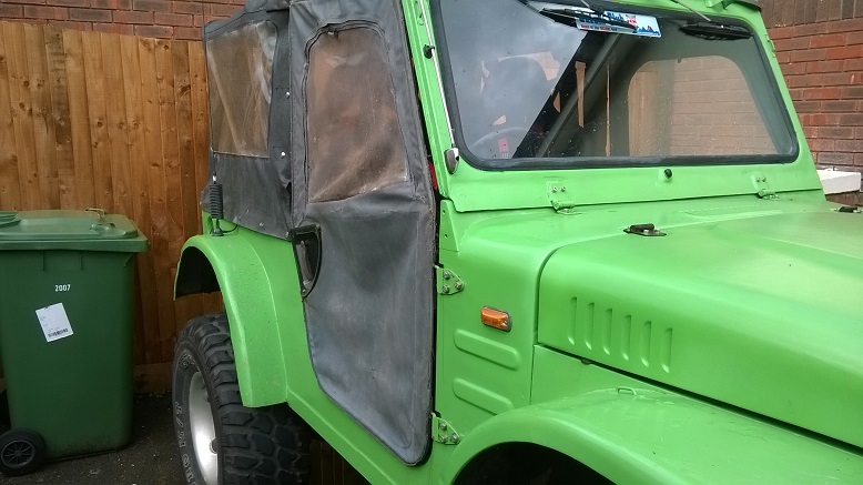

Still trying to get the canvas doors to fit properly, passenger side is as snug as a bug but drivers door still has vast gaps, tried to heat it and bend the locating pins in but I'm still out by maybe 20mm.

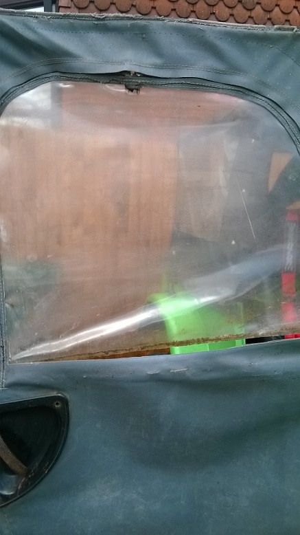

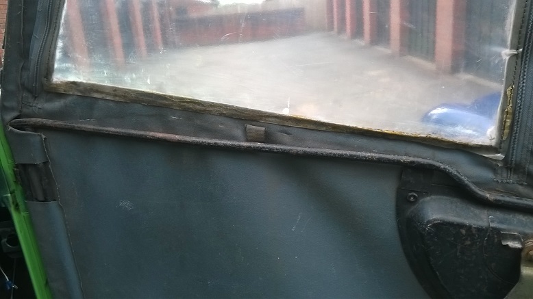

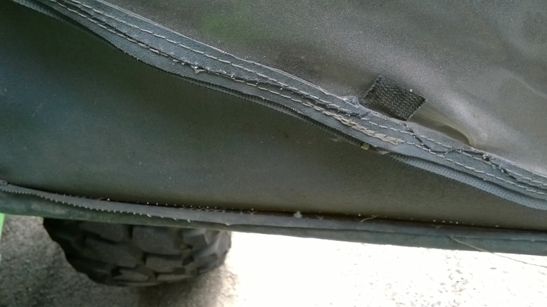

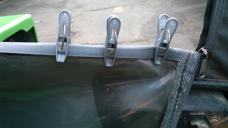

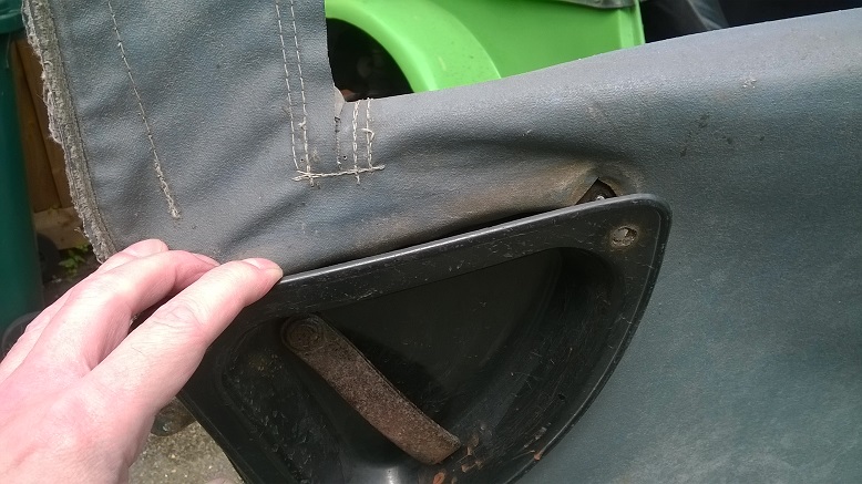

Had another go at the doors tonight. Passenger side looks like it's been restored in the past and the perspex window cleaned up a treat. Driver's side is poor though, I managed to glue the window back to the door and that bit cleaned up ok, next step is fix the stitching and figure out how to get 2 sheared bolts out of the door latch...
