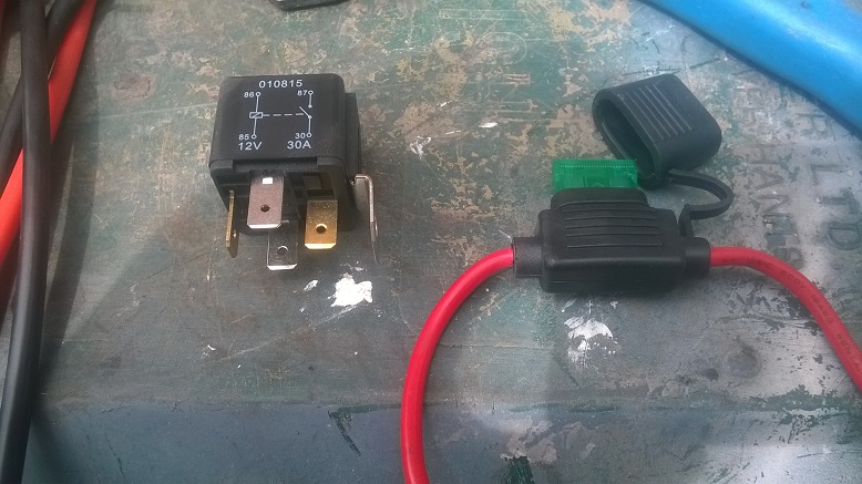

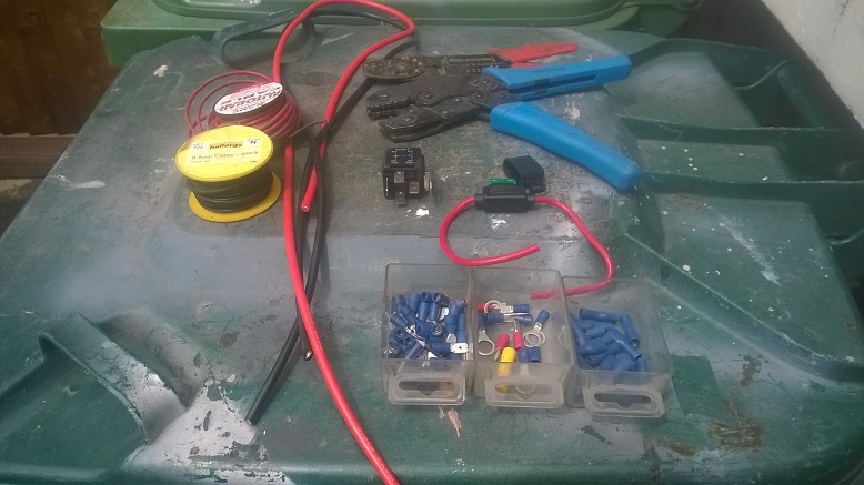

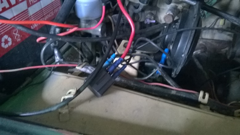

Installed the relay today. To say my electrical skills are poor is an understatement. No idea what all the little icons mean at all but Sherwood's link did make it all very simple. A 30amp relay, inline fuse (30amp) and holder. Some wires and connectors. And a decent wire crimper helps too.
Disconnect battery!
Take off the igntion wire from the starter (female) and connect to #86 on the relay.
Make a wire with female connectors on each end, attatch one to the starter (the wire that just came off) and the other end goes to #87.
#85 is the earth wire. I put on an eyelet and earthed it to the horn mount.
#30 is the wire that goes to the + battery terminal with the inline fuse holder.
And that's it.
Cheers lads!
(yes I will mount the relay somewhere I just wanted to make sure it worked!)
Disconnect battery!
And that's it.
Cheers lads!

Did it help, mate?
- donkeychomp
- Posts: 3582
- Location: Shepperton, Middx
Re: the no dosh LJ revamp
Oh yes. No clicks. Starts first turn of the key!
