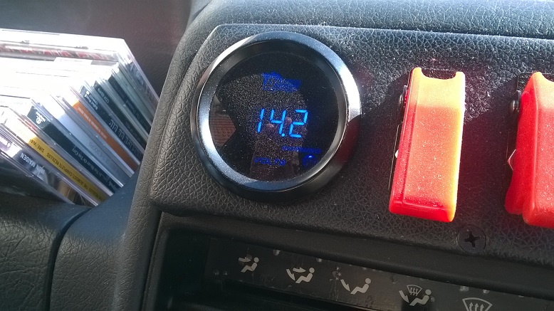

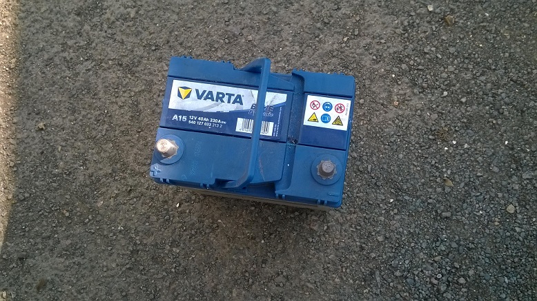

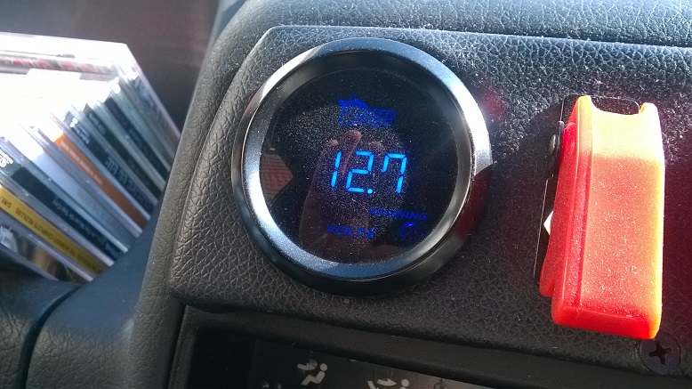

Post by donkeychomp » Wed Sep 14, 2016 9:10 pm

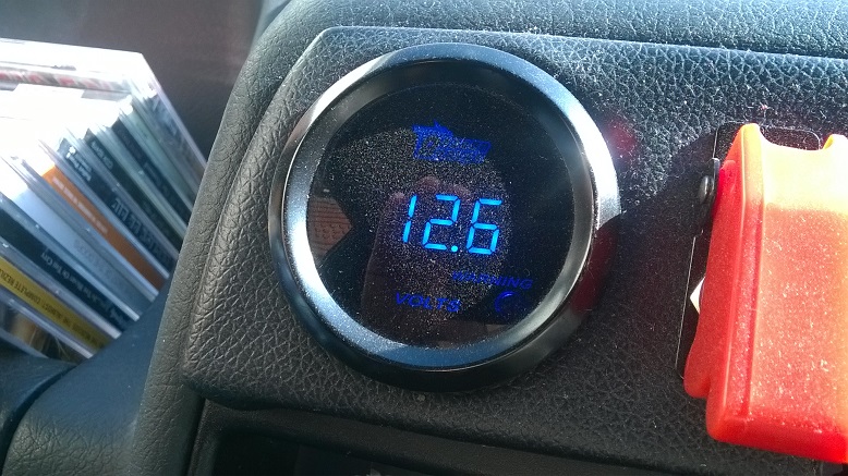

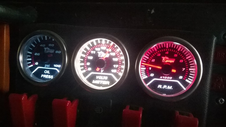

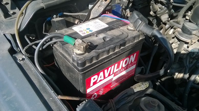

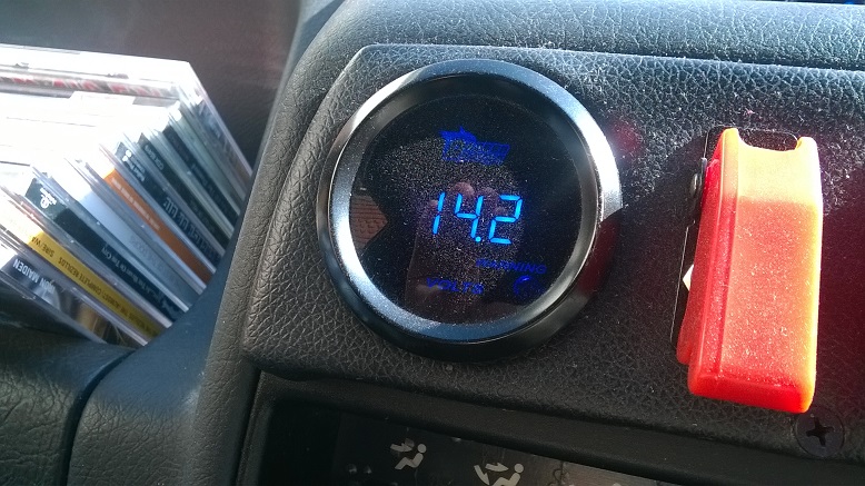

So...I took the battery out of the LJ and tried it in the Vitara. Same volts when ignition is turned on, reads the same when the engine is running too (see pics). Means the battery is fine then. So is the starter motor. So is my clicky fix. I am stumped. I'll put the battery back in the LJ tomorrow but I will clean the terminals and add some paper foil too (why not?). If and when it just goes 'click' on me again I'll call out the AA. Sod it.

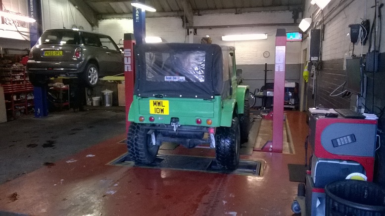

MOT tomorrow...I've done no pre MOT checks and I can't even be sure she'll start to get there but fingers crossed lol
Re: the no dosh LJ revamp

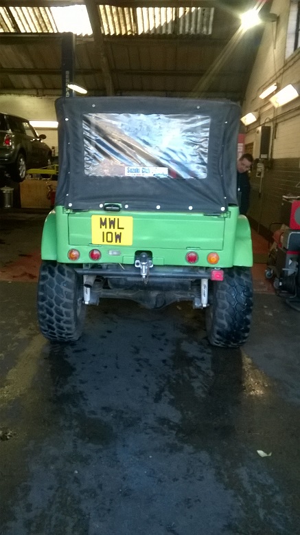

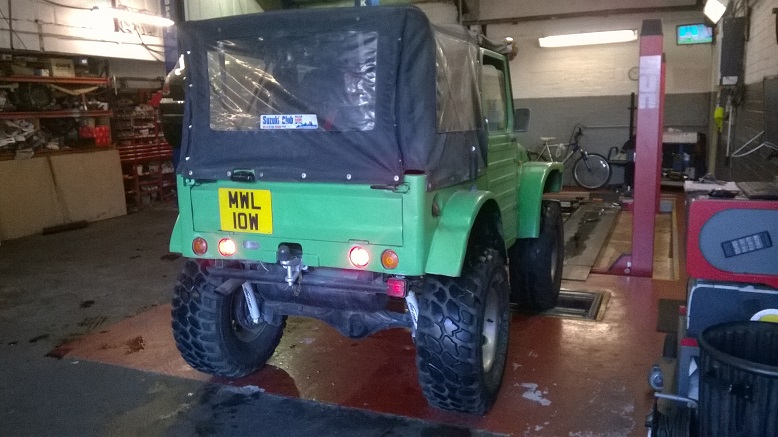

Post by donkeychomp » Wed Nov 09, 2016 9:42 pm
She started...and got there...and passed. Then started again, got me to work. Then started again and got me home!
